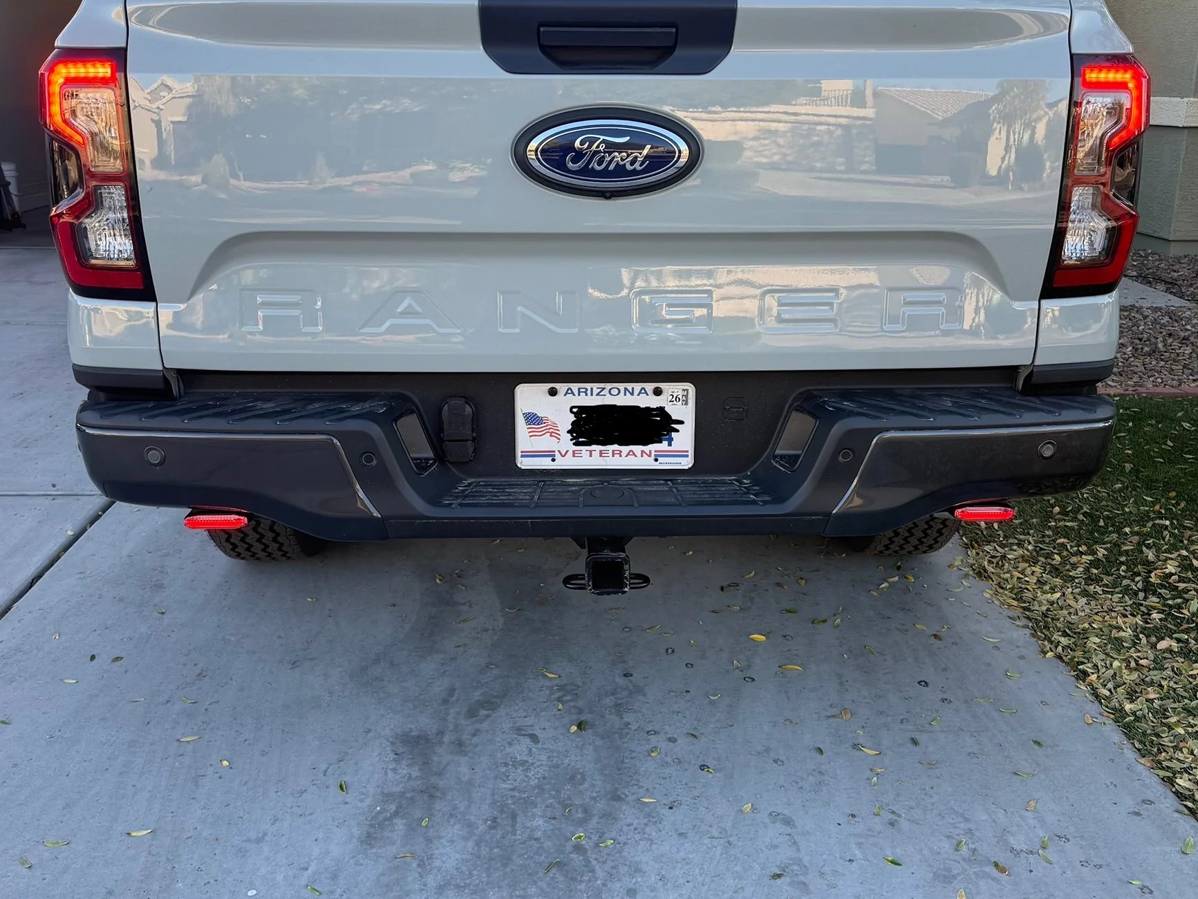

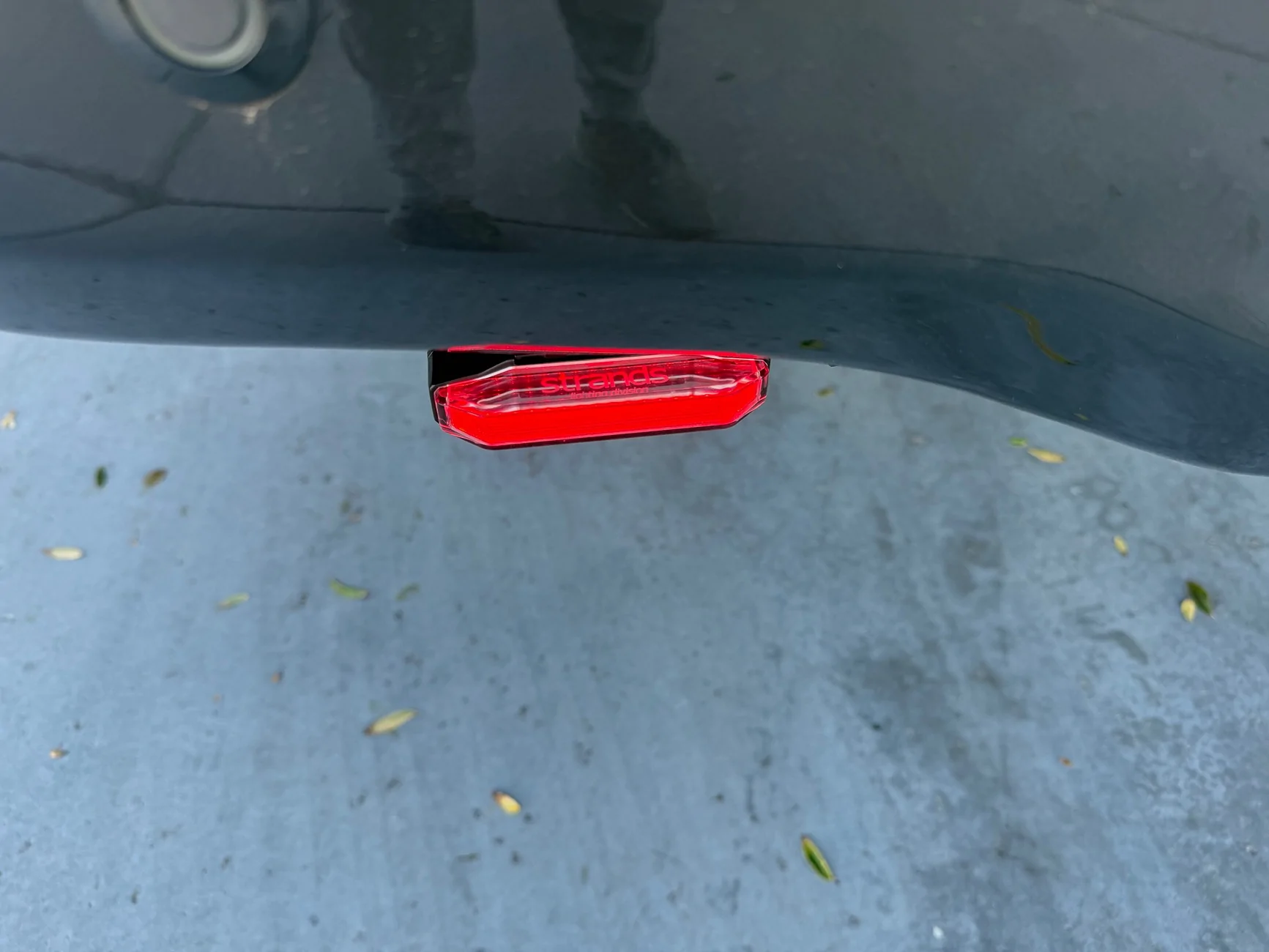

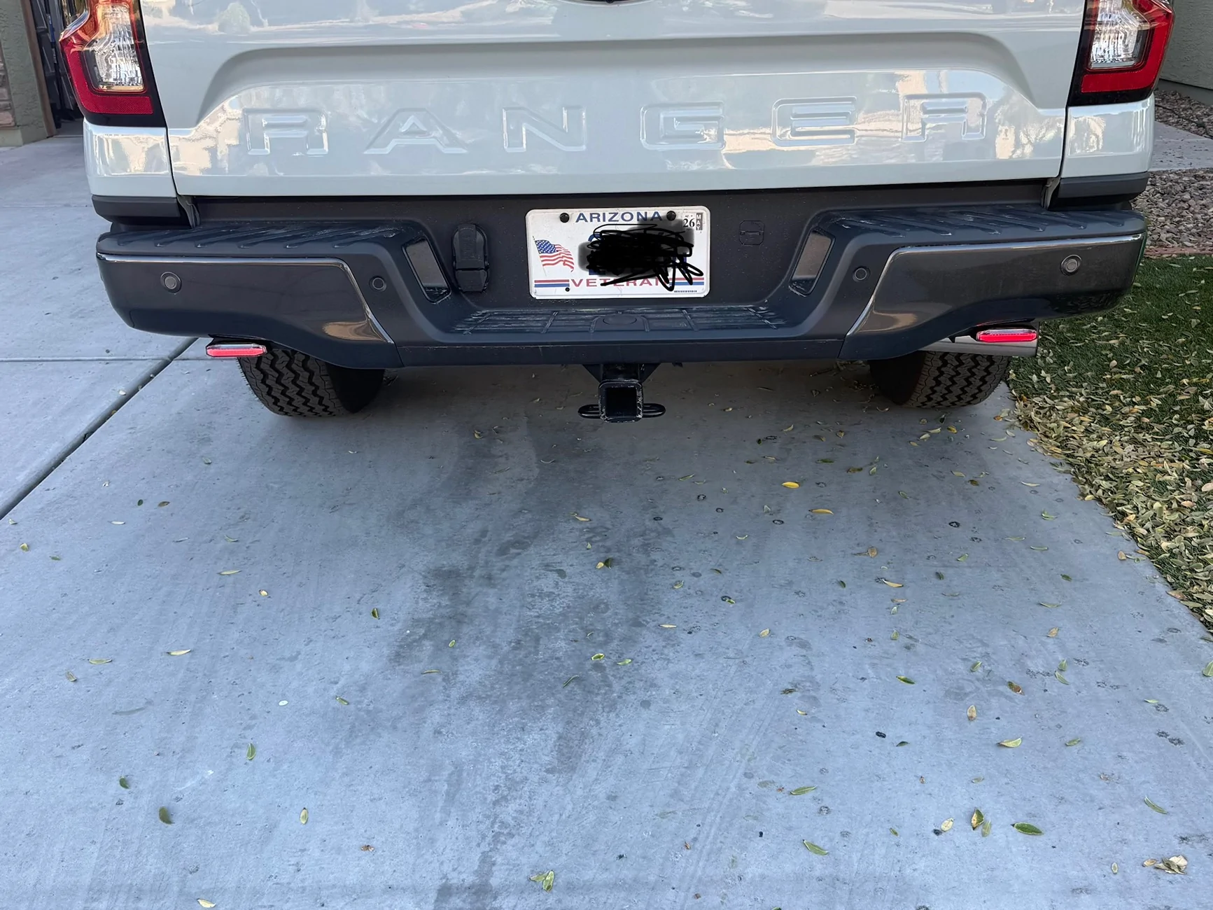

Also, have some Strands a-pillar lights with amber back light.

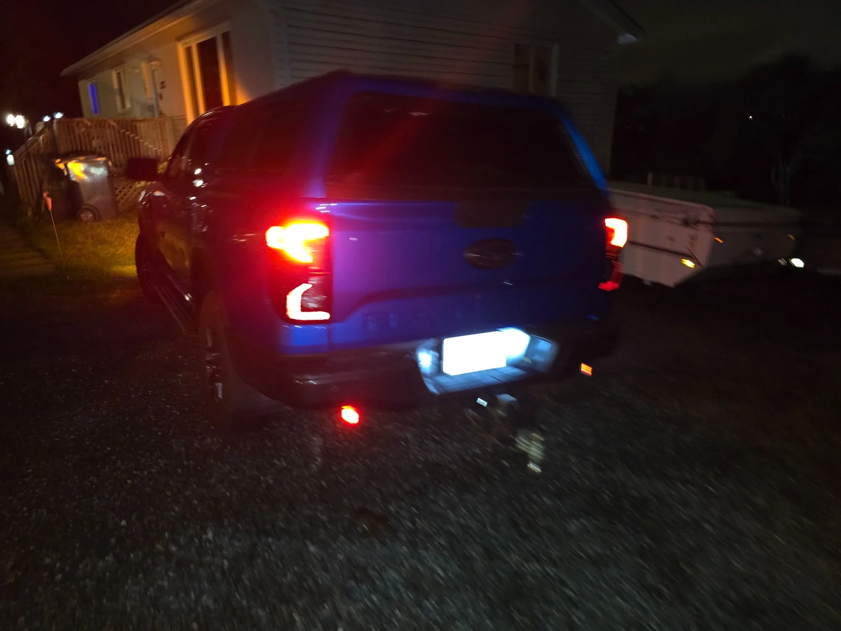

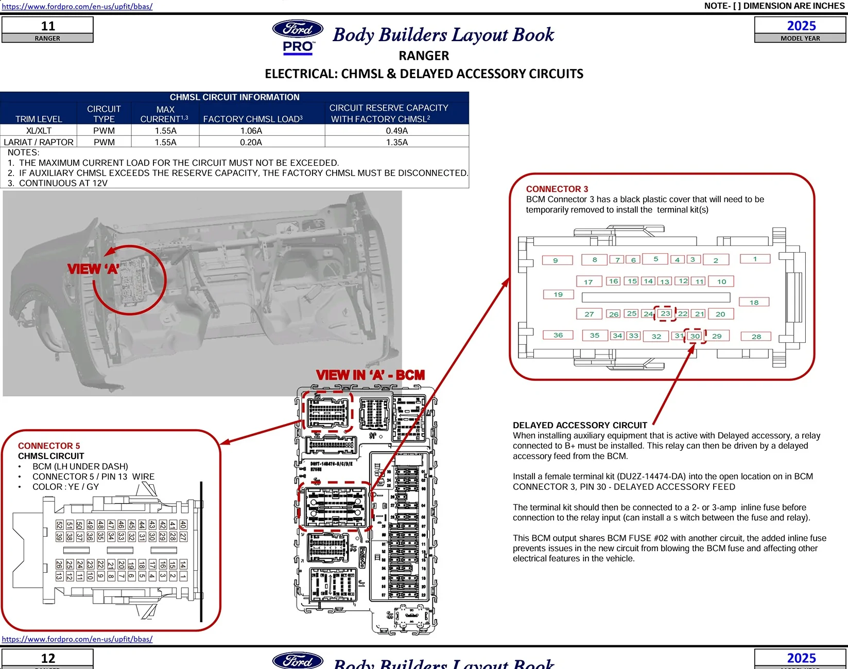

nice. I got diode dynamics ssc1r's on my xlt. had to run a brake wire from the bcm as per the upfitter body builder guide to get rid of the trailer errors. trailer plug still provides my ground, marker, and reverse power tho.
did the raptor have the mounting holes there like I found on my xlt?

Oh I don’t have a raptor, just a lariat.
