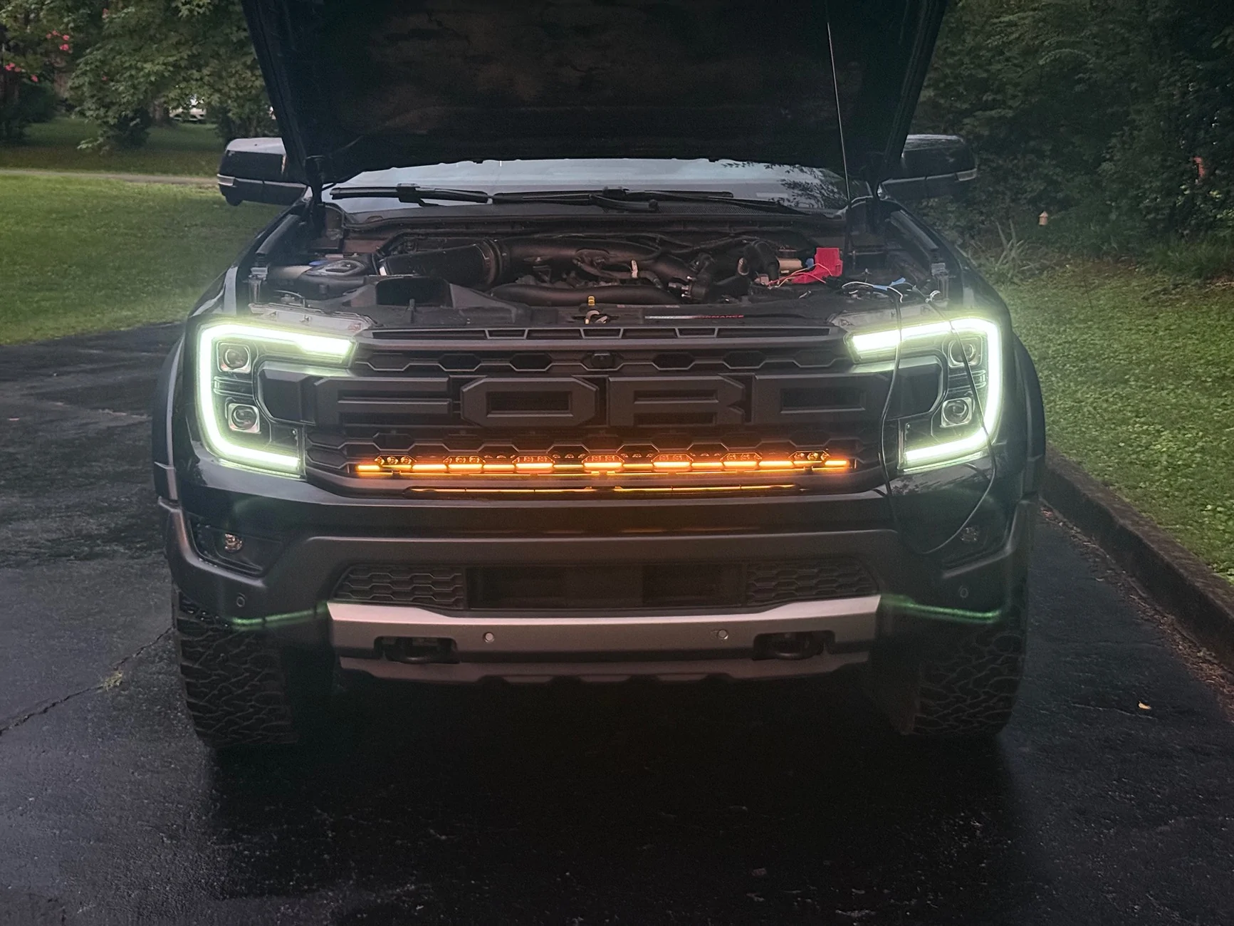

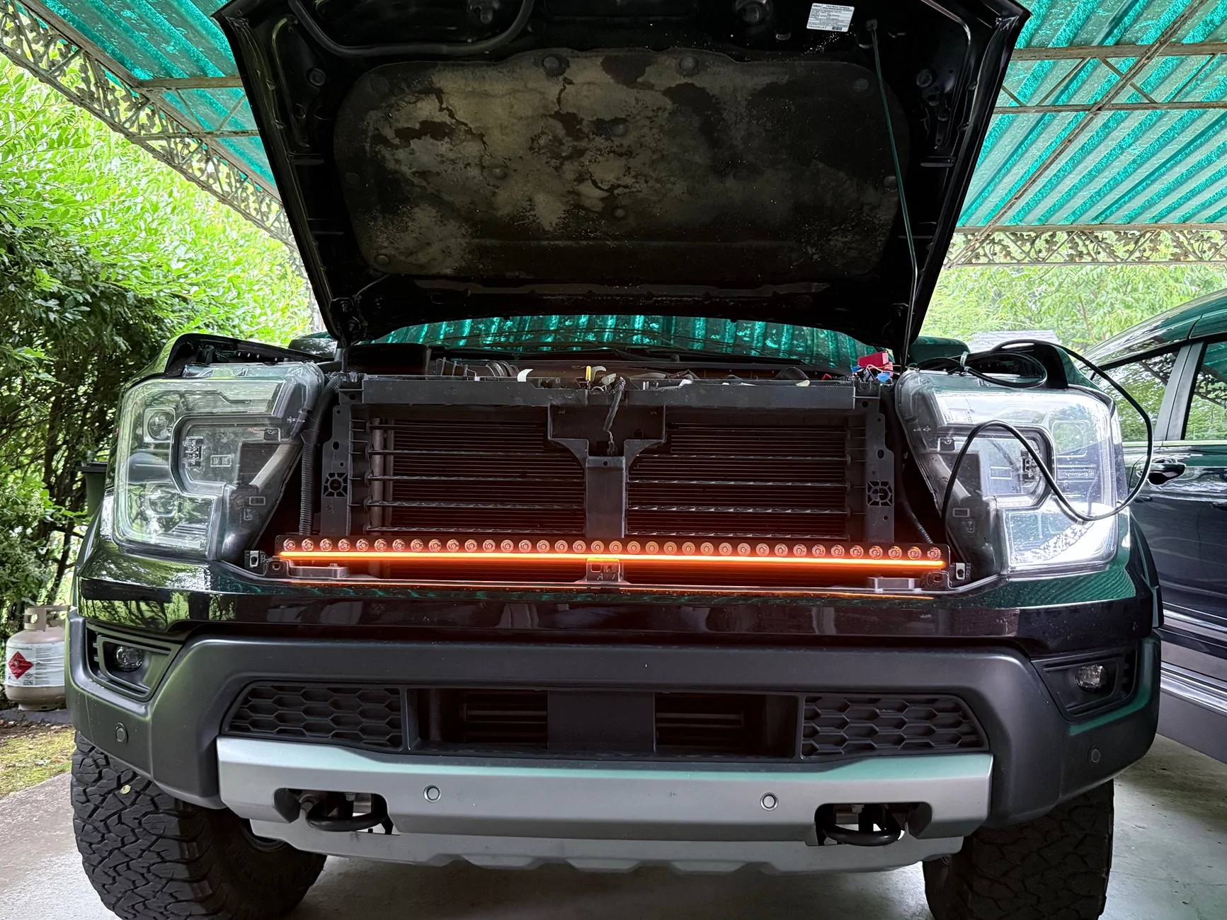

2.5hr install so far. Still have to final wire everything. Probably be asking for wiring help after some searching.

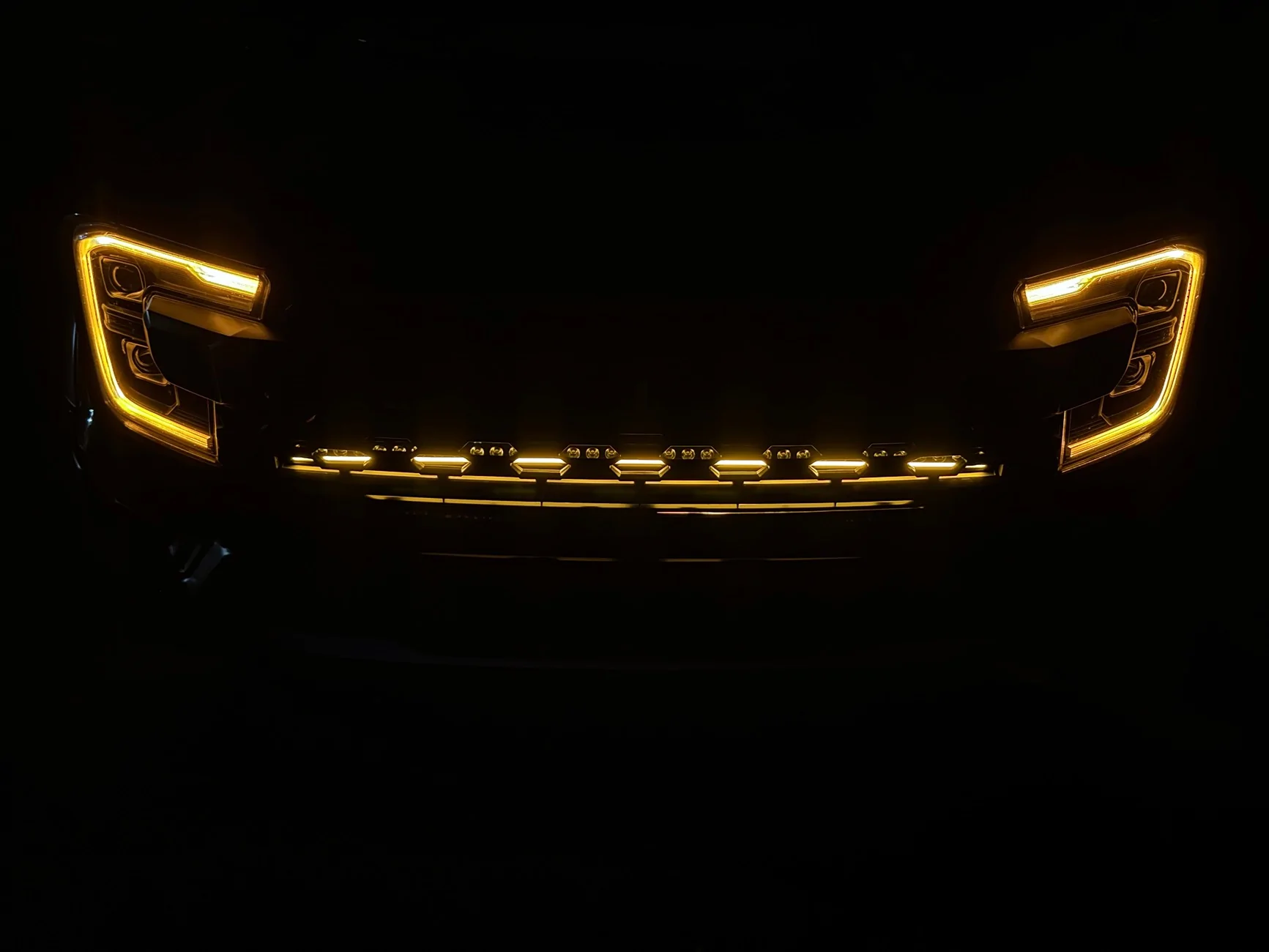

Wanting smber DRL on with factory headlight DRL’s, Aux switch 6 or 1 turns on light bar and light bar lights up with high beams only and only if aux switches on.
Waiting on Signature Lux Amber DRL circuit boards before removing anymore parts again. Just ziptied wiring up out of way while wexwsit

Very happy with fit. Alignment of amber DRL with factory headlight DRL was the goal. Minor trimming necessary.

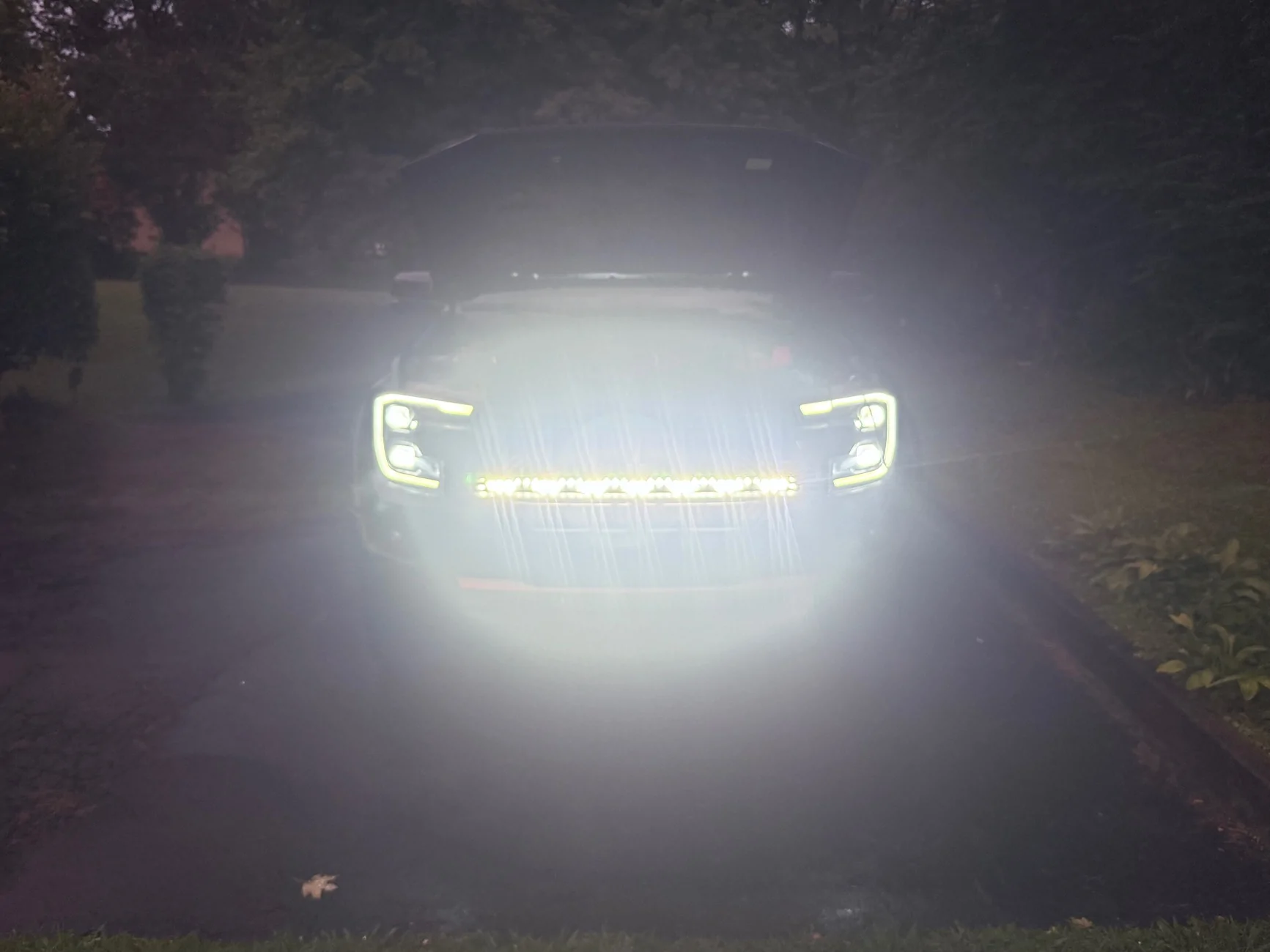

Looks clean, like the look, any way you could do some light output pics at night? Wouldn't mind seeing how they light up the road!

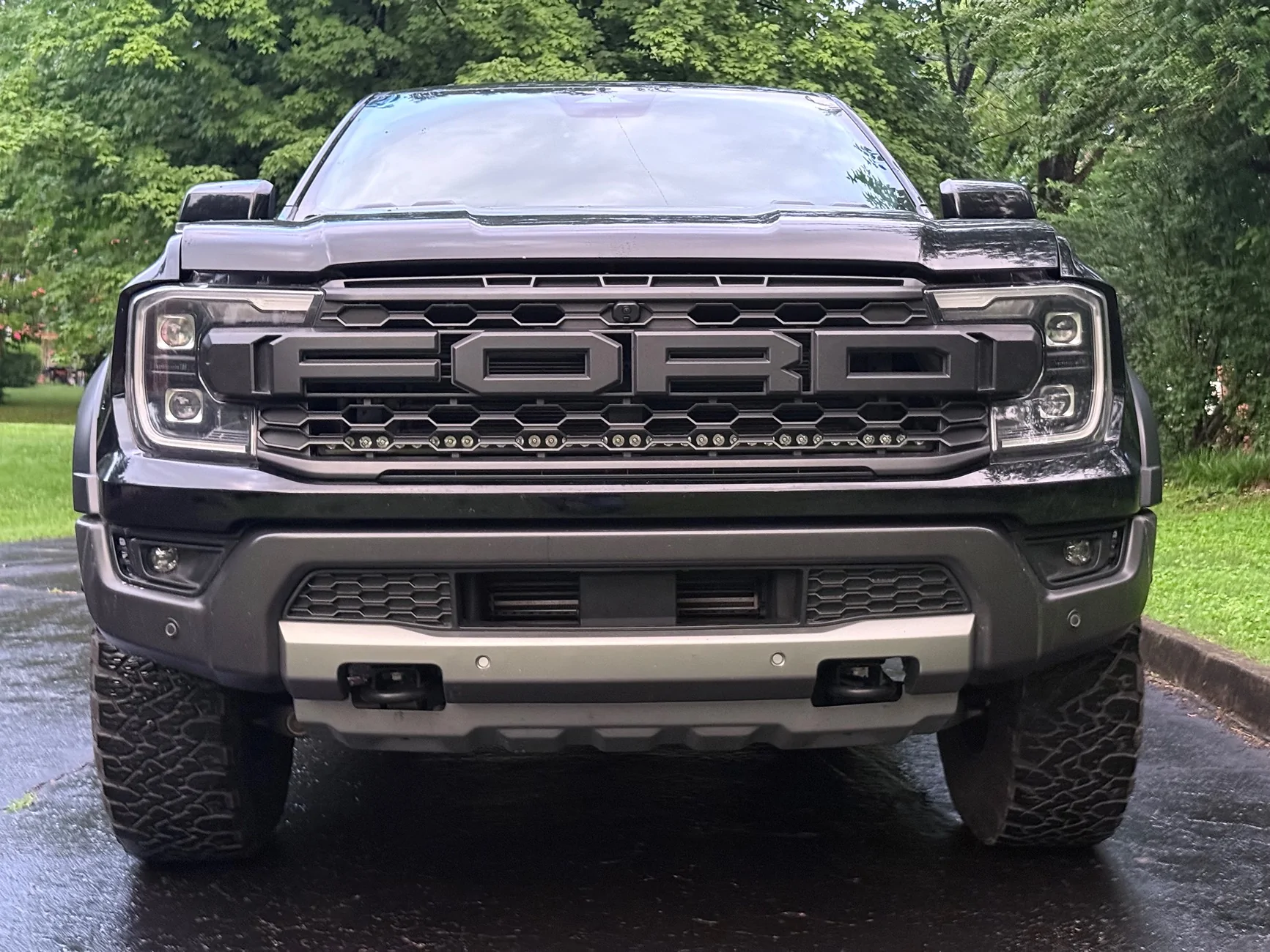

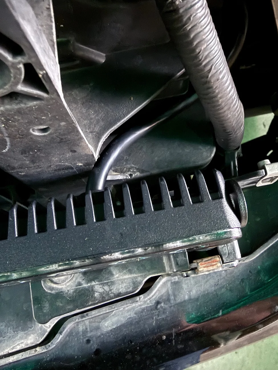

I used some parts from the supplied end brackets and powder coated brackets I had from a TV mount to shim alignment to DRLs.
Thru-bolted on plastic subframe structure.

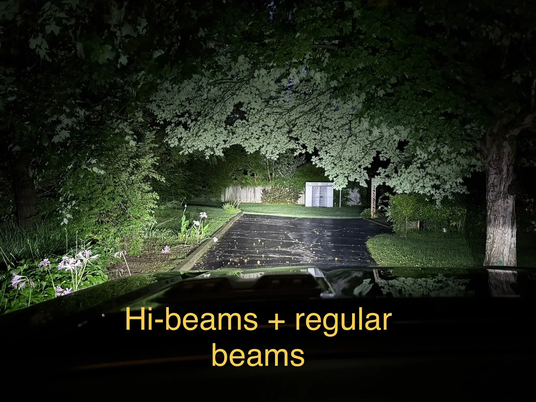

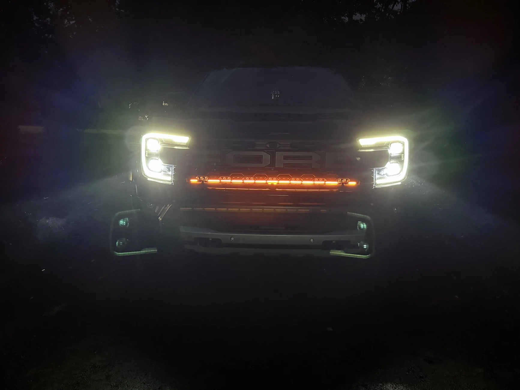

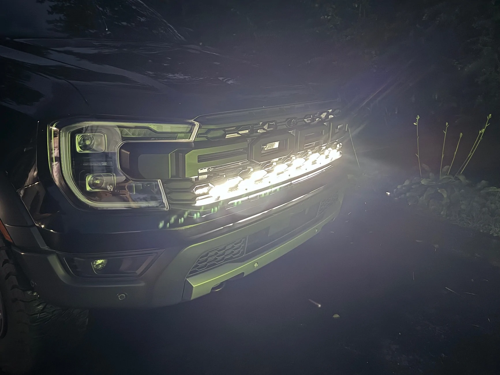

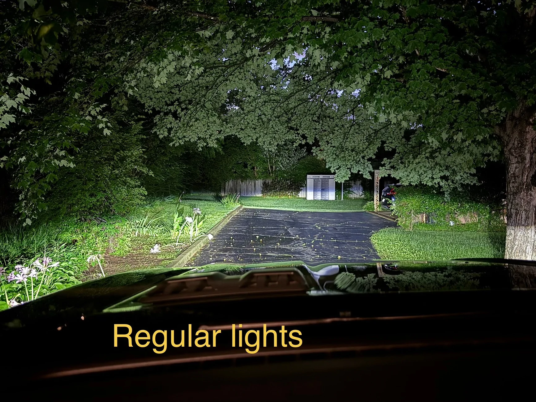

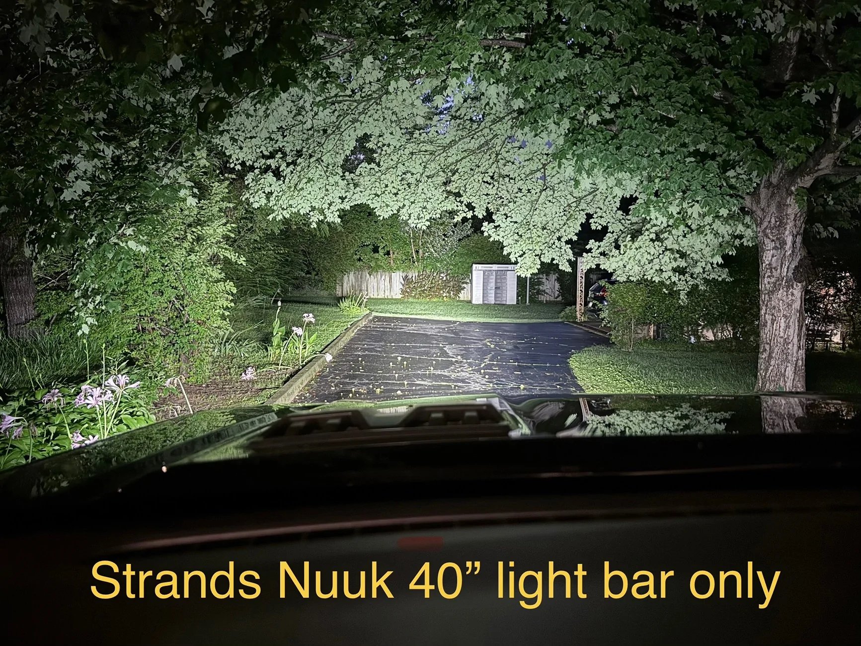

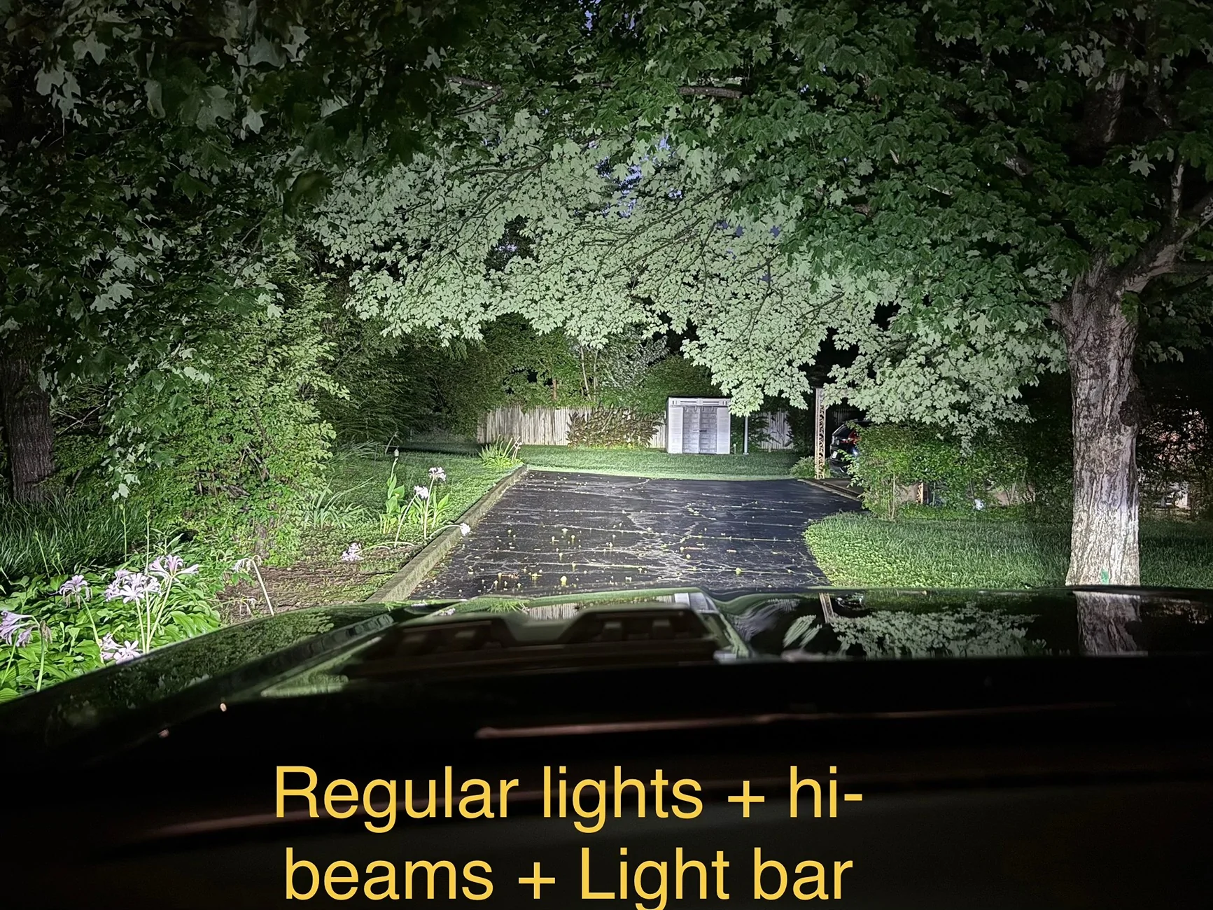

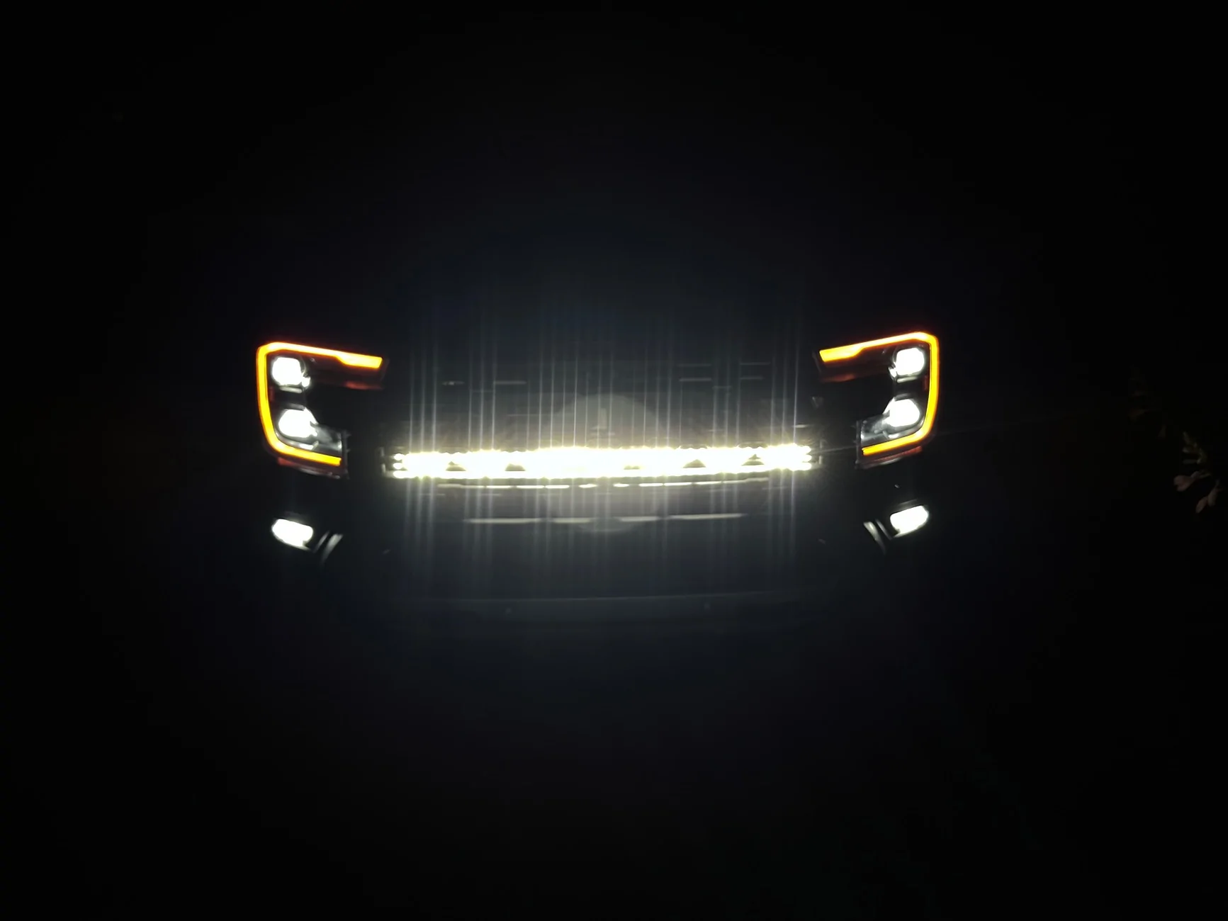

Haha, quite a difference in the 4 pictures. I’ll give you those pics do not show any distance.
19,600 actual lumens @ 1 LUX at 1900’ pulling 200watts.. On the interstate the entire road is illuminated with just the light bar.
Once there’s less daylight hours I’ll do some adjustment vertical. Left/right aim is perfect, but vertical needs to be adjusted.
