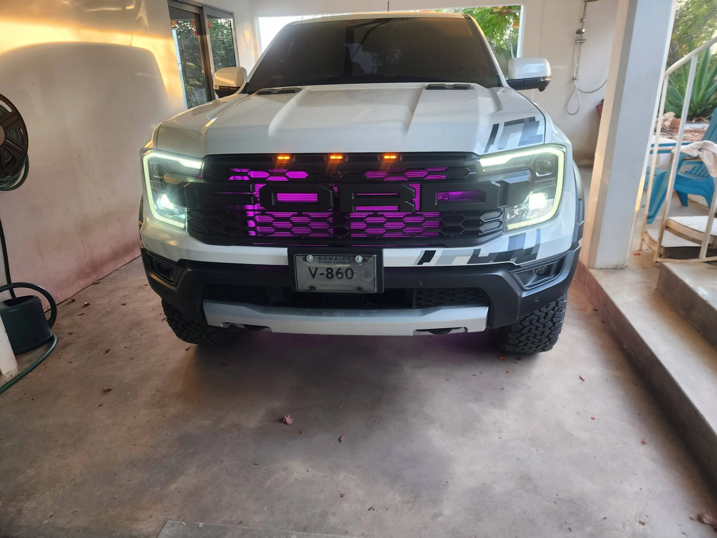

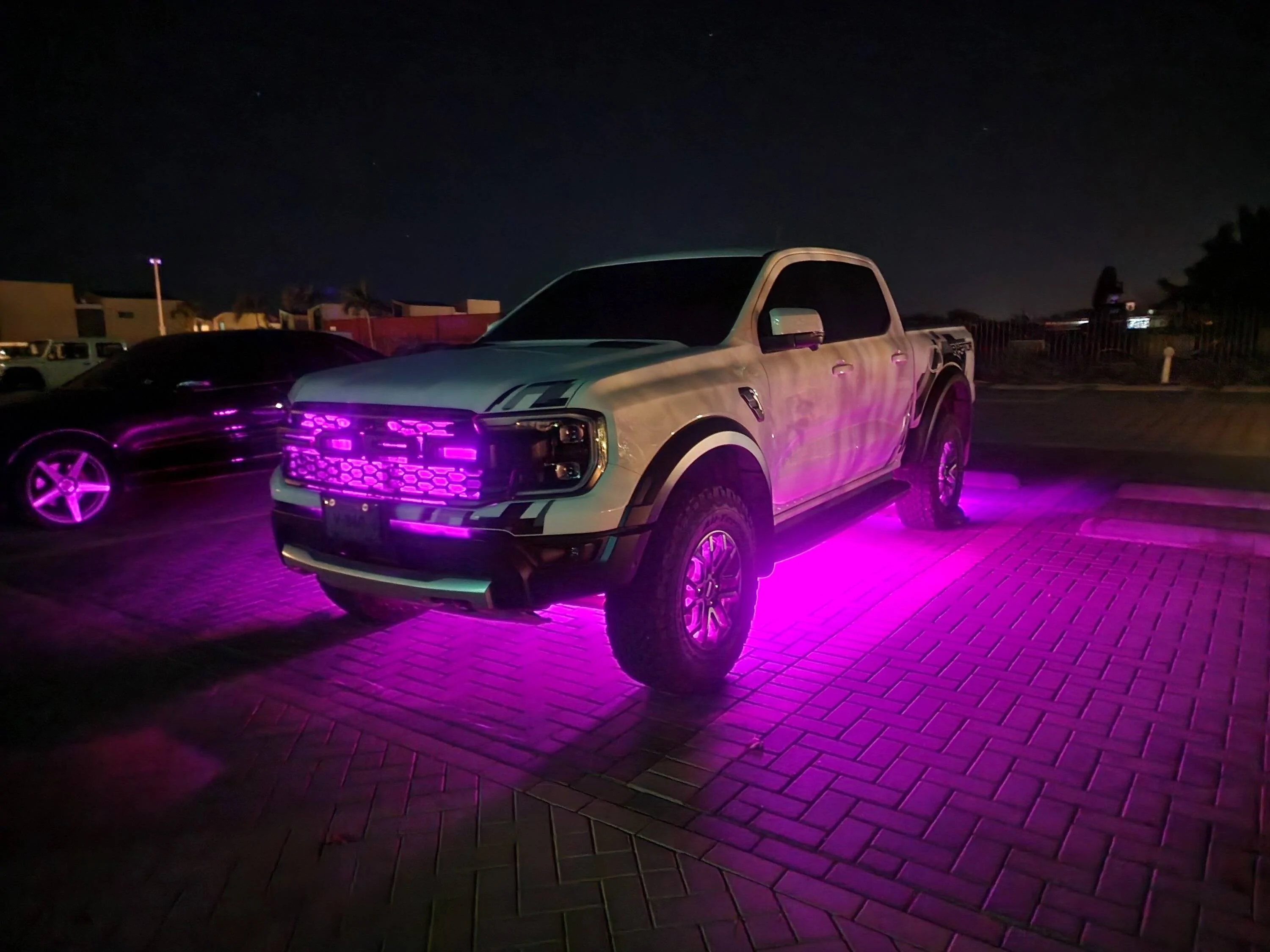

The underglow I connected directly to the battery. So I can switch them on/off even if the car is not running.
The amber lights should go on and of automatically with the daytime running lights, so that's why I'm not sure which connection to use. Logically I would think to open the connection on the headlight unit and use a wire from there, but the electrical is pretty complex and I don't want to mess up.

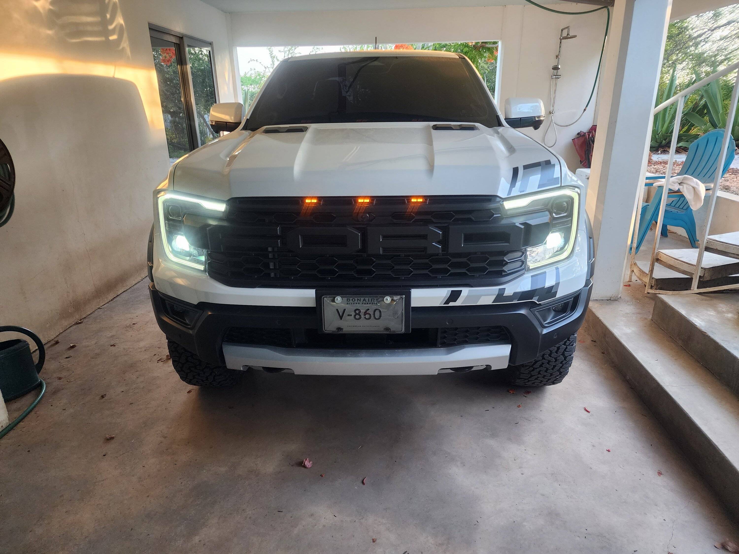

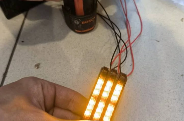

And these are the 3 little lights I want to add in the front grill top:

I've connected the hot wire to the "not used" 10 amp fuse and the cold to the battery -
Works perfectly, the 3 amber lights are on when the car is running. When the ignition is off they are off too.
The auxiliary I want to use later on when I will install the roof Led bar.
The underglow I turn on or off with a remote and/or my phone. So also when I'm outside the car.
