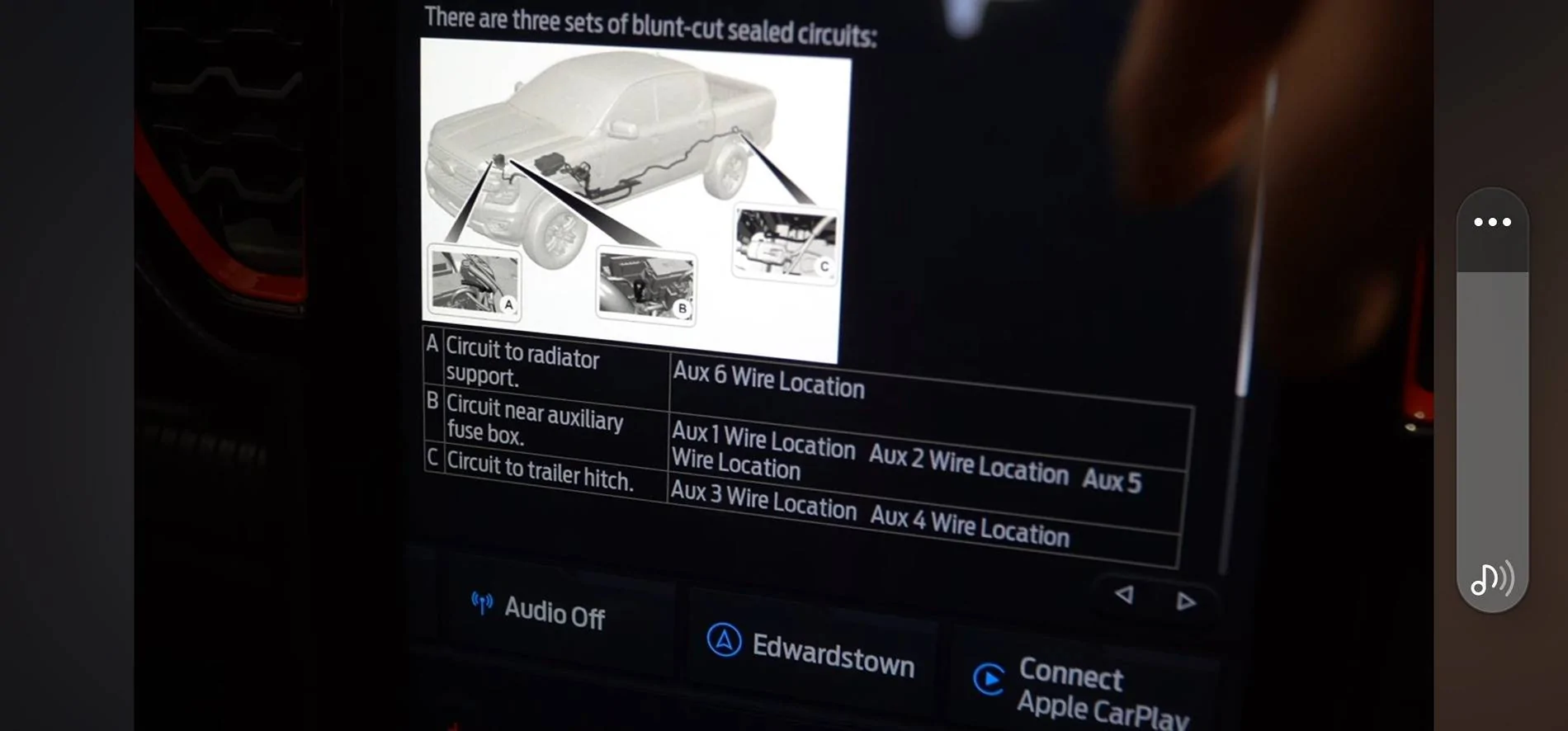

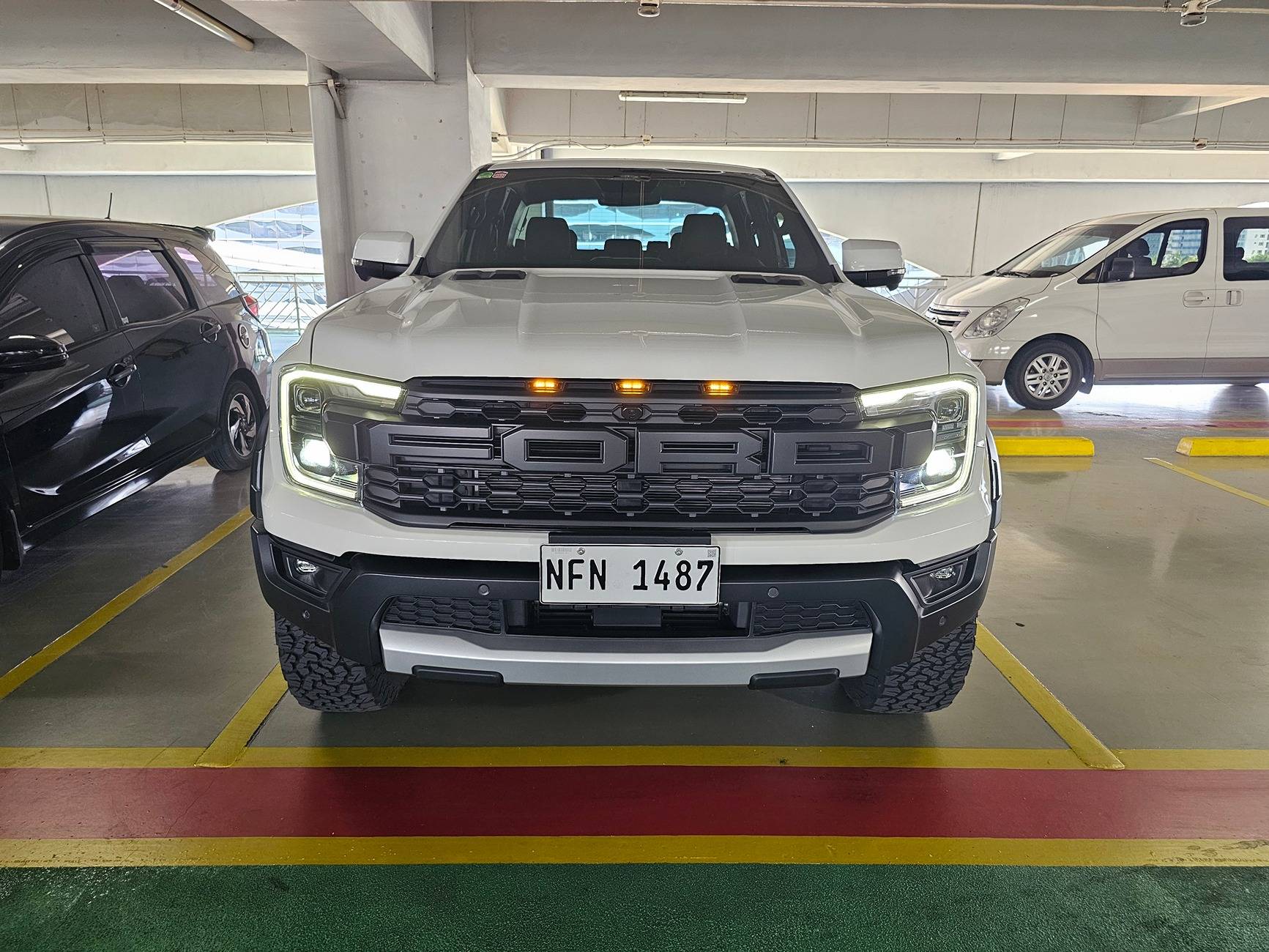

I got this from ebay...I just drill a 3 mil hole in the back and connected to swith 1 in the bank..

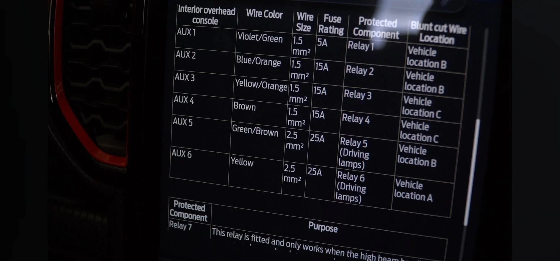

Did you hook these up to Upfitter switch 1? I dont have my RR, but does the manual show the amperage for each switch? On my Gen 2 F150, switches 1/2 are 15 amp, 3/4 are 10, and 5/6 are 5. Just got me curios if it is similar, or all the same on the Ranger?

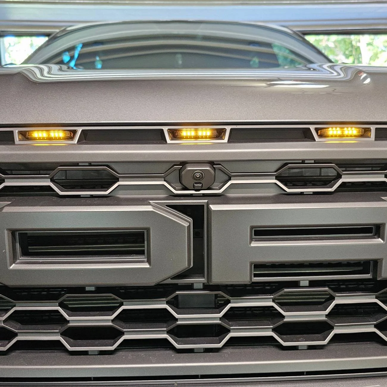

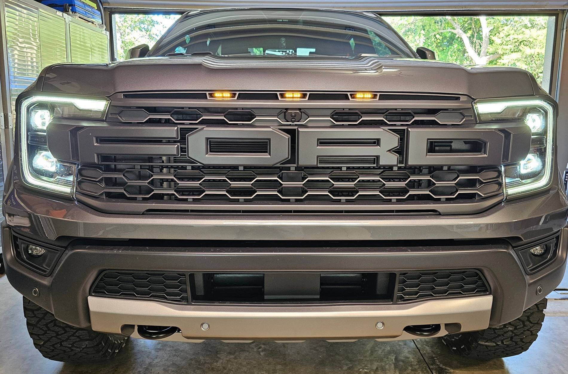

Does anyone know or can measure the dimensions of the 3 precut raptor light slots on the grill? My raptor is still on a truck so I can’t.
