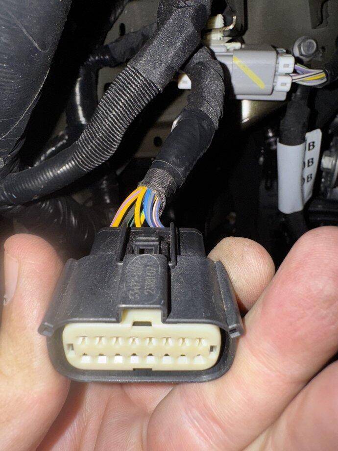

How did you connect the grille LED’s to this harness?
Did you have to remove the connector from the SPV harness or was it compatible with the fitting on the LED harness?
Cheers.
They sell a plug to connect to their adapter that is bare wire on the end

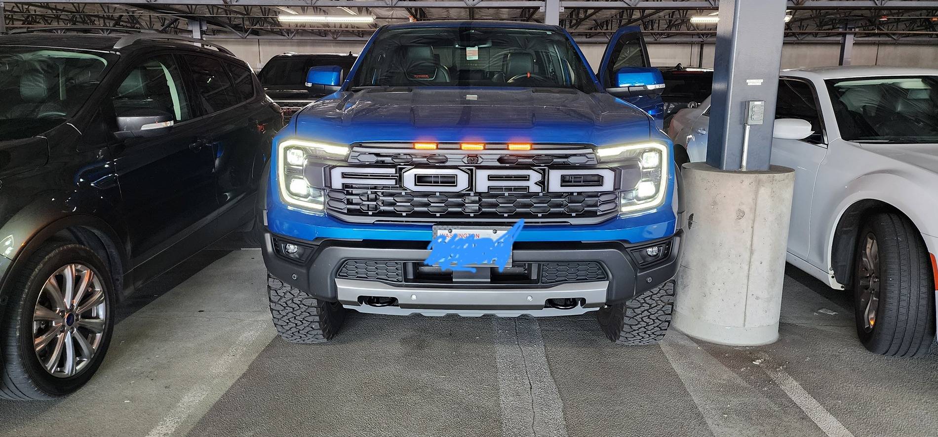

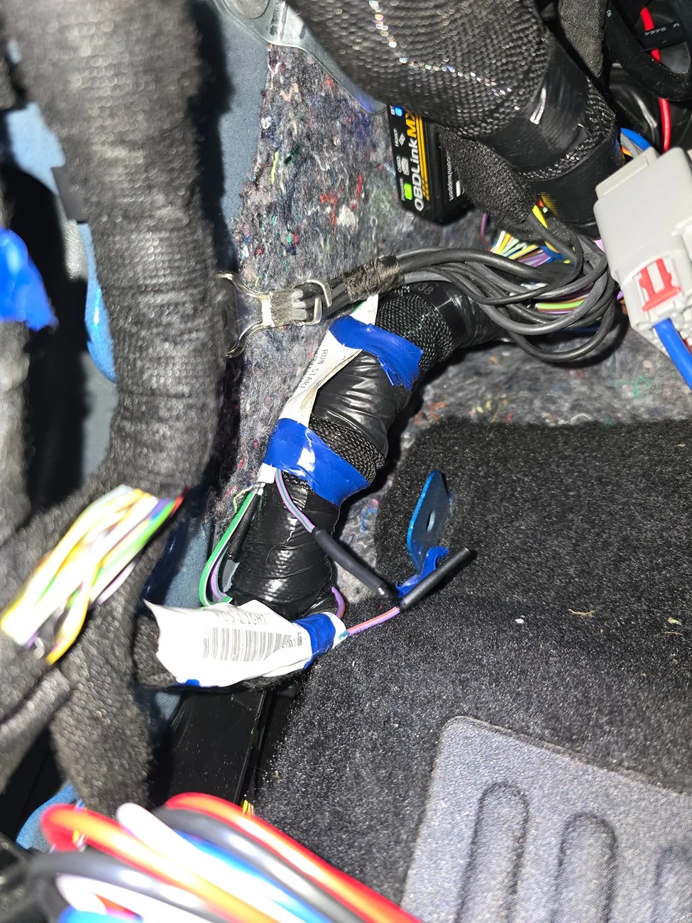

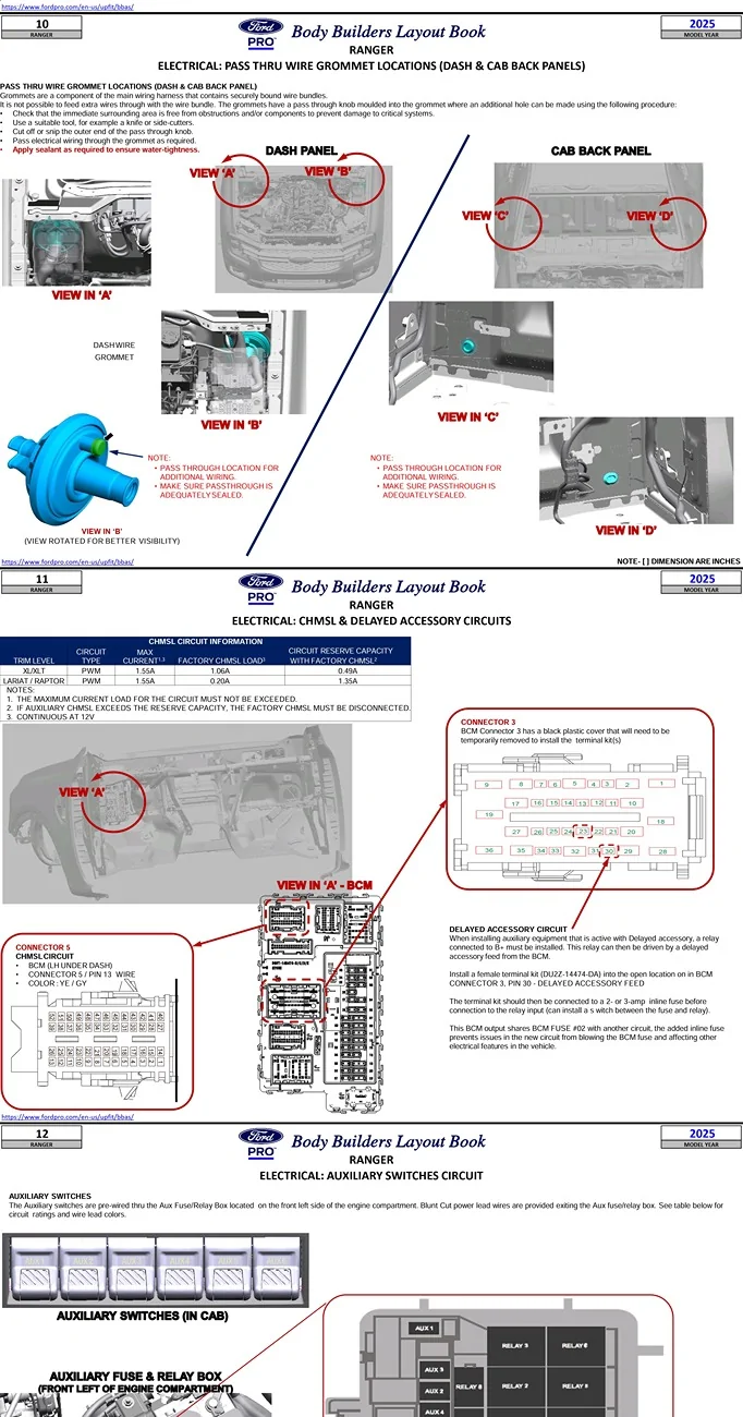

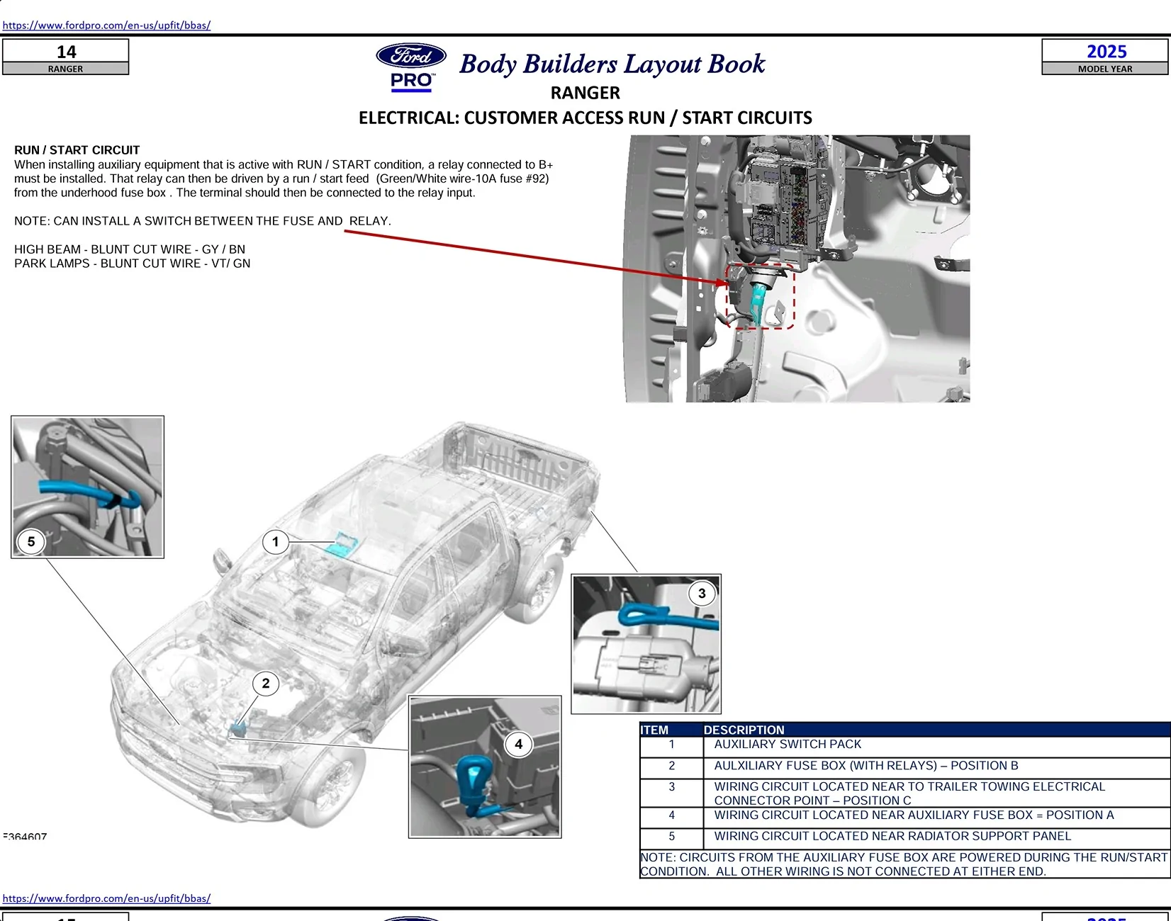

mine are weird using the blunt marker light wire under the driver side kick panel. there's also a ignition wire, and a high beam wire
Ford Ranger Wiring Grill Lights to Operate with DRLs 20250830_230434
Ford Ranger Wiring Grill Lights to Operate with DRLs 20250810_131122
Ford Ranger Wiring Grill Lights to Operate with DRLs 20250822_150431
Ford Ranger Wiring Grill Lights to Operate with DRLs 20250708_045644
Ford Ranger Wiring Grill Lights to Operate with DRLs Screenshot_20250910_185211_Adobe Acrobat
Ford Ranger Wiring Grill Lights to Operate with DRLs Screenshot_20250910_185236_Adobe Acrobat

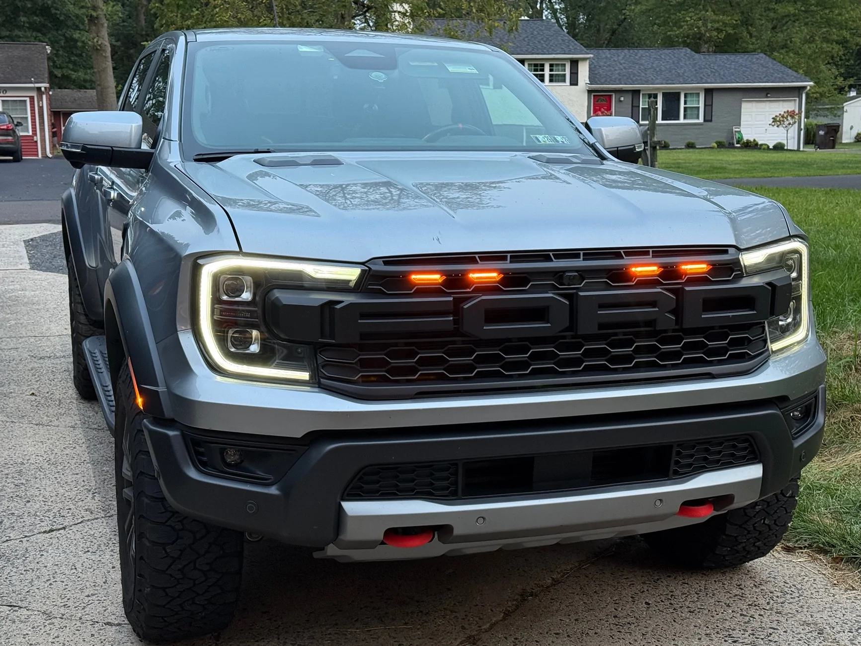

The connecters on my lights and SPV adapter were not compatible. I cut the ends off both and added an inline fuse.

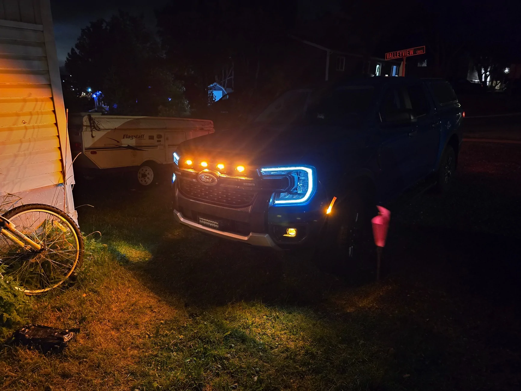

I installed my signature lux grille lights. Powered them with the SPV headlight harness. They came out great.
Lux Led
SPV Headlight Harness

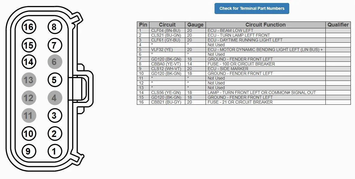

The SPV harness came with the tap on pin 3 (DRL@5v), I switched it to pin 9 (marker lights@12v). My marker lights are always on along with the grille lights.
I am about to take on this project and wanted to confirm before ordering parts. Along with the Amber Grille lights you ordered these SPV parts?
1 x SPV Parts Harness System 2024-2025 Ranger (Raptor) LED Headlight Parking/Headlight Connector Adapter
1 x SPV Parts SINGLE Pole WP Add On Connectors
Did you also change the Tap on Pin location? From Pin3 to Pin9. Is this necessary? What is the benefit?
Pin#3 ECU Daytime Running Light Left
Pin#9 ECU Side Marker
Pin #9 is the marker lights, which has a constant 12V and comes on with the marker lights/headlights. (Forscan can make it always on)
Pin #3 is DRL which is always on but does dim/reduce voltage.
I switched the pin to #9 because I wanted full 12V and switched with the marker lights.
If you contact SPV they will send you the connector with the pin in the location you prefer.
