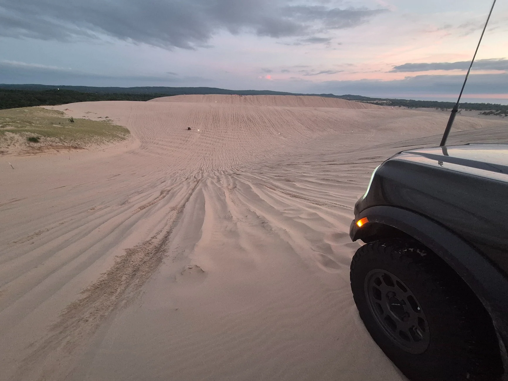

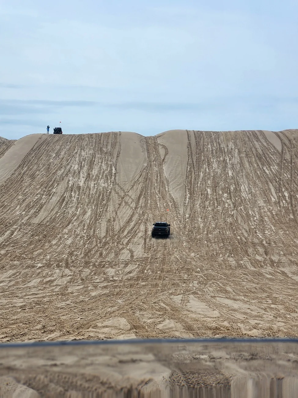

- High speed off-road rally-style on dirt roads, gravel roads, sand dunes and farm fields, including jumping the truck!

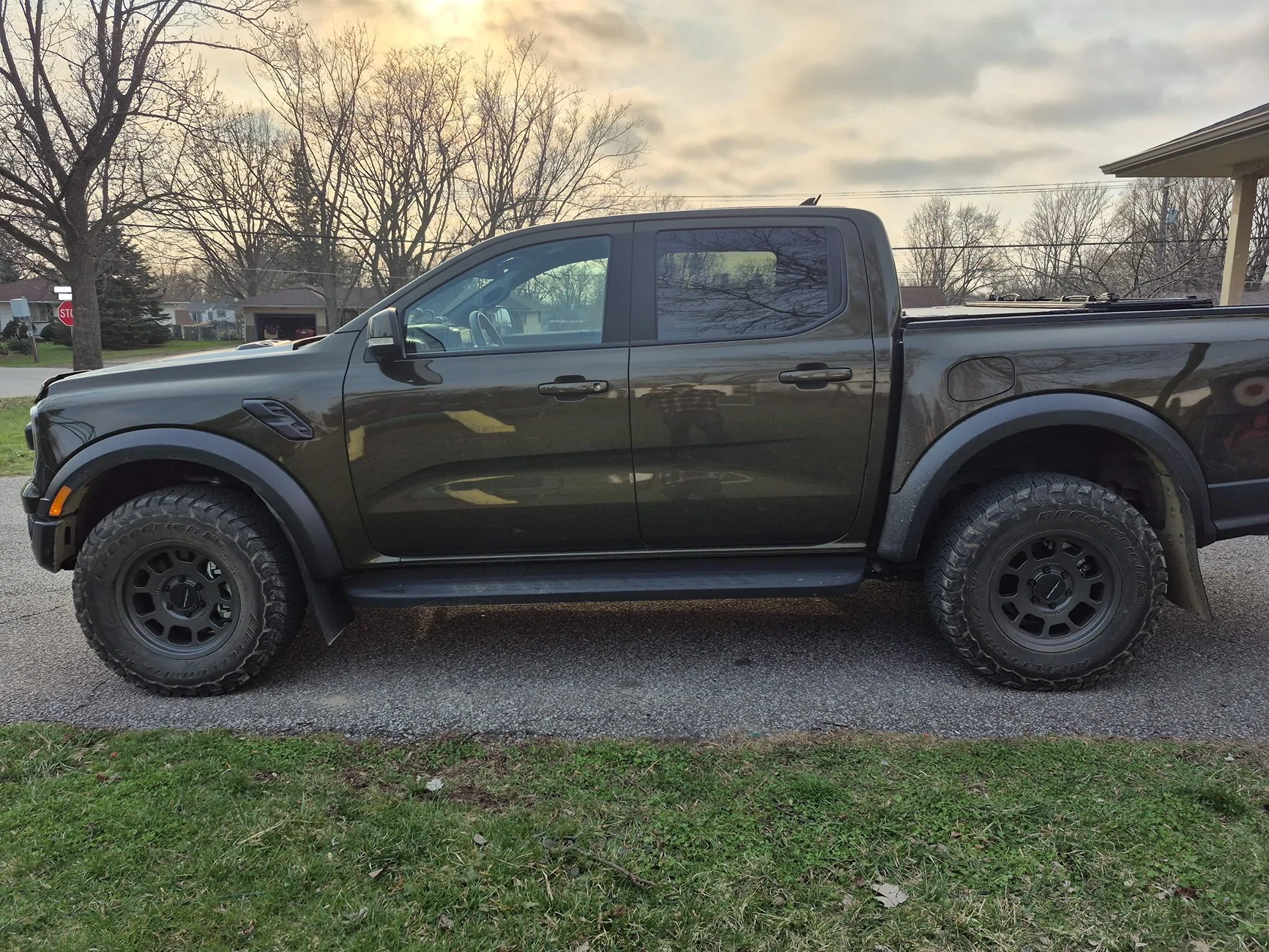

Implemented Modifications
1. Ford Performance Pro Cal
2. Method 705 17x8.5 ET+35 Bead Grip Wheels in Titanium Grey (including spare, so 5x total)
3. Worksport AL4 tonneau cover.
4. Line-x custom lining under the rocker panels for rock chip / corrosion protection.
5. Value Guard cavity wax inside weep holes for rockers / fenders to prevent internal corrosion.
6. Value Guard VG-104 coating behind pinch welds for additional corrosion protection (live in a state that sees lots of road salt in winter).
7. Torque Detail ceramic 2yr DIY coating to prevent clear coat oxidation over time and reduce scratches / corrosion on rock chips (wax over the rock chips to seal them off, worked well on other vehicles where they never rusted). I can do this myself in a few hours, once every 2 years for $100, not bad!
8. TirboTEX DLC of entire powertrain (engine, transmission, front and rear diffs, transfer case).

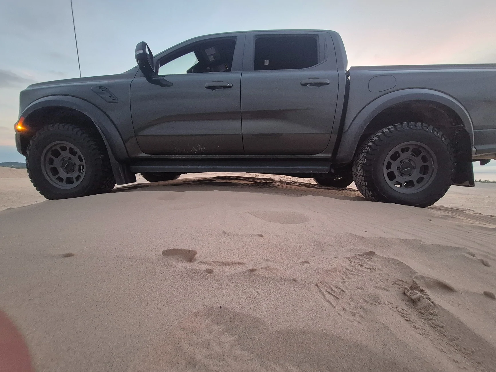

- Method 705 17x8.5 ET+35 Bead grip Wheels: 25.2 lbs per wheel vs. 36lbs from factory bead-locks. Bead grip technology provides 95% of the low-pressure bead reliability of a true bead lock but is maintenance free, DOT legal and more reliable on road. Slight increase in track-width from higher wheel off-set lowers CG further without reducing ground clearance or significantly altering scrub radius (which affects steering kick on rough terrain). Reduces rotating mass by 43lbs, reduces total mass (includes spare tire) by 54 lbs allowing the weight to be re-allocated to more productive uses (i.e., rock sliders, cargo management).
Goal #2
Method 705 17x8.5 ET+35 Bead grip Wheels: Reduced mass improves both braking and turn-in responsiveness. Increased track width lowers effective CG or if paired with larger tires and a lift, compensates for the added ride height to keep as close to factory CG as possible for a near net zero CG change.

Most of the time, if you willing to tactfully choose your line instead of just "going at it", the stock clearance is adequate aside from the stock side steps. So, sliders alone will significantly enhance the off-road capabilities without taking away from the high-performance nature as just one example. The tonneau cover is another example, slight increase in weight is more than off-set by the reduction in drag losses from covering the bed / trail gate at higher speeds (fuel economy, drag strip passes, high speed straights off-roading in the dunes or desert etc.) and it adds functional protection of the bed contents. This hopefully illustrates the "performance car mindset" I have taken with my build with very strategic carefully thought-out changes.
