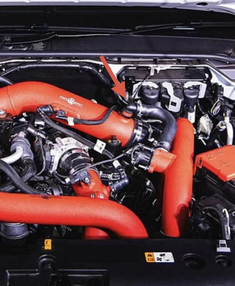

I’m trying to avoid going to dealer to order a part for my 2025 RR. At the opposite end of the rubber hose that connects to waste gate is a L shaped plastic pipe with a gasket and ring around it that connects into the air charge hose. I broke the ring and it comes loose, have it Frankensteined in place right now. Doesn’t look good with my Process West pipes. I’ve looked and looked, but can’t find a part # in any diagrams. Figured I’d give it a shot

Can you share a picture?

Looks like an old school PCV valve.

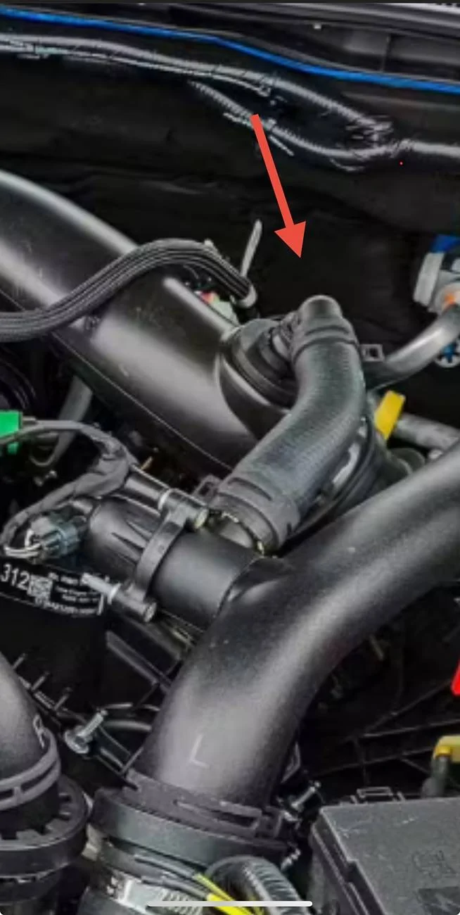

Similar, it’s empty on the inside though. Hopefully this part I ordered the right one, if not it was only $30. Temporarily I put heat shrink tube around it, but it took several odd shaped pieces because of where the bend is and how close it is to where it snaps in. It’s pretty unsightly.

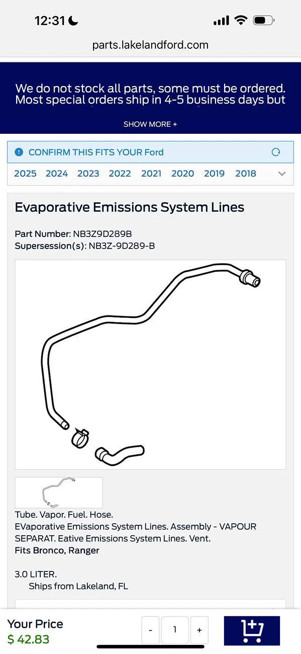

Sorry for the slow response. I have a few extra. Saw you already ordered though. When I was testing the PW unit, I added a hose clamp to that area just to be safe.
Ford Ranger Trouble finding part near wastegate on RR. Screenshot 2025-07-04 at 12.51.35 PM

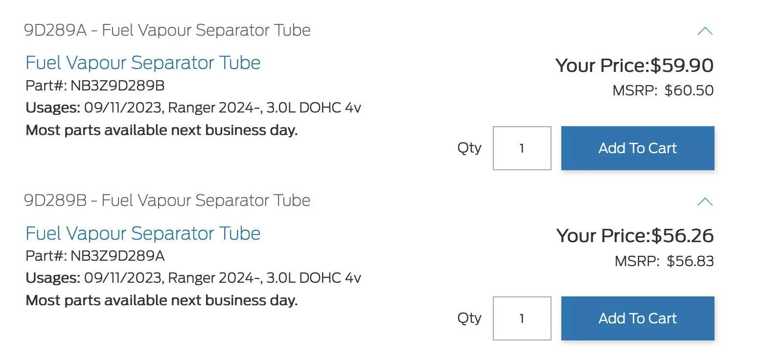

Thanks. I think I got the right one. I looked those up and this is what I got
Ford Ranger Trouble finding part near wastegate on RR. IMG_9960
The ring on that tube I couldn’t get to seat around the flange that it goes into no matter how hard I pushed. I think it wasn’t milled quite enough, probably needed another mm. That’s how I broke it. I’ll be a little more careful with this one.
