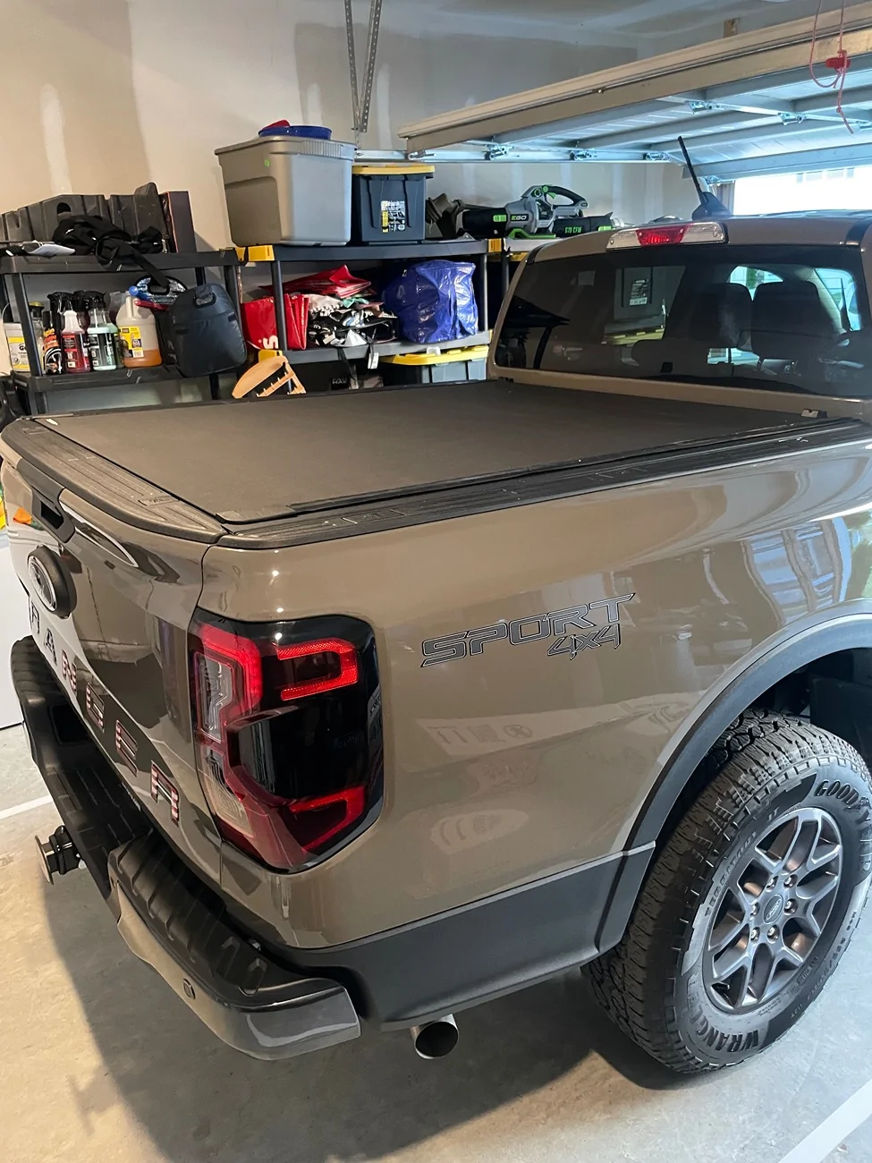

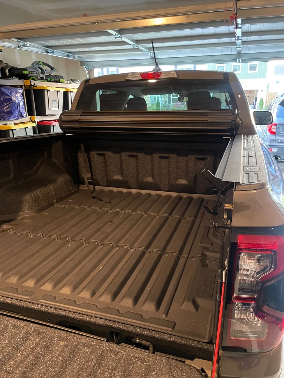

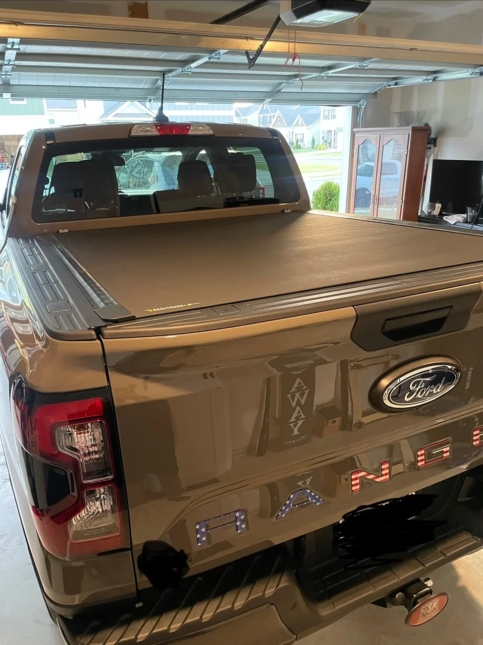

Took me longer than I wanted it to, but your tips definitely helped it go smoother! Thanks so much!

That looks awesome! Looks like it fits perfect, very cool! Thank you for sharing.
