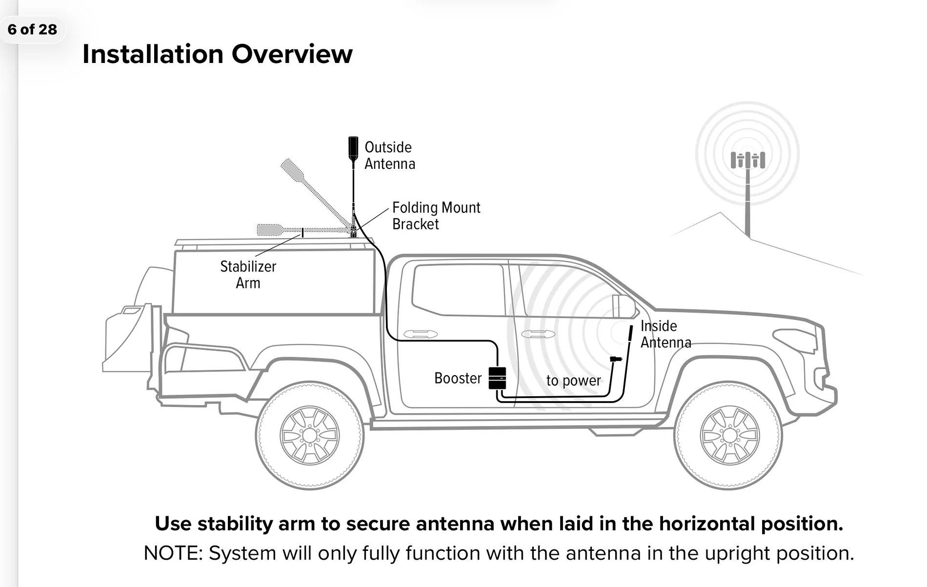

Where do you plan to mount an antenna? Do you have a topper or rack? The Weboost antennas (non-magnetic base) do not require a metal ground plane, but a taller mast is always better, in terms of overall performance. And they won’t work at all when rotated horizontally…. Since the Overland antenna has a rotating base, there is really no way to completely hide the cable. You can use one of these close by, to route the cable into the cabin..
Scanstrut DS-H6-BLK Horizontal Cable Seal for Cables from 2-6mm - Black
I think the regular Reach antenna can be flush mounted, but it will not perform as well as a taller model…..

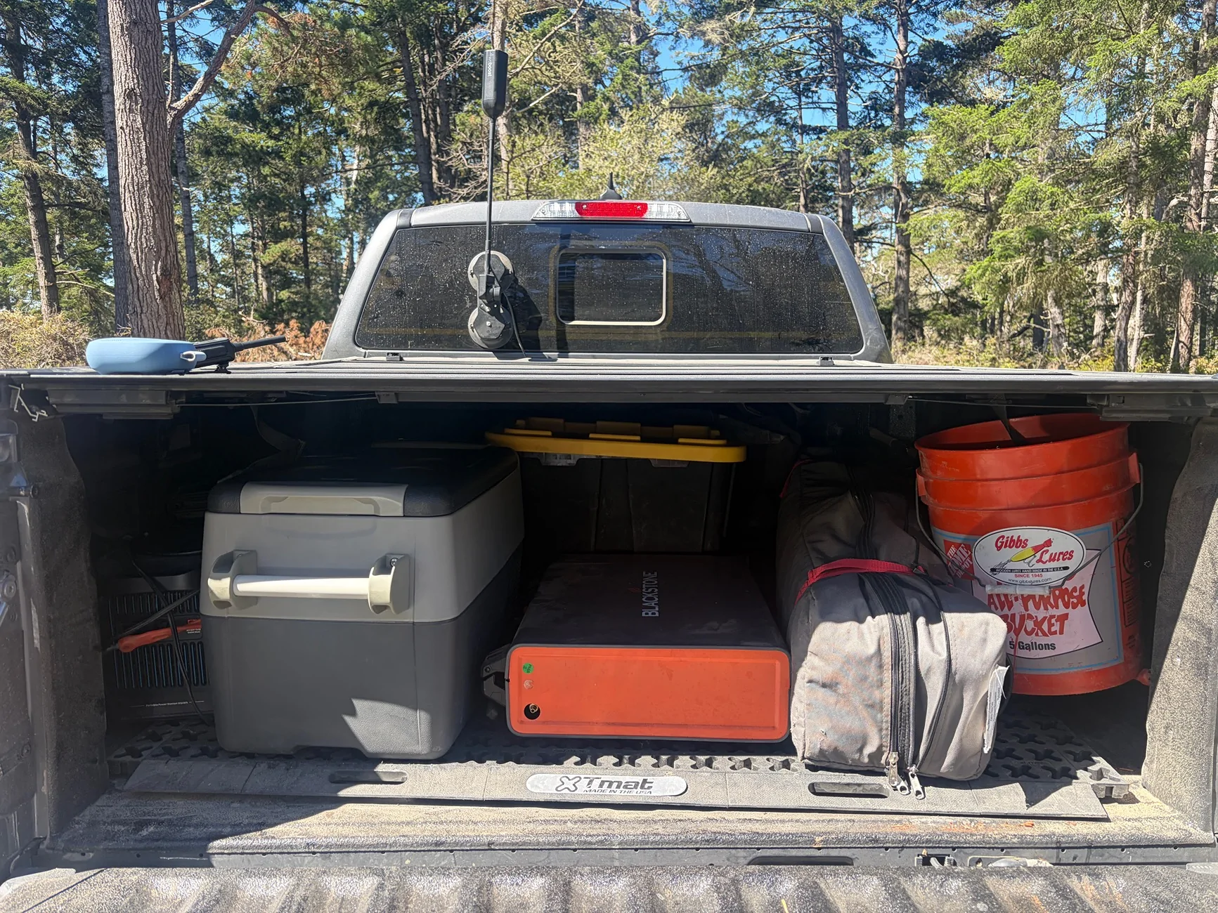

It was easy to run the antenna cable out of the cab behind the rear seat-back through a factory hole/grommet on the passenger side. I’m using a Seasucker mount so I can loan the WeBoost out and anyone can use it. For the internal antenna I have it sitting where the wireless charger is and seems to work well. It also fits on the center console in front of the shifter.
For a clean mount for the external antenna, some companies make an adapter plate for your high-mount brake light that should be waterproof and have no wires outside. In the future I will build a bracket between the bed and the cab to mount the antenna.
I’ve taken it up the CA coast, Central Oregon forests and all over the Bay Area. It’s not perfect but very helpful on remote drives. I was surprised many times to have reception for phone calls, maps and streaming music in the boonies. There have also been times when there is no signal to boost and in that case, satellite would have been better.
