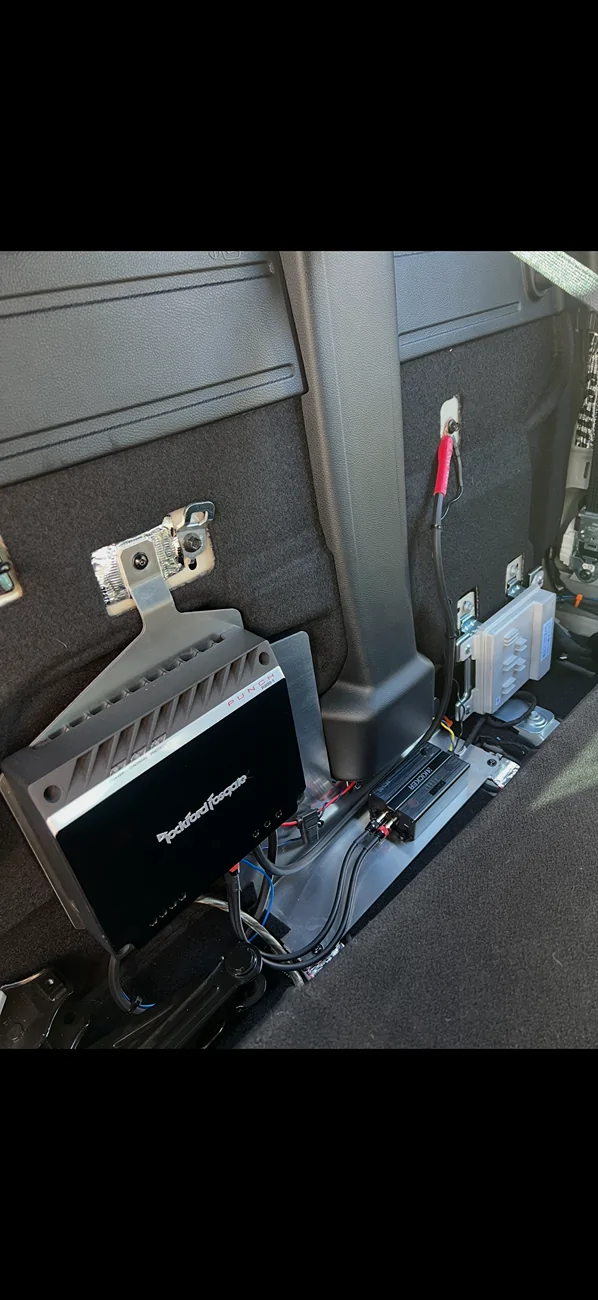

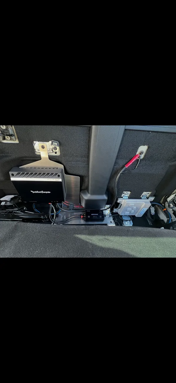

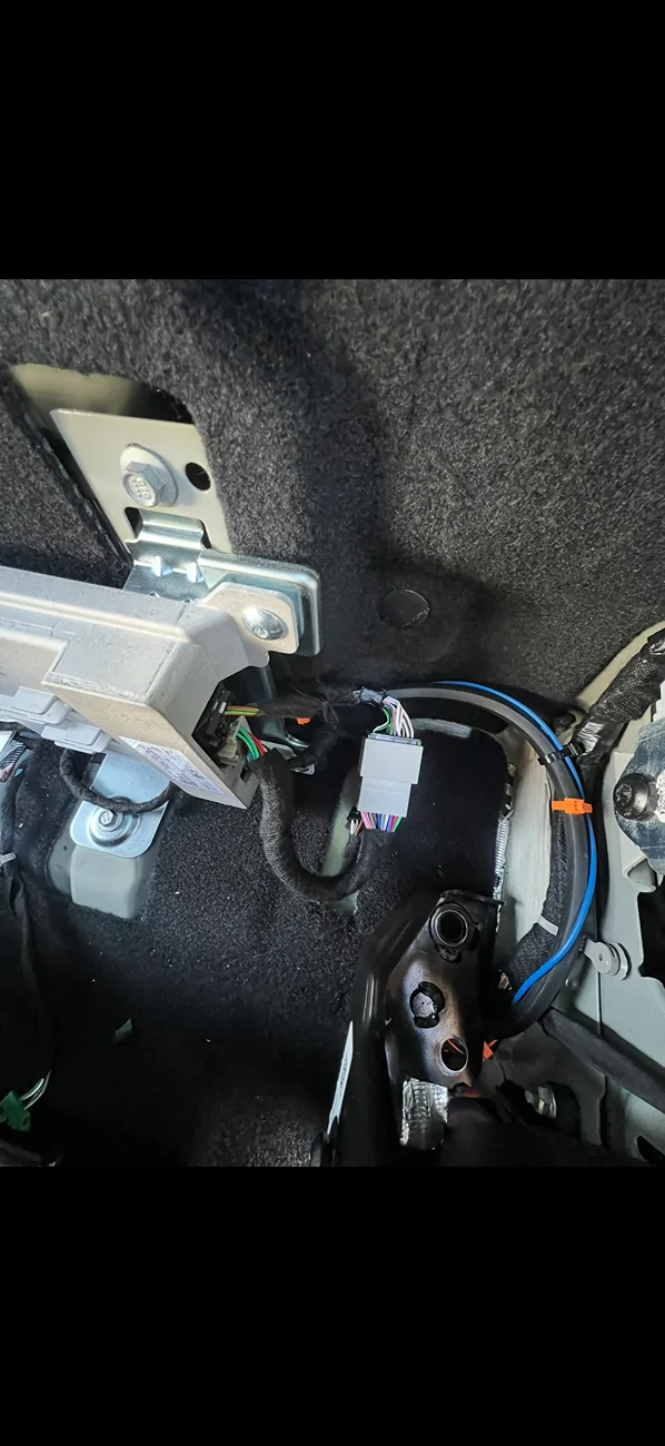

Sounds Good Stereo has/fabricates everything you/we need for a fairly easy install to gain access into the factory stereo/amp harness without having to hack into it at all. Truly P&P!
Tore out the measly B&O sub and went with the Stealthtech box with a 10” Hertz sub, but it’s now powered by a RF Punch 300.1 which feeds through a Kicker Keyloc by-passing the factory amp for the sub woofer signal. The SGS harness is TRULY P&P as seen in the photo at the factory amp. Plus, the Keyloc fixes the bass roll off issue in these Rangers and when you order it through SGS it comes pre-set up for the interior of these trucks. No programming or adjustment needed to the Keyloc DSP. Mine was perfect right out of the box.
Looks like nothing is listed for the '26s yet, but I also don't have the B&O, so no connections back there to tap into easily. I'll probably live with the OEM for now :(
