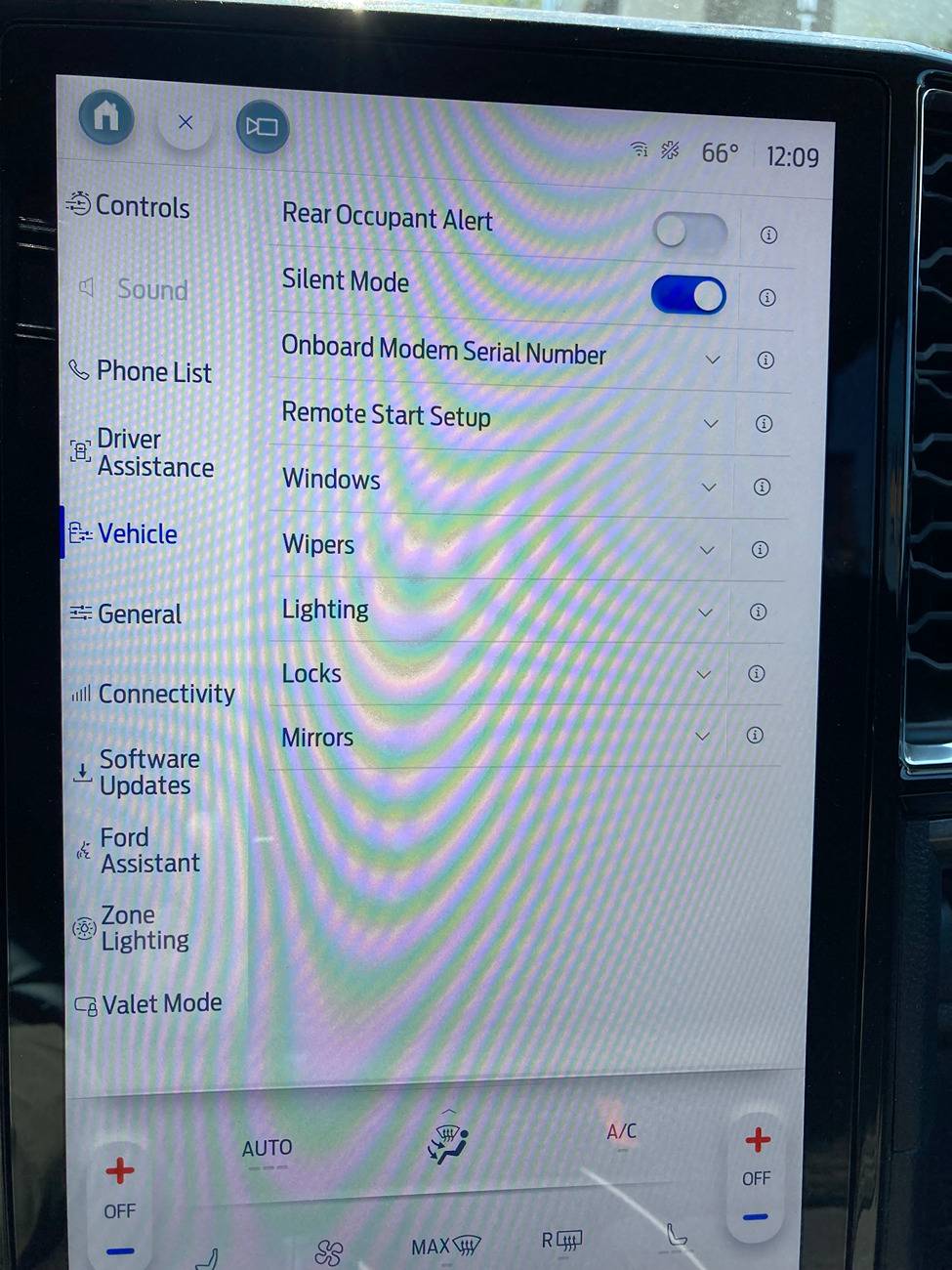

Problem solved: I found FORScan and added a switch to the center console screen that disables all lights when the doors are opened. While I was at it, I disabled the "welcome chimes" that play when the key is turned in the ignition, and made it so that a double-click is required to activate the panic button.

Can you share what FORScan items you changed to do all of these? I’d be interested in doing something similar.
Can you send a picture of what the switch looks like on the screen?
Seconded. I really don't need to light up the campground when I open the truck up to grab something.

I enabled Silent Mode in the BdyCM, and added the Silent Mode button in the APIM. I'm brand-new to FORScan, so I'm not really qualified to give any instruction. There is, however, a thread in the Ranger5G forum that I found helpful:
https://www.ranger5g.com/forum/threads/forscan-crowdsourced-wiki.2008/
Also, the FORScan web site has links to a forum that has a bunch of useful information. I'm attaching a photo of my center display showing the silent mode button. On means lights are disabled when the doors are opened.
Ford Ranger Welcome Lighting When Door Opens Screen
