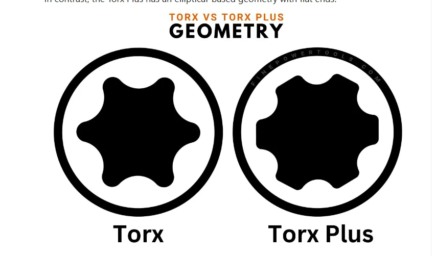

‘I am still not sure exactly what the difference in T=Torx vs TP=Torx plus.
Both seem to be 6 lug or 6 point.
I ordered several different Torx plus on Amazon this evening.
I think that Torx plus makes since the lobes seem thicker which would explain why the T40 was sloppy but worked to get several out.
Is there propped removal process.
I know installing a rim and tire you tighten in a cris cross pattern.
‘I am curious should I have loosed the ring bolts in a criss cross pattern, the last 2 bolts were side by side and both were crazy tight and both are now stripped out. All the others came right out no problem.

I quote:
" Torx and Torx Plus are similar fasteners, but Torx Plus optimizes the design of the original Torx. While both have a six-point connection with the drive head, the Torx fastener allows for a 15° drive angle, while the Torx Plus has a 0° drive angle. This increases the available torque and minimizes wear on the fastener and drive head. You can use a standard Torx driver on a Torx Plus screw, but not the other way around. "
