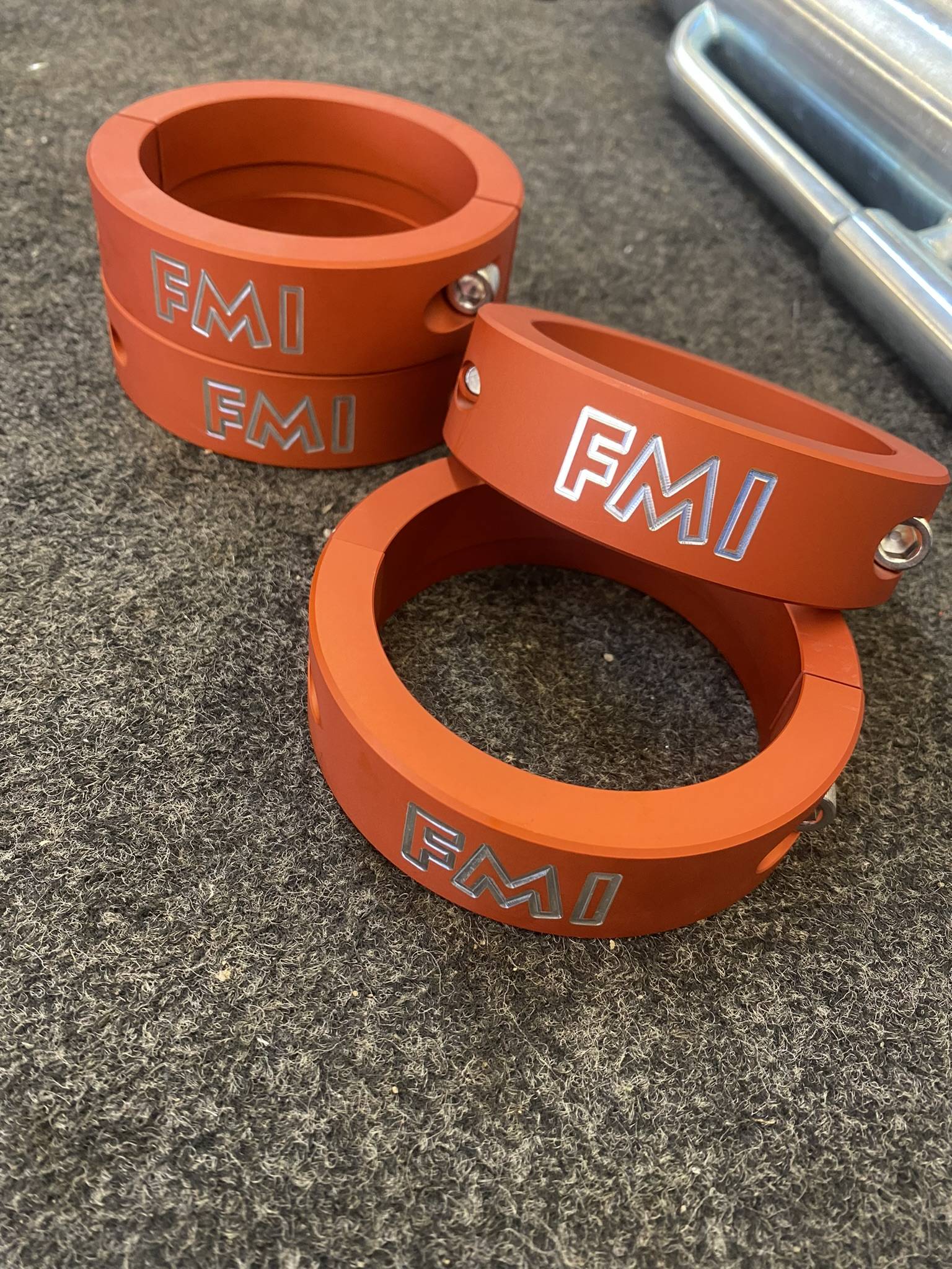

This appears to be the safest/proper way:
According to him, the ride is slightly stiffer up front, which makes sense, because the spring is more compressed normally, than stock.

Yep, but according this other one, spacers could be the bette way, since you don’t change the interior position of the shock piston relative to the bypass holes. They also remap the neutral position of the livefox after the new position…
make more sense for me.
Thats the discussion…
this one
