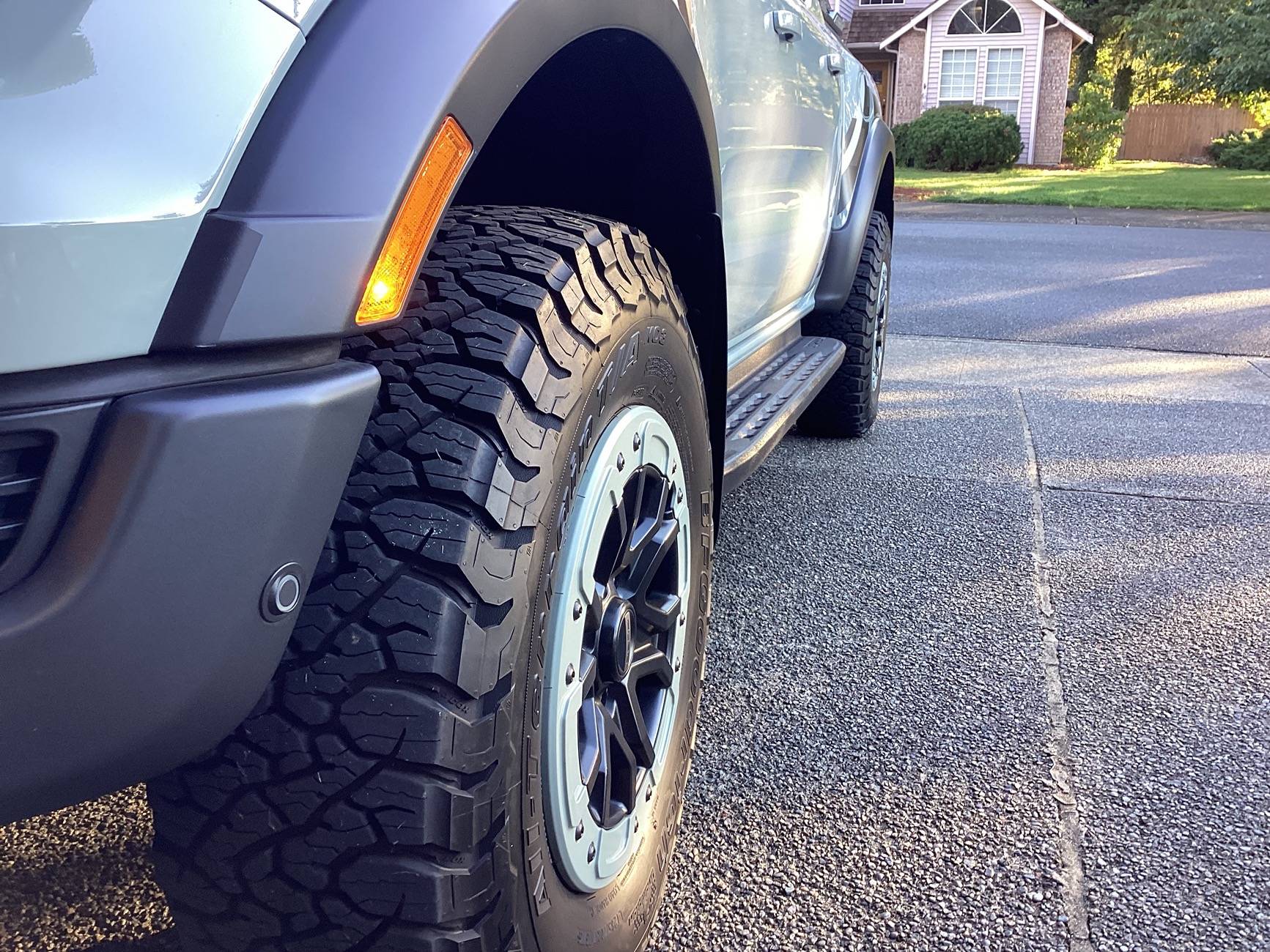

Folks, looking for your advice here. I have looked through a bunch of existing threads and can't exactly tell. What depth/thickness of wheel spacer will make the tires stick out JUST past the fenders so that they'll take the hit first before the plastic fender bits?
I intend to use the OEM Beadlock-capable wheels (I like them) so I'm not looking to get different offset-wheels. I see the 1.25in spacers from Spidertraxx and 1.2 Borne Offroad ones recommended plenty (let me know if there are other billet/forged ones), but they appear flush to me once installed. Do I need to go to 1.4 or more for a very slight bit of poke?

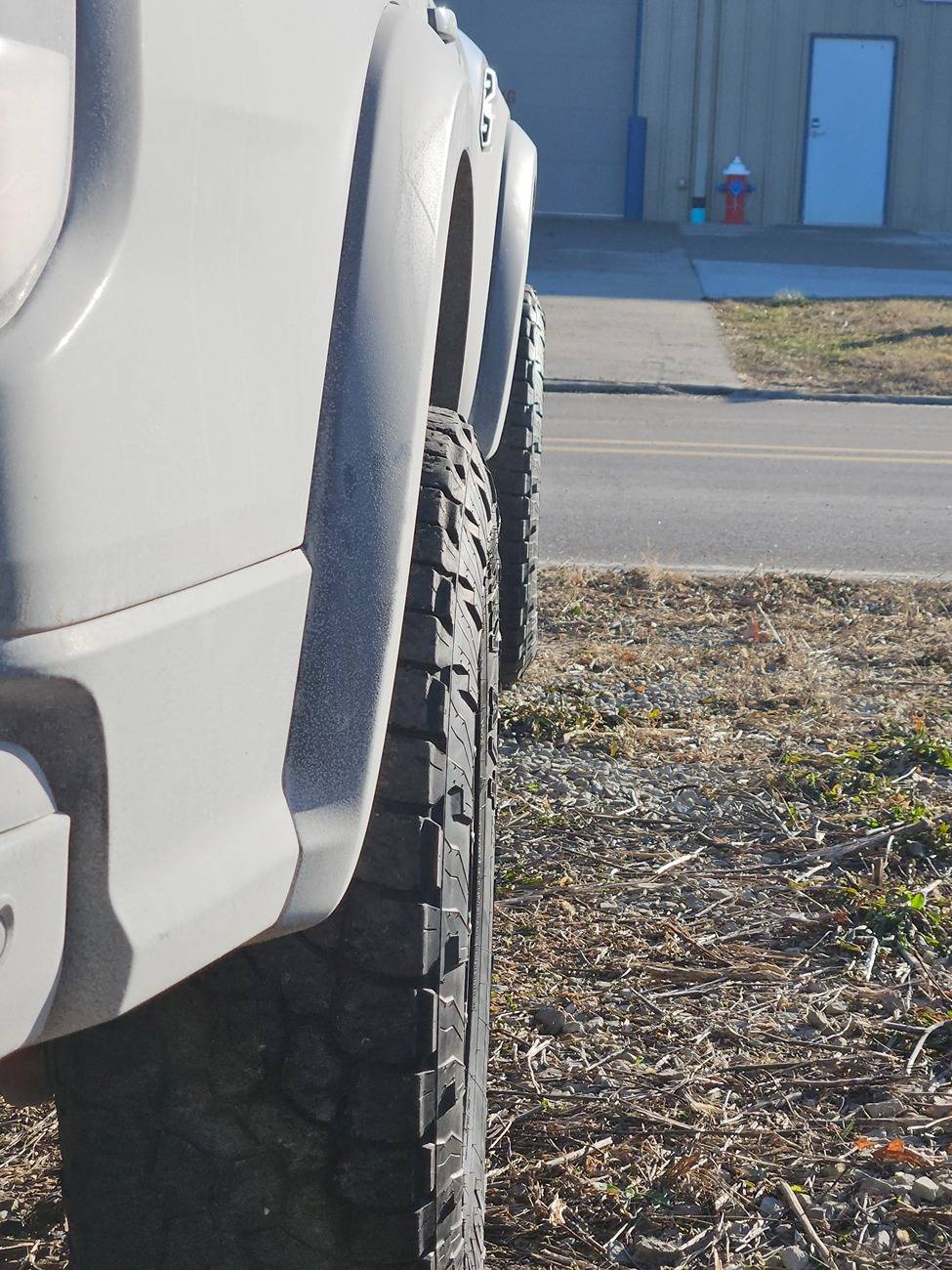

Well I have a set of 18×9 +18 ET wheels with 275/65 R 18'S on it currently. And the stock wheels with the 1.2 space should measure out ~25mm offset so MAYBE 7MM more tucked under the wheelwell.
Ford Ranger Wheel Spacer depth? 1000003217

Thank you. So it sounds like a 1.5 would work for me to get the tiniest bit of poke.
Which spacer brand did you go with? And did you need to get or replace any other hardware?
Also, hope you're well! Seeing your RR outside the ice cream place in Snoqualmie was the final push I needed to go get myself one last year!
Just about flush
