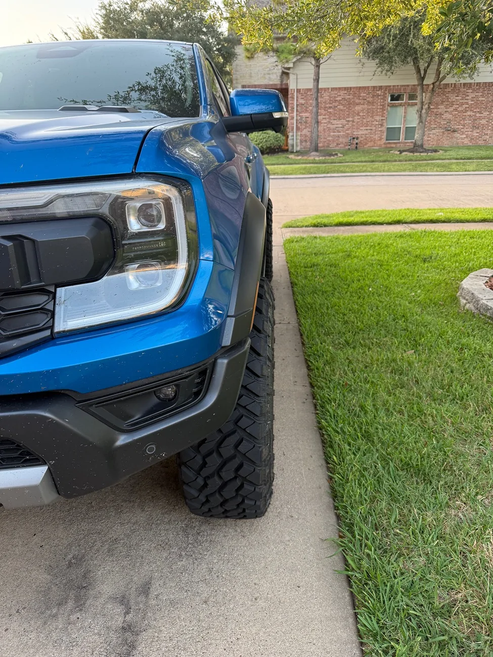

Stock is 17x8.5 with 285 width = 11.2 ... so agree the 11.5 on 9" will fit better.
Also, 17x8.5/+25 to +30 offset with with 285s are perfectly flush, so be aware 20x9/+12 with 11.5s will poke over 3/4"

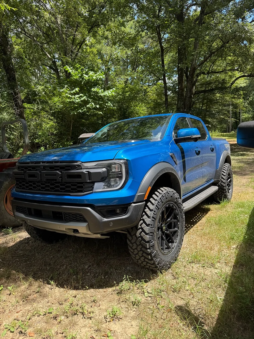

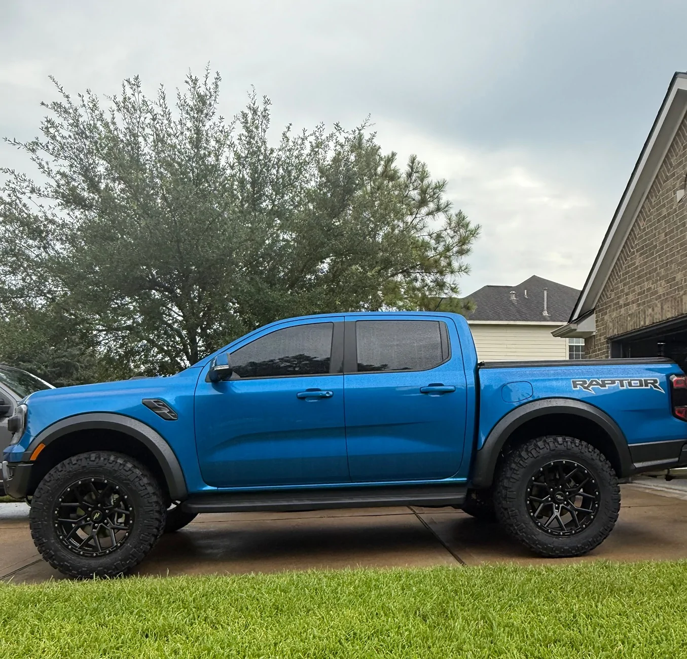

W o W ... Love those - reply with specs, wheels, size, etc, etc thanks Man

Rock Trix 20x9 with -12mm offset and Nitto trail grapplers, 35x11.5

What is your take on the Rock Trix wheels so far? They are a lot more affordable than Method wheels, but that scares me too.

Yeah I really wanted some Fuels just couldn’t find the style I wanted. I drive 100 miles round trip to work everyday and have had zero issues with mine. Can’t say I regret buying them in the least.
