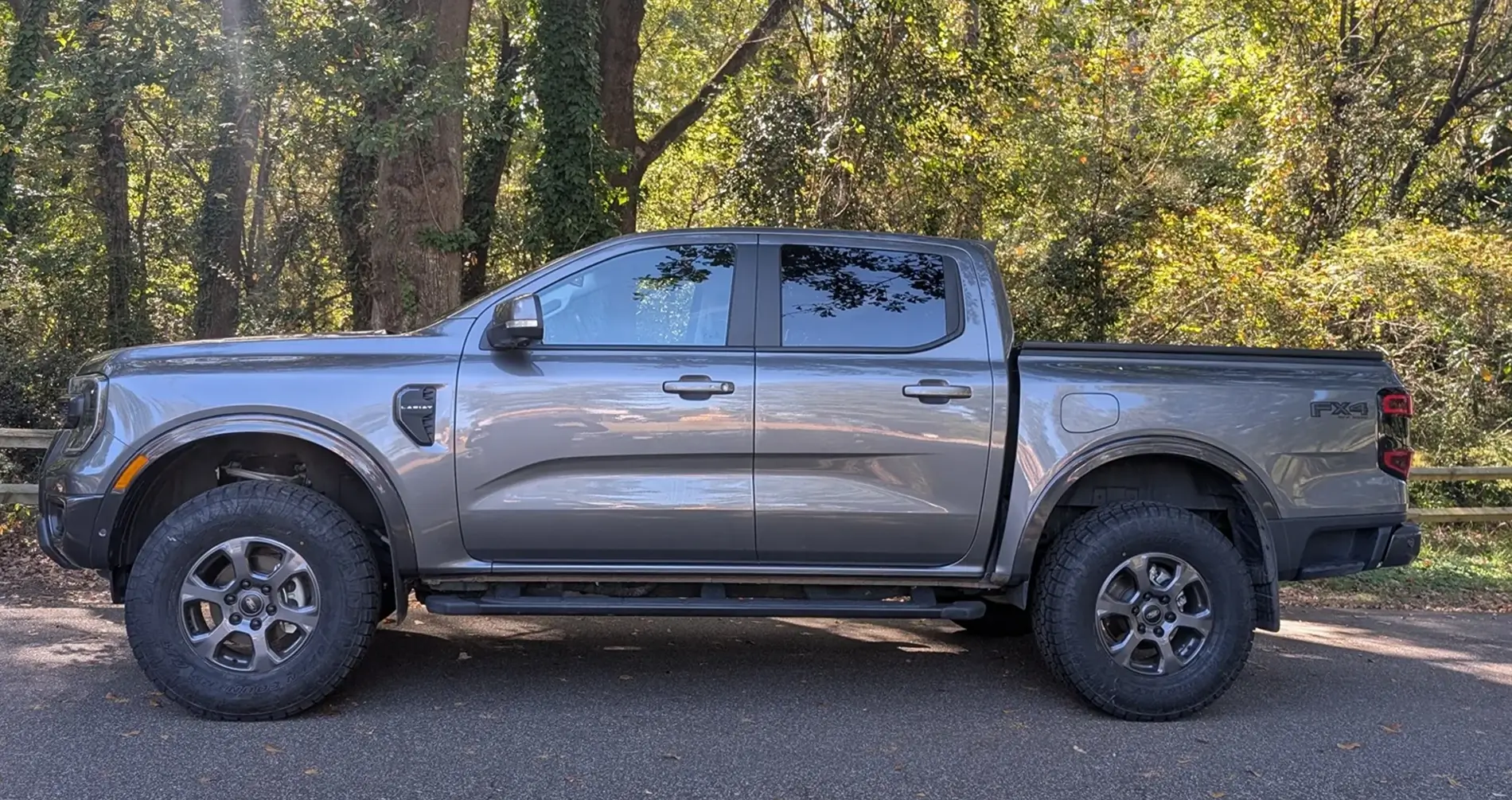

Any issues changing wheel and tire size?

that's on a Raptor, I have a XLT
That’s not a Raptor its a Lariat the FX4 on the back fender lets you know it’s a regular ranger.
The thread link was just ment to show the thread I found it.
‘The grey truck in the quote I posted is on page 4 of that thread.
yup sorry I just looked at the first photo in the link. However, those are not Raptor rims, those look to be Bronco rims on a Ranger. I was asking about Raptor rims going on stock XLT. And that truck also looks to be lifted?
Yes, they are using a Bronco wheel, but those are the same +55s as the Ranger Raptor wheel and all other 6th gen Ranger wheels.
That tire size on any +55 OE ford wheel would be the same or have the same sort of clearance issues, stance, and look as far as how they fill the wheel wells, that sort of thing.
oh interesting, thanks for the info, make more sense now!
