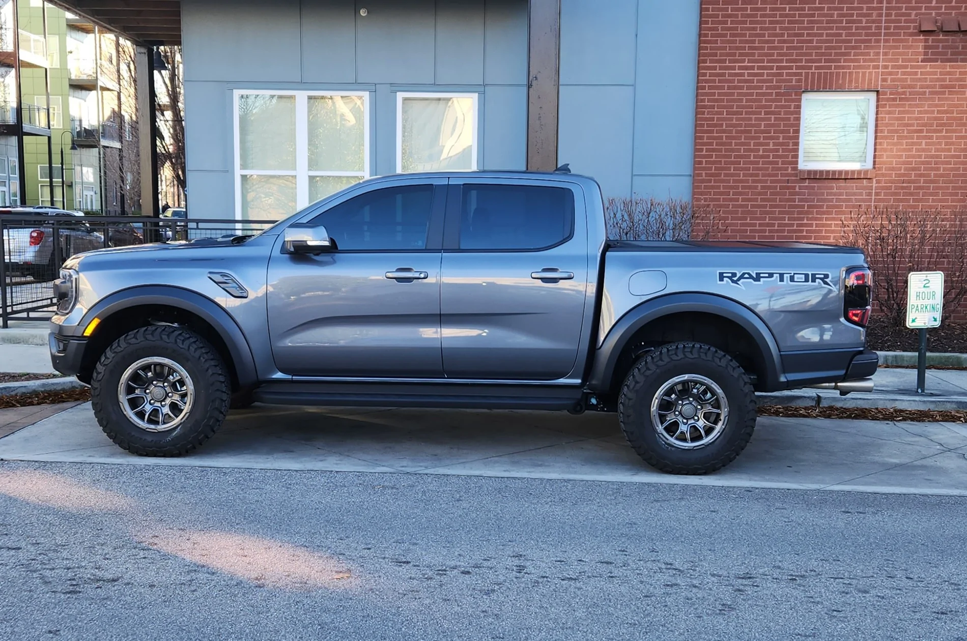

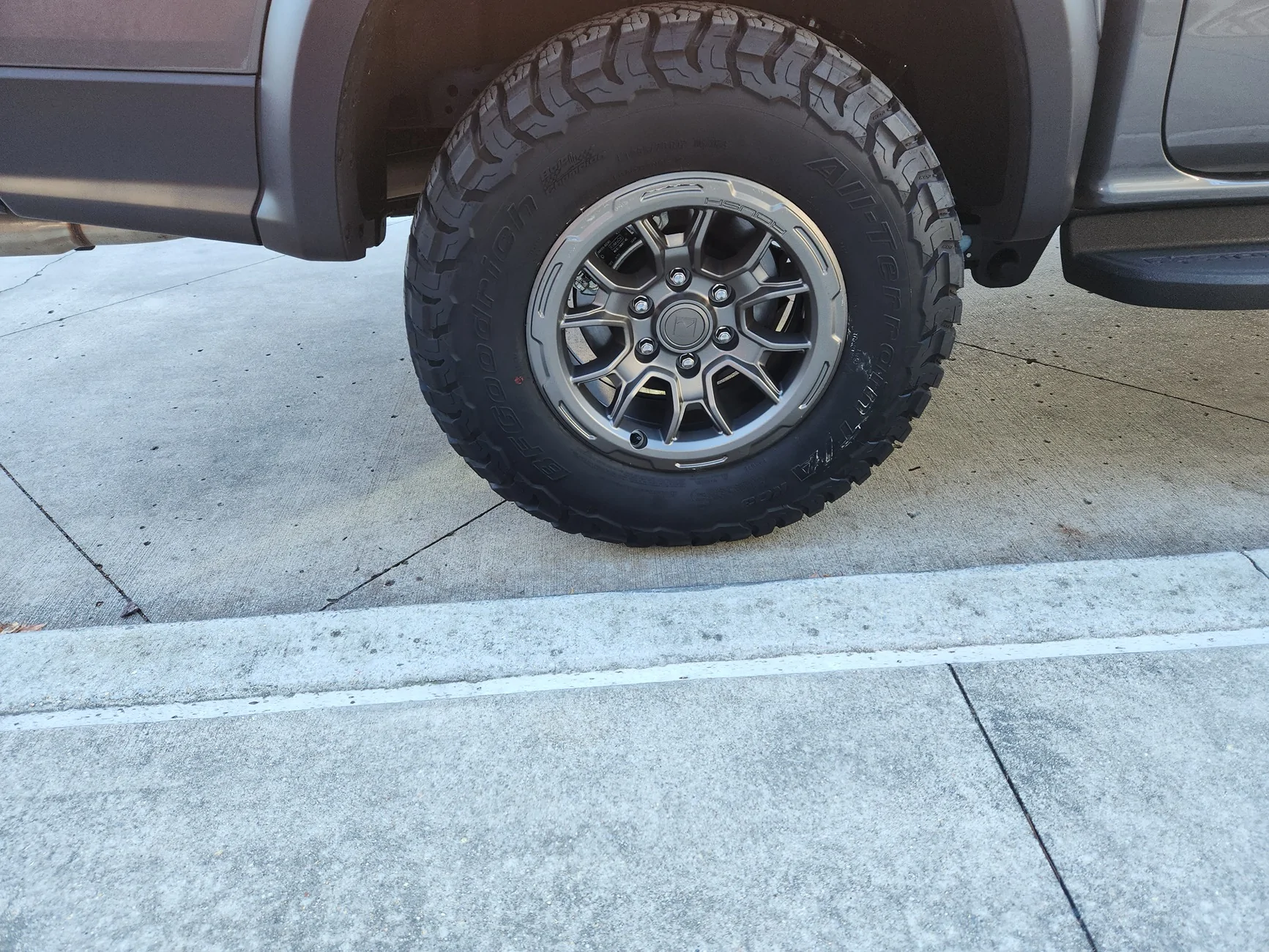

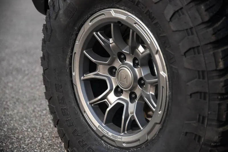

Appreciate the input. Im leaning Roush wheels.
Ford Ranger Any issues changing wheel and tire size? Roush
2,360
3,175
That is a very sharp looking wheel !
I have seen them on several forum members trucks.
ā€˜Great choice!

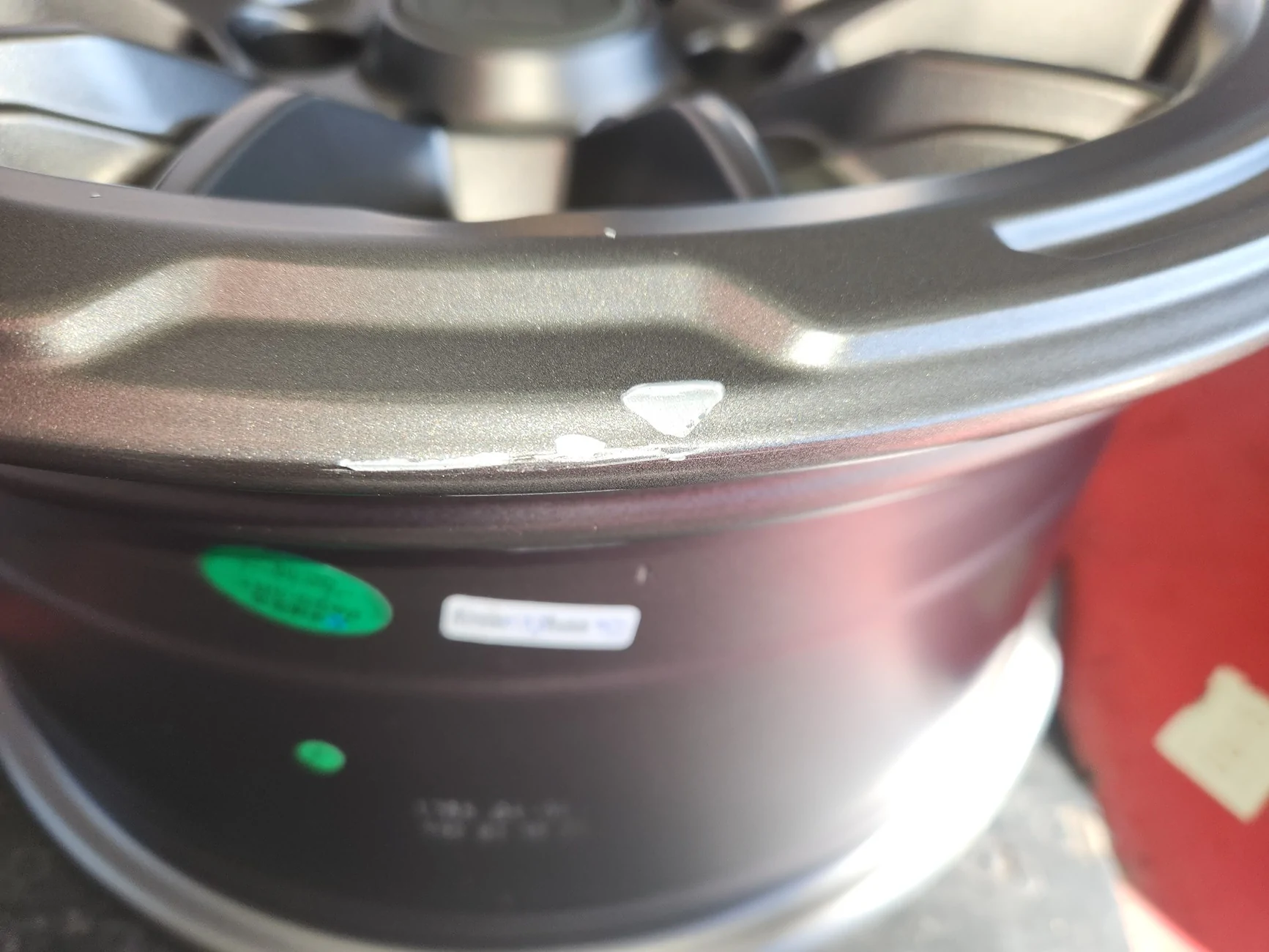

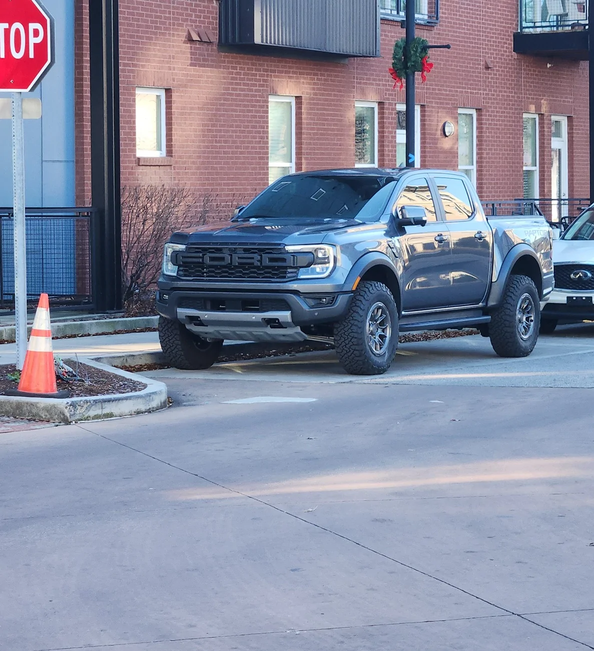

Getting there. One of the new Roush wheels is chipped. Told the installer use that as the spare.
Ford Ranger Any issues changing wheel and tire size? 1000016734
