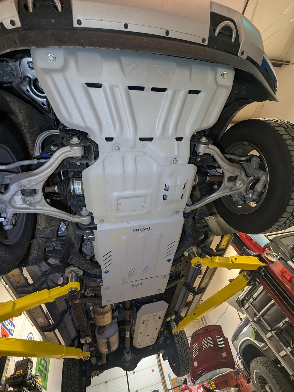

If you're starting out with 2, I'd do radiator and engine and then worry about transmission and t-case later.
I've been happy with all of mine so far even though I haven't tested any of them

Thanks for the photo! I watched your videos too - super helpful!
I think I'm for sure dead set on the engine/oil pan plate, since that one seems most exposed and the port window is a great design feature.
As @CACTUSGREYFX4 mentioned, the transmission pan seems to be tucked away so maybe I can get away without that.
Also thinking about it now, it seems like the bumper sticks down lower than the radiator mount so maybe I'd good to skip that too? Still need to find a photo of how exposed that is, or just wait til I get my own truck and explore
Just a point to consider, the FX4 comes with a radiator and T-Case skid, so Ford seems to think those are 2 critical areas of the truck. That's why I based my call on engine and radiator
