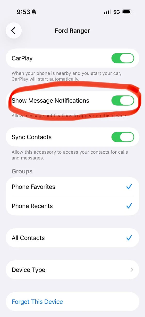

In your phone’s Bluetooth settings, hit the info button next to the truck and look for the “Show Message Notifications” toggle. I think you need that turned on.
I will say mine doesn’t work 100% of the time, but it’s been pretty good once I fixed that.
