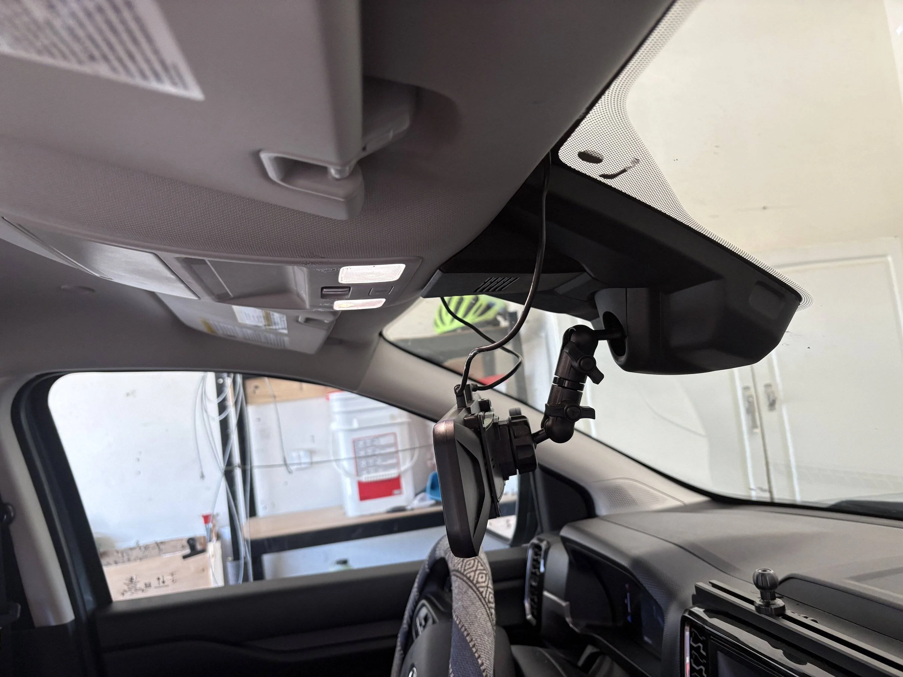

@Wolfbox G900 Tripro Dash Cam bumper version installed. Used bracket purchased from Amazon. waiting on replacement front bumper camera and the clean up wires

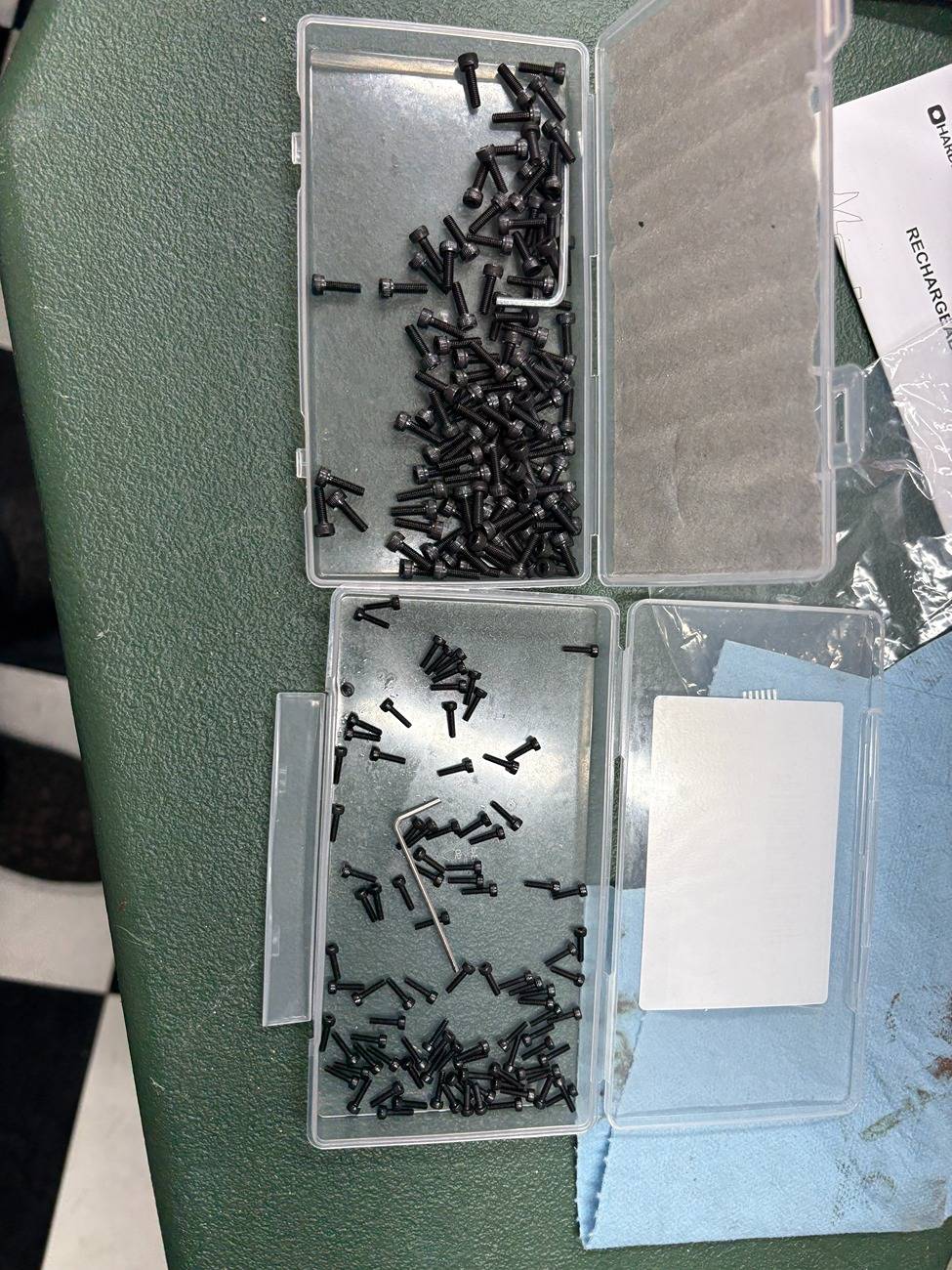

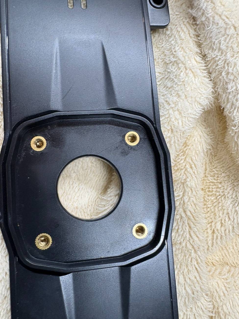

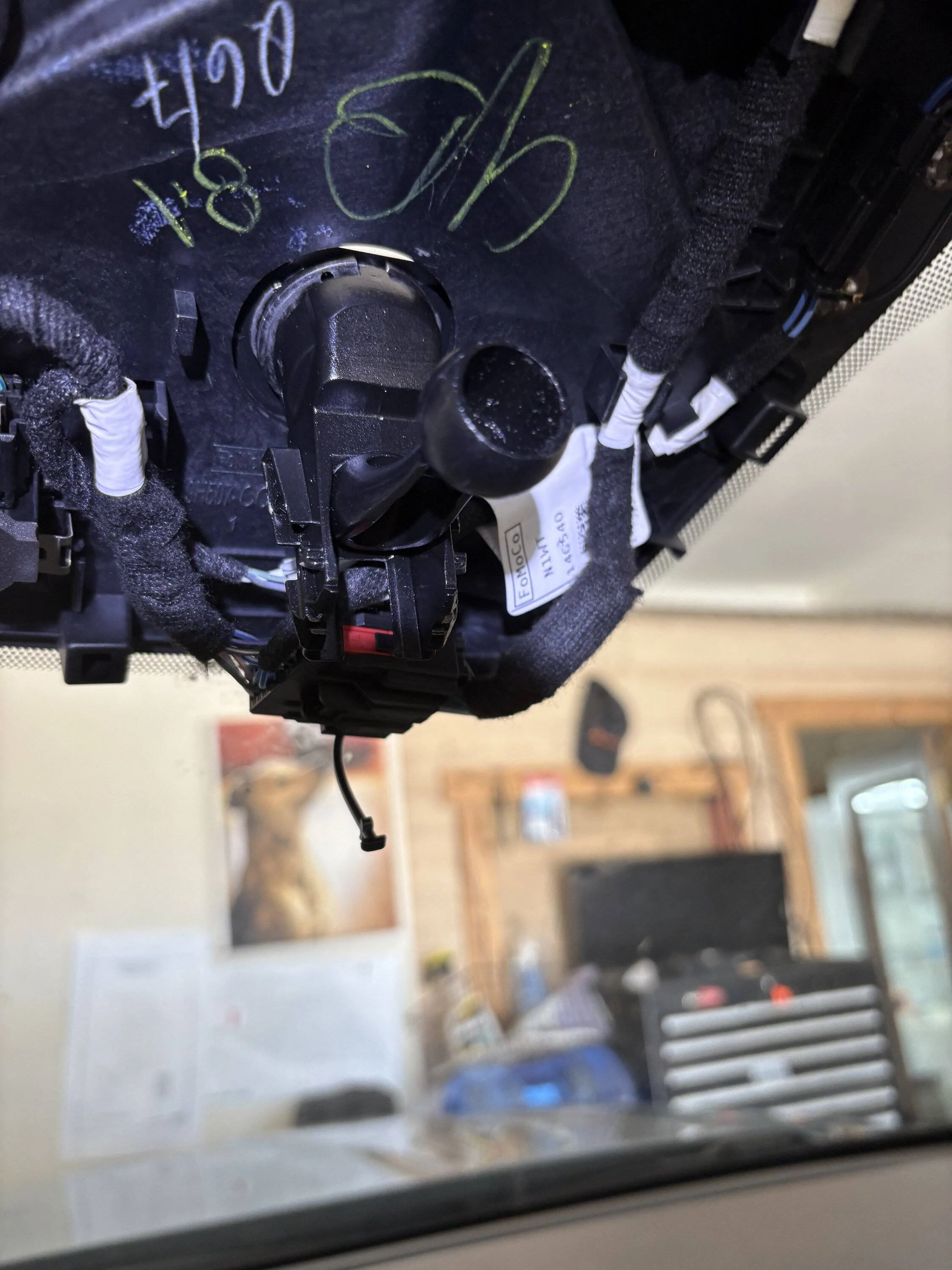

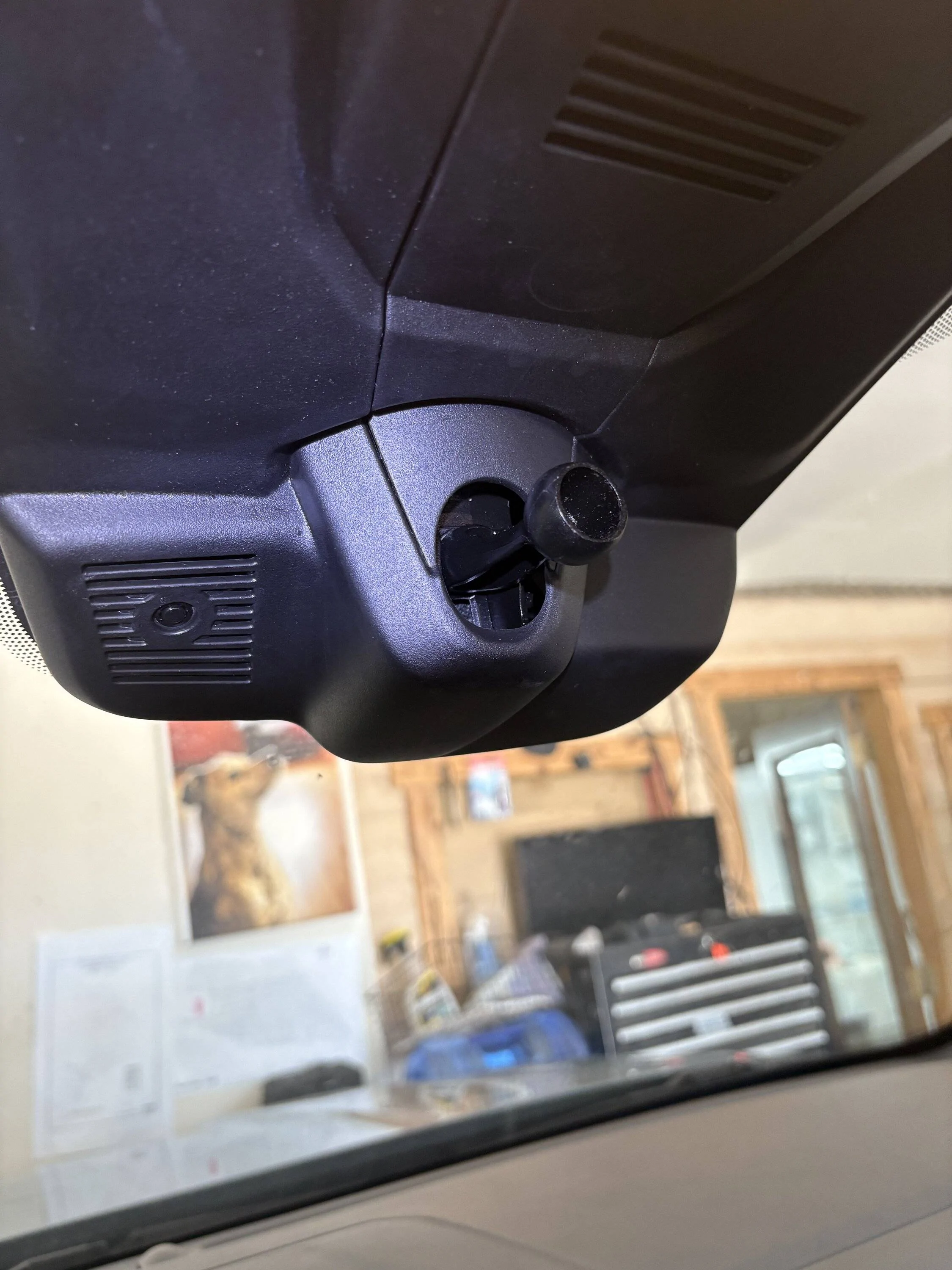

Thanks but I was asking if using that type of mount caused any mirror vibration. I already own a few of them
no vibration I replaced all the screws on the mounting plate drilled those 4 out and ran the threads completely through. Got longer screws that attach this mounting plate to the mirror. I have way more than I need you pay postage I'll send you 4 of each.
