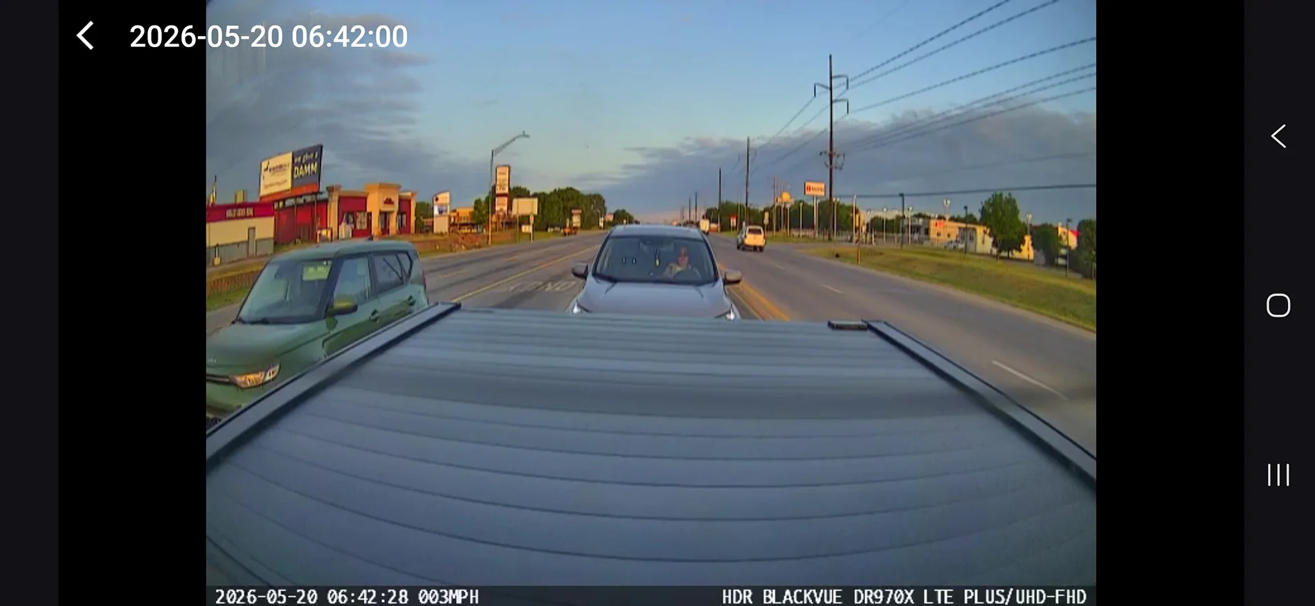

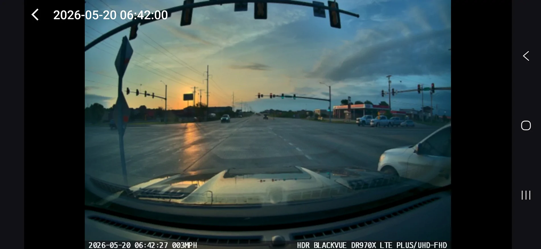

The bracket works surprisingly well. I had to bend it slightly by hand to get it away from the window, otherwise when the window slides open and shut, it would rub. The exact spacing isn't very far from the window. No camera shake at all and only slight fish eye distortion on the edges (see below). The only thing I don't like is not being able to see directly behind the tailgate. But that would require an exterior camera behind the tailgate.
Front
Ford Ranger Getting camera wire from front to the back window for dash cam Screenshot_20260520_075946
Rear - Excuse the slight tilt, just moved daughter home from college for the summer and camera got knocked a little - since the bracket is only wedged and not screwed in or attached with adhesive, it can be moved fairly easily, either purposefully or accidentally. Only time that's an issue for me is if the back seat is full of stuff/boxes all the way to the top and they slide around enough to contact the camera. But can be easily adjusted back.
Ford Ranger Getting camera wire from front to the back window for dash cam Screenshot_20260520_075930
