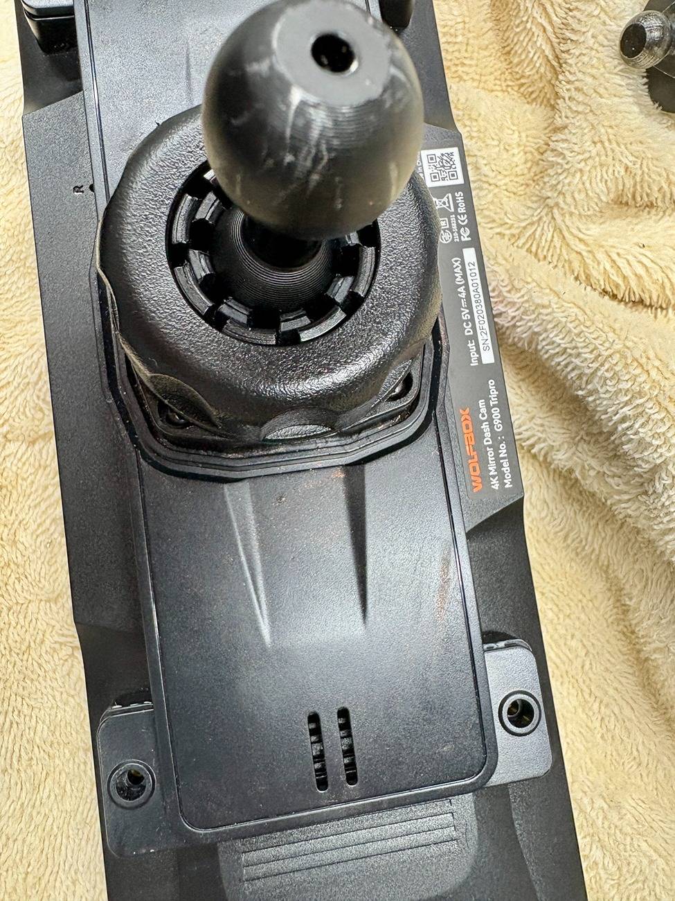

@Gerry Bourret can you take a picture of how that works? i see the amazon ad but it doesn't show anything but which mirror it fits and a bunch of parts so i don't know what that actually does
Gerry Bourret
Gerry
Sep 10, 2024
47
Indio,CA
2024 ford ranger XLT,off road and towing package
you select an insert that fits what you are trying to attach to takes some playing around to find the best fitting

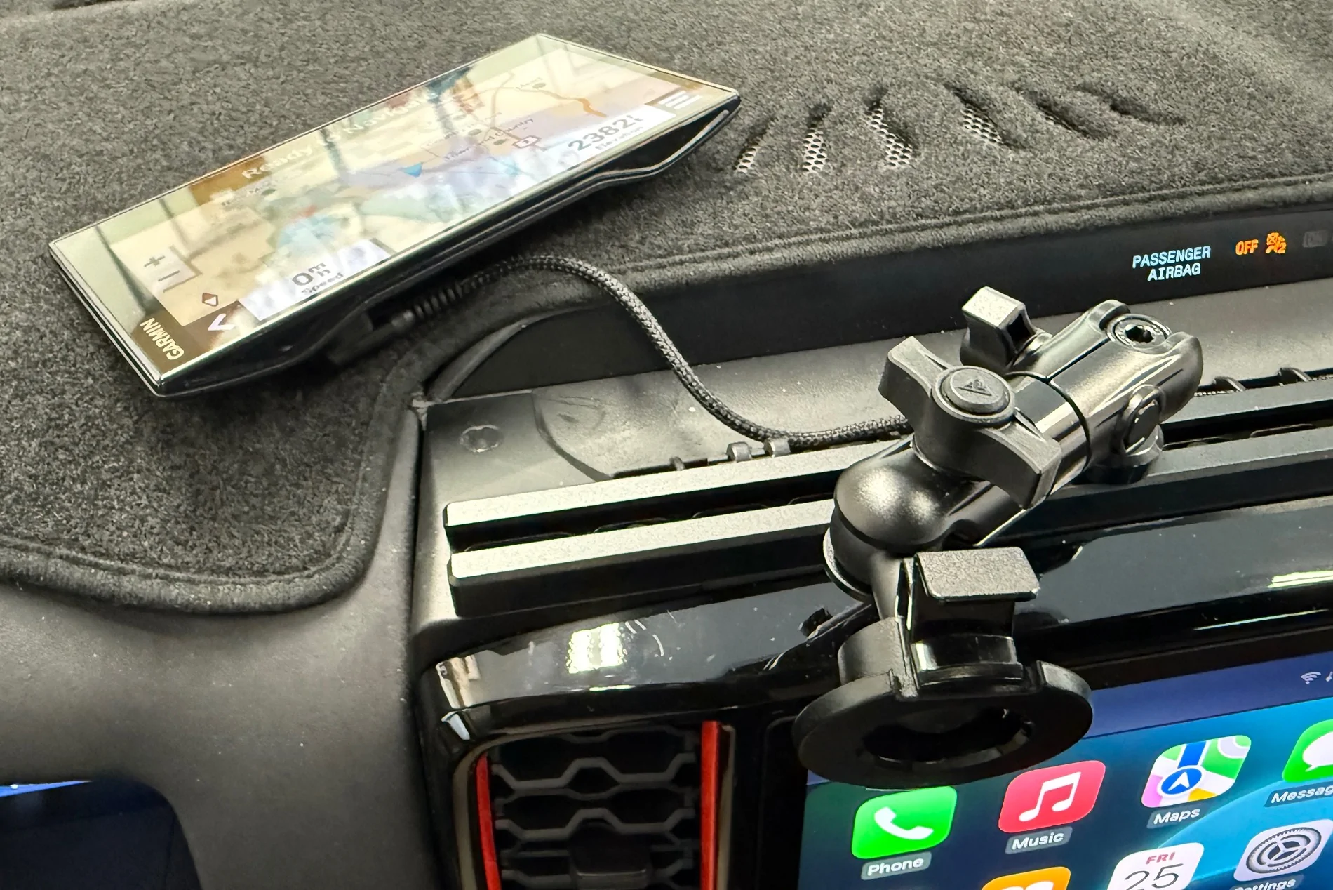

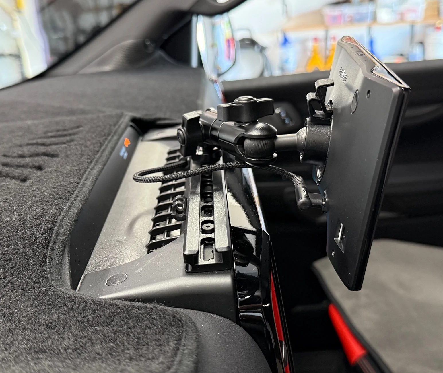

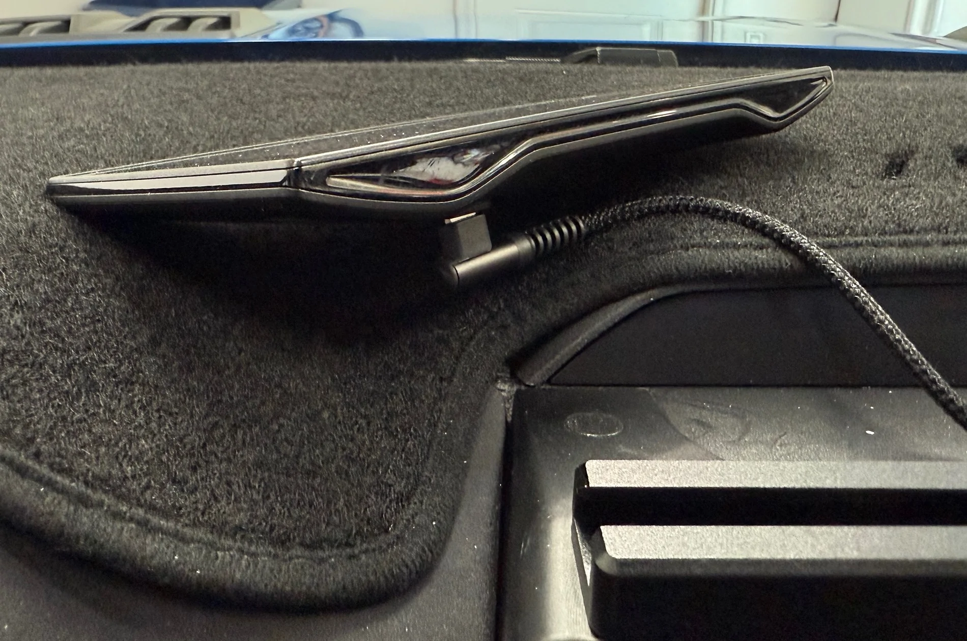

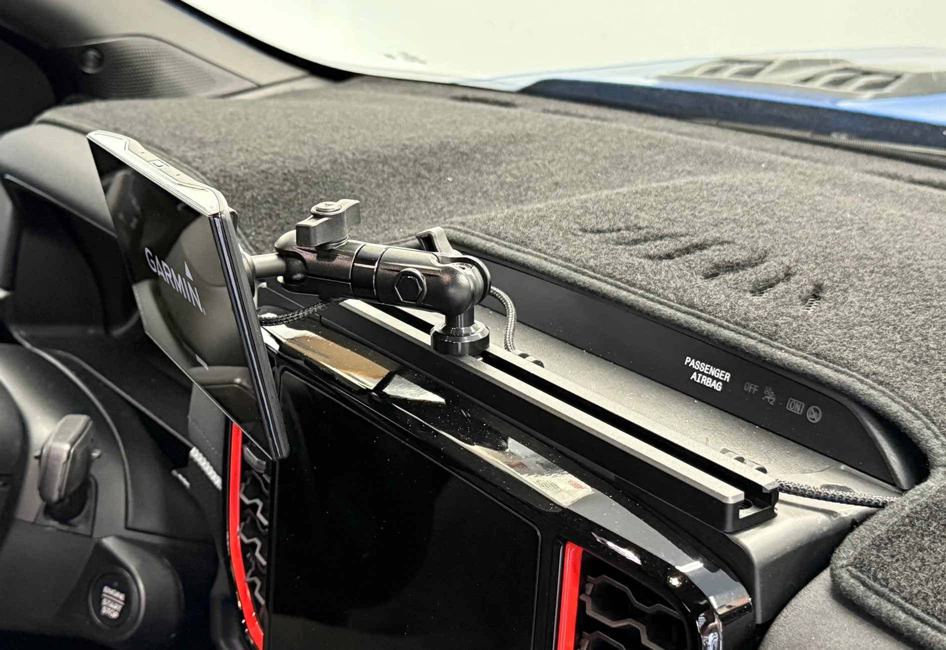

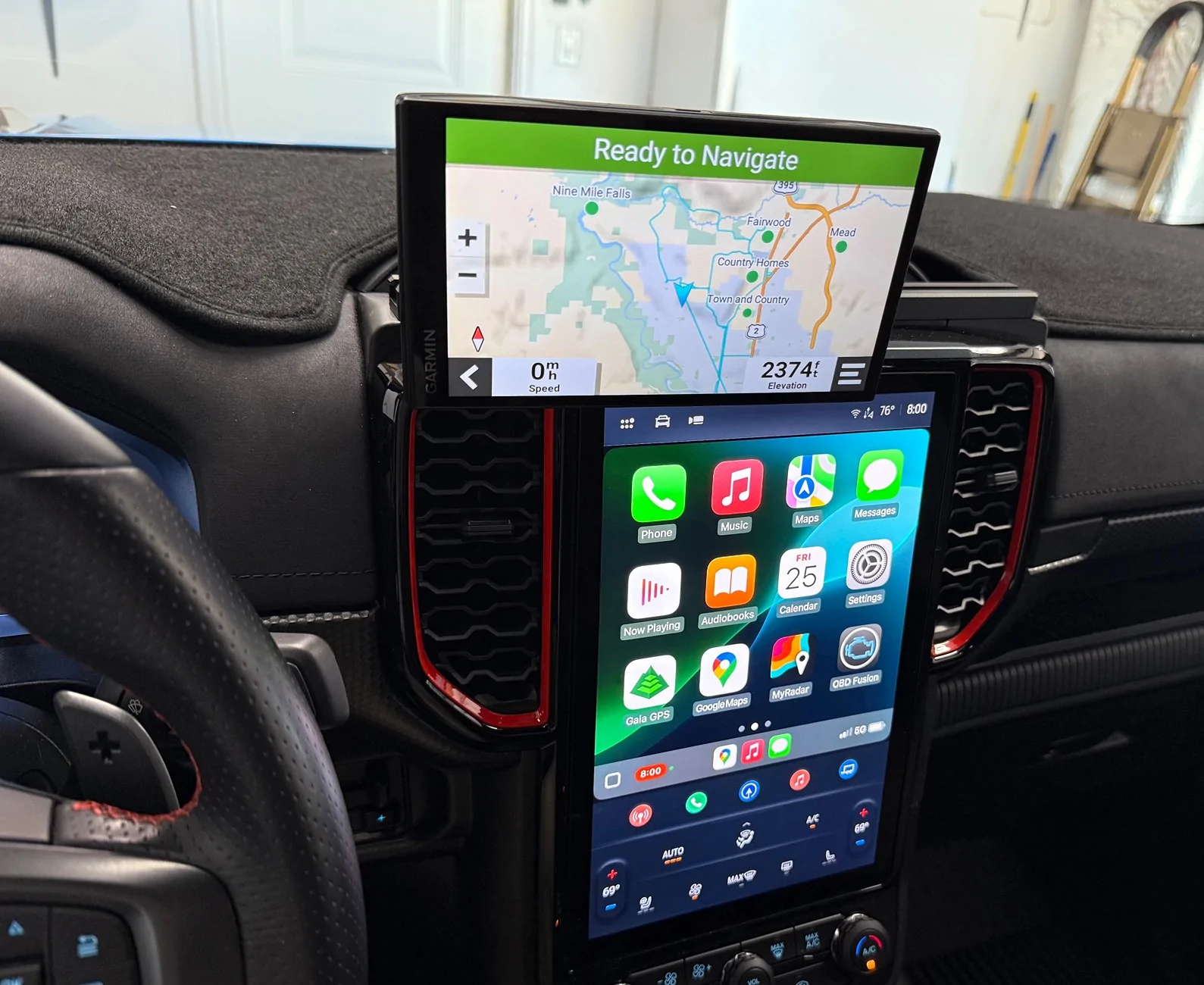

Here is mine, for my Garmin DriveSmart 76 ... one hint, you may need a right angle drill attachment to drill the two holes, my Dewalt 20V driver did it, but just barely. It hits the glass.
I used a 20mm to 17 mm "dog bone" adapter from Amazon, see Post 38. This setup works beautifully and is rock solid. I position the gps so the airflow from the left vent just catches the bottom, that cools the Garmin battery nicely (It gets toasty otherwise, and can shut itself down!) I can still see the entire big display. My only problem is finding a way to turn of the USB C power, it is a pesky problem and I am looking for a fix:

How'd you route your wires?
John E Davies
May 26, 2024
71
845
1,189
Spokane WA USA
Retired aircraft tech
A 10 foot USB C to USB C cable, plugged into the RR upper socket under the main console display.. It goes from there under the glove box, up the right door A pillar weatherstripping, then across to the gps. It is just lying under and almost completely hidden by my dash matt. It works OK except for the problem I mentioned in my post. I have to keep it unplugged all the time, unless I am actually using it.

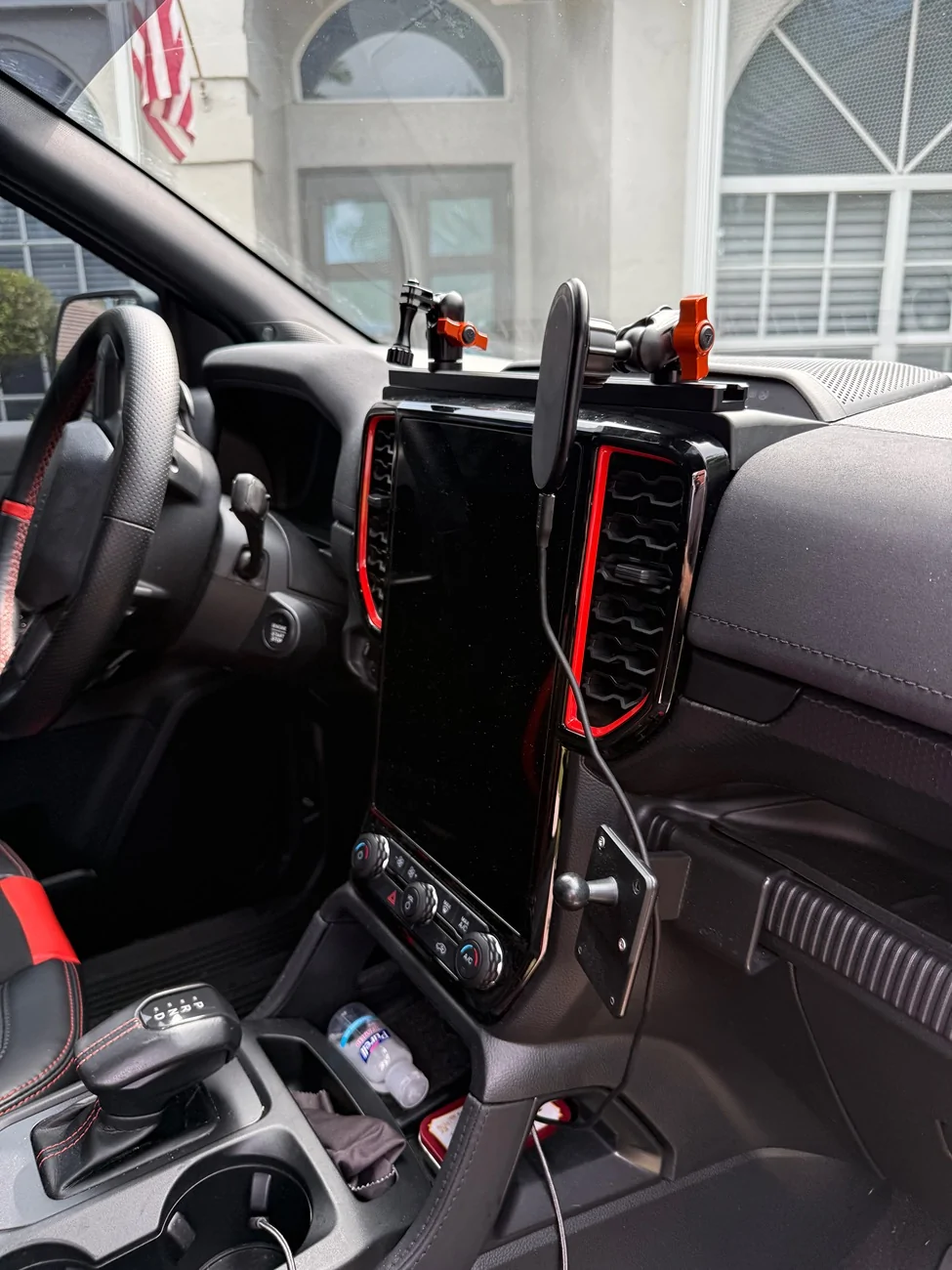

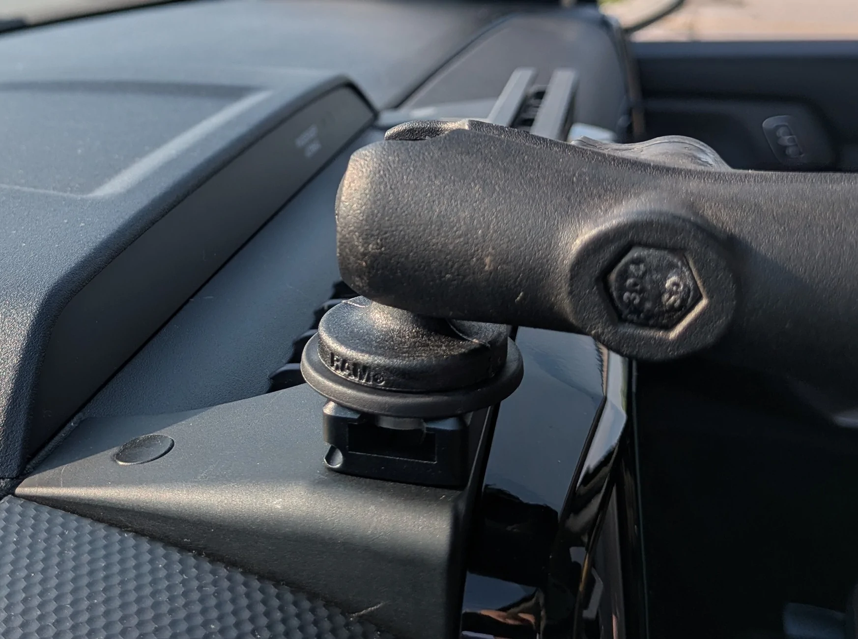

I just installed in my Ranger, really pleased with the fit and quality of the Tackform mount.
For those wondering about comparability with Ram mounts, I'm using a Ram 1"/B size track ball mount (RAP-B-354U-TRA1)
https://a.co/d/gxBalXE
It's not a perfect fit, the base is a bit wider than the top of the rail, but seems to work alright. I have several Ram components in different vehicles and equipment and wanted to maintain interchangeability.
It would be nice if Tackform would offer a 1"/25mm ball for the slim track.

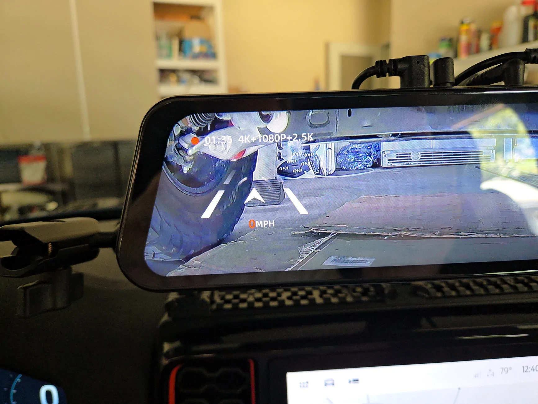

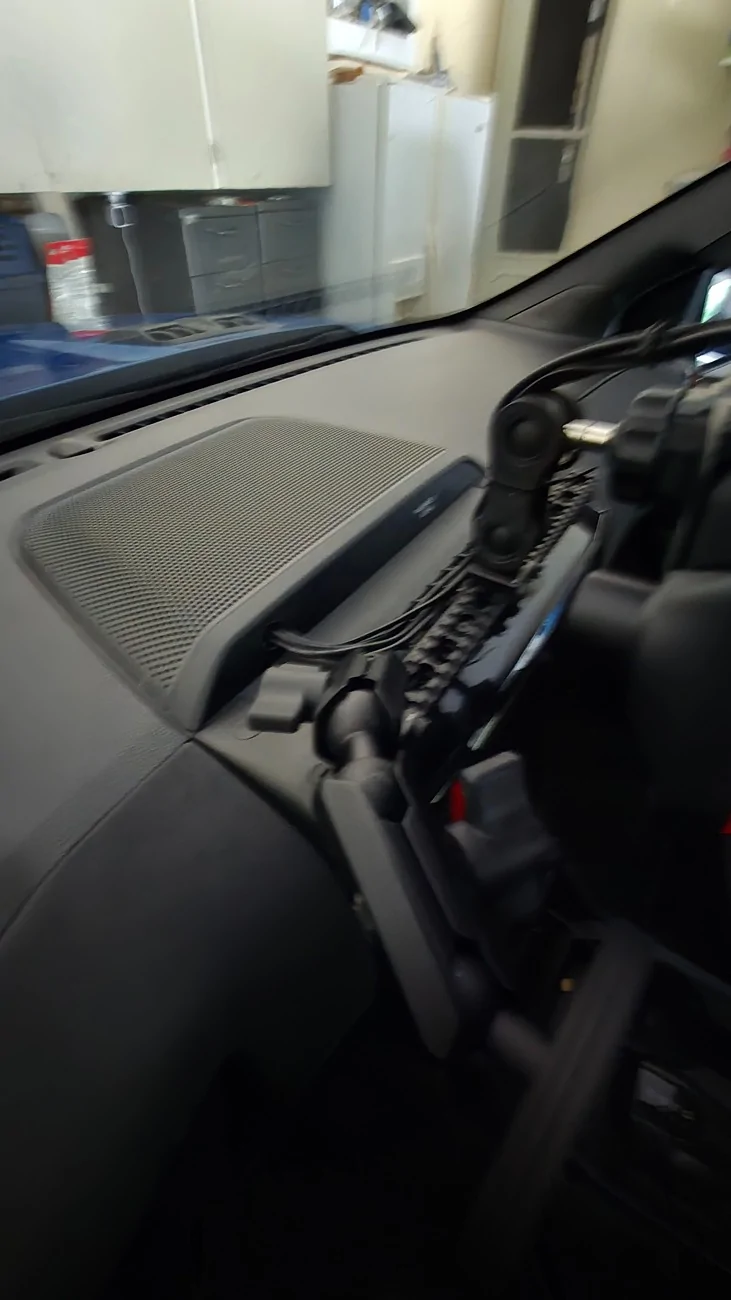

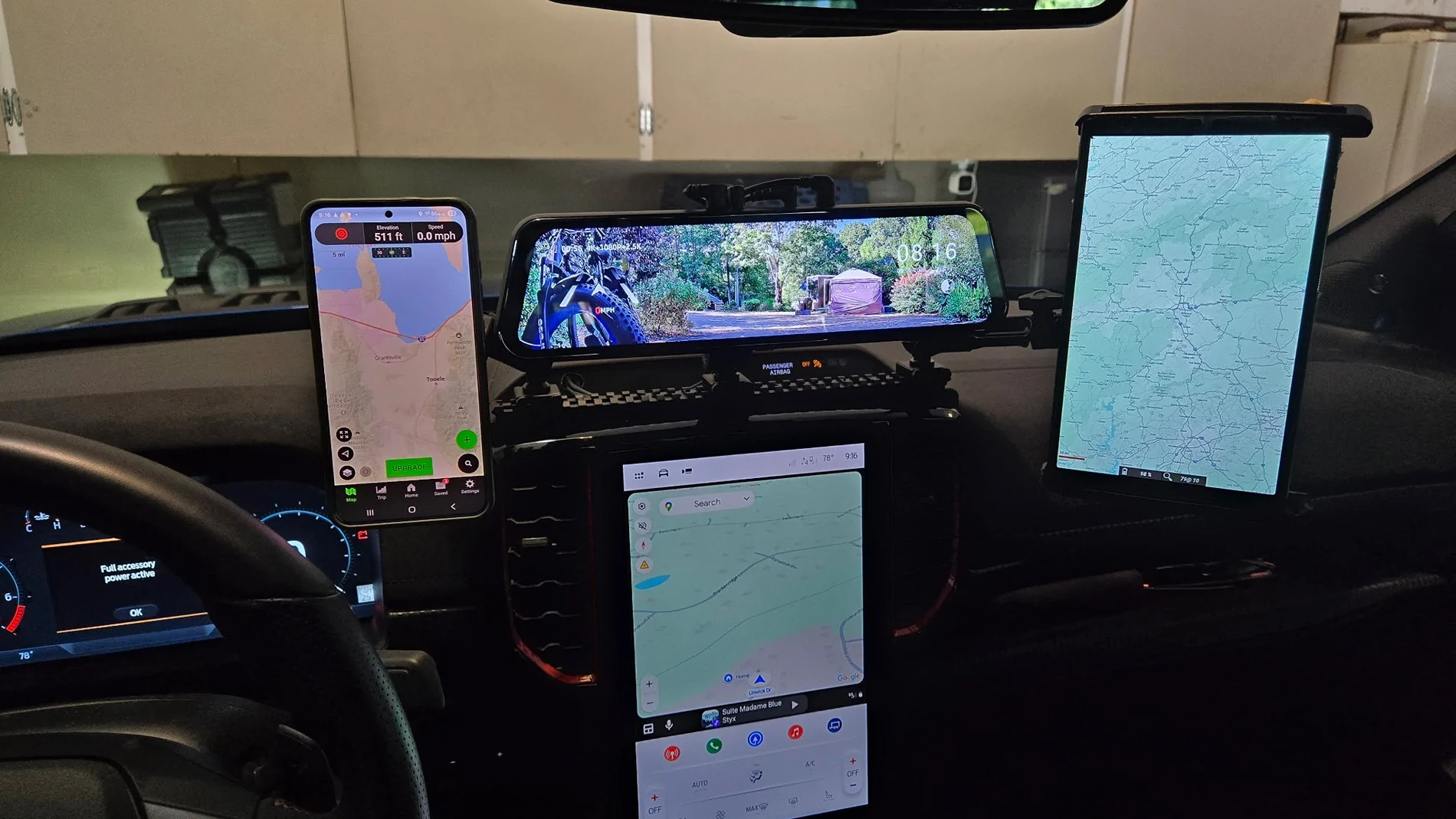

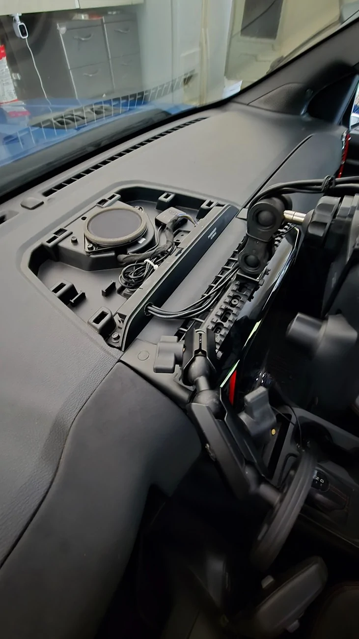

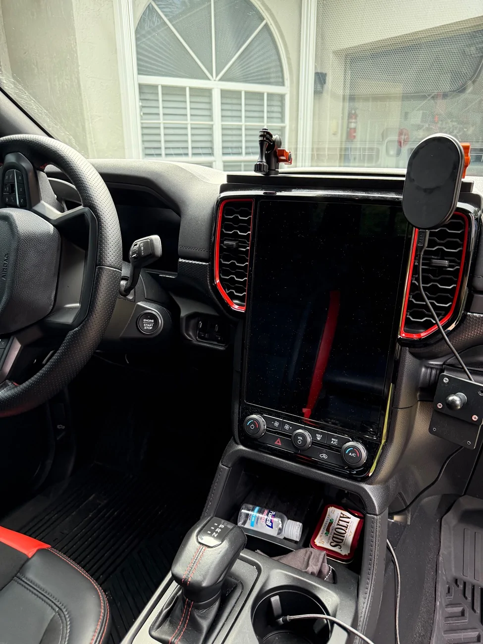

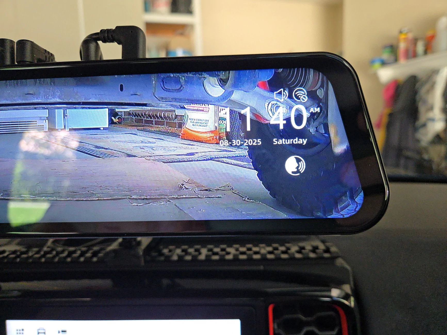

For those looking to run power or other cables to the middle of the dash. I was able to pop the center speaker grill and then pop the center speaker out. From there I ran a thin fiberglass rod down the hole angled towards the gas/break pedals. Its tight with all the vent tubes and other things but it's possible. From there I taped a usb c and three other cables for the wolfbox's 3 cameras and GPS cables and pulled them up to the speaker hole. Then drilled a hold to the left of the front panel that has the seat belt connections. I still need to get a piece of 1/2 inch wire loom to go over all the cables then feed into the drilled hole to give it an extra clean look.
Ford Ranger Tackform TRAXX Dash Mount Install 1000036324
Ford Ranger Tackform TRAXX Dash Mount Install 1000036311
Ford Ranger Tackform TRAXX Dash Mount Install 1000036312
Ford Ranger Tackform TRAXX Dash Mount Install 1000036099
Ford Ranger Tackform TRAXX Dash Mount Install 1000036098
