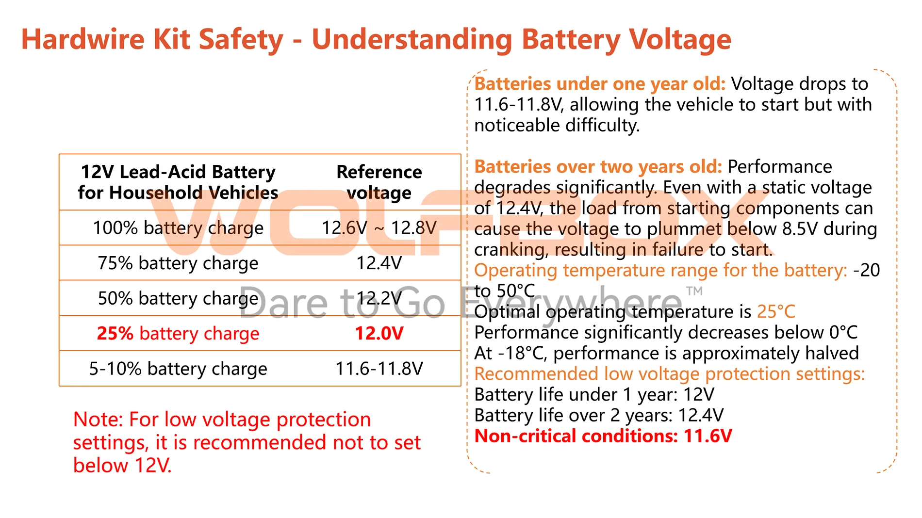

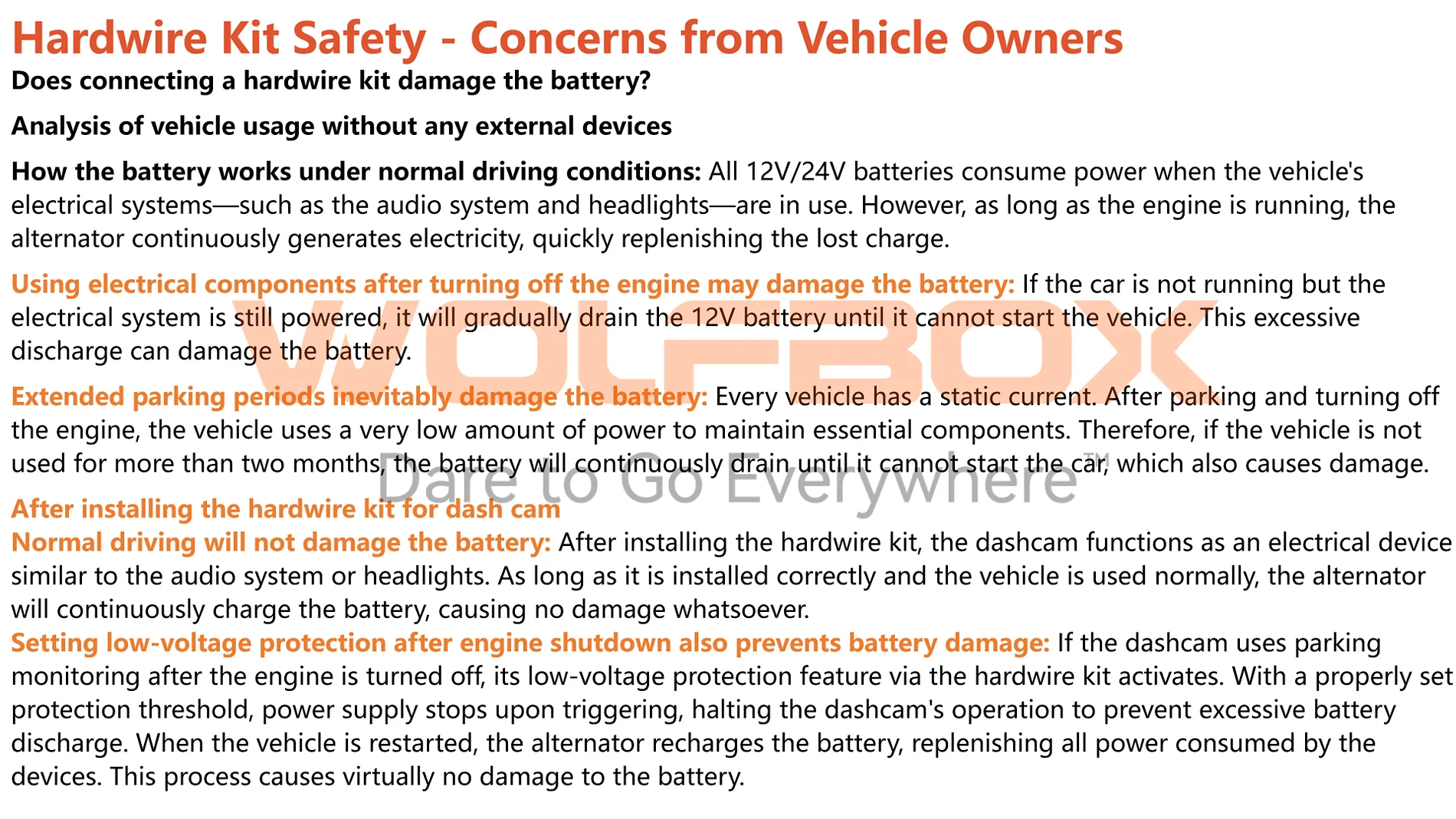

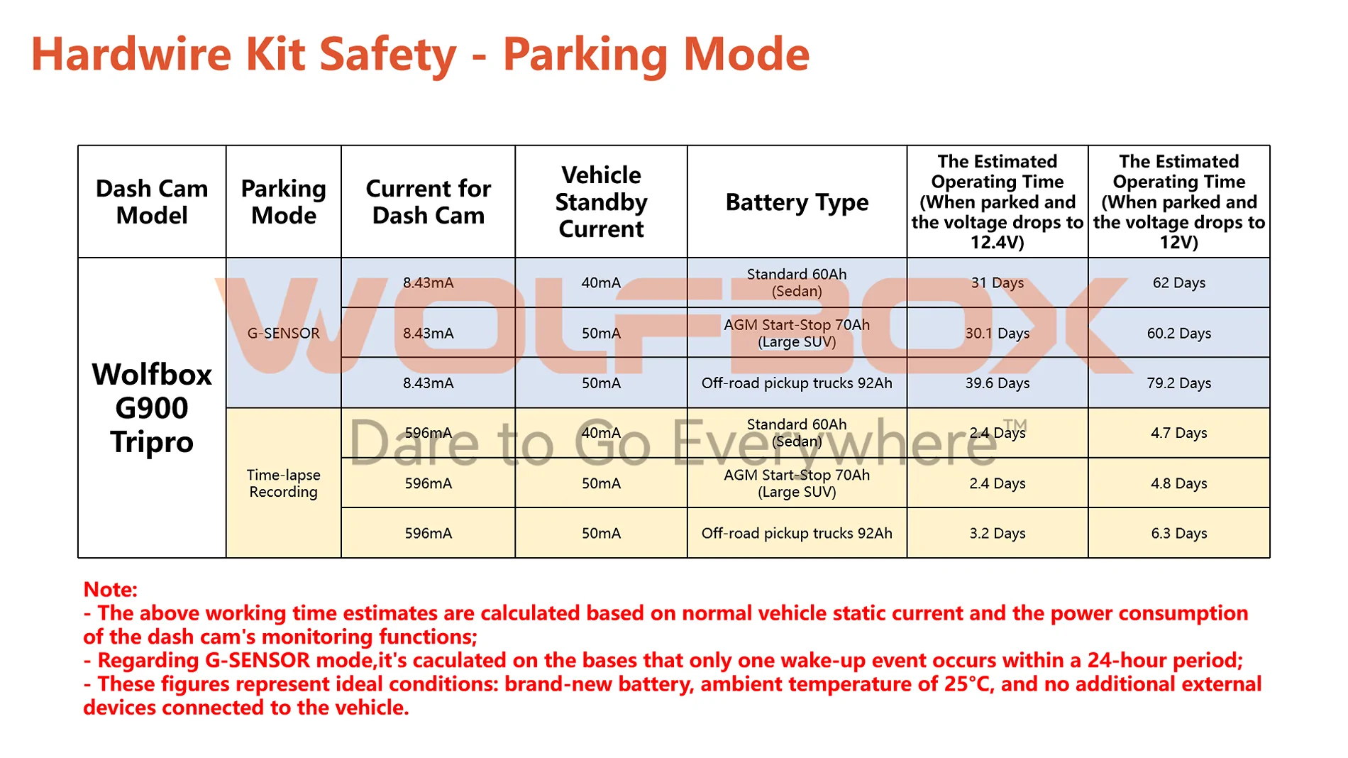

Hello,
We’re back with Part 2 of our series on hardwire kit and installation! In this post, we’ll dive deeper into the topic. If you’ve already read Part 1, you’re well on your way to mastering the basics—now it’s time to build on that knowledge.
Make sure to read through this guide carefully, as it’s packed with valuable insights to help you achieve a smooth and safe installation.
As always, stay tuned for Part 3, where we’ll continue sharing more advanced tips and tricks to help you make the most of your Wolfbox setup!
