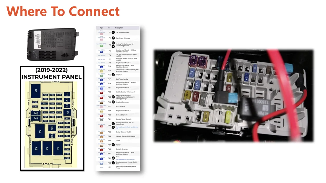

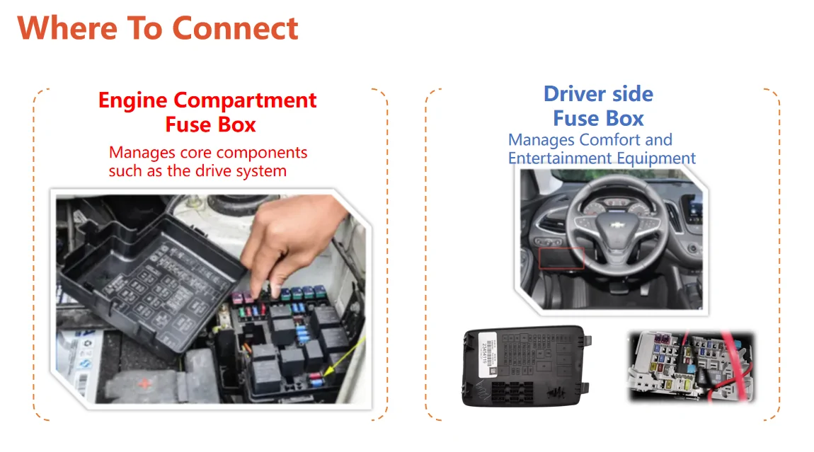

Every vehicle is unique! Fuse box layouts can differ not only by make and model but also by year. To ensure a smooth and safe installation, it’s crucial to carefully read your car’s manual and understand your specific fuse box setup. This step is vital to avoid unnecessary complications and to protect your vehicle’s electrical system.
Pro Tip from Wolfbox:

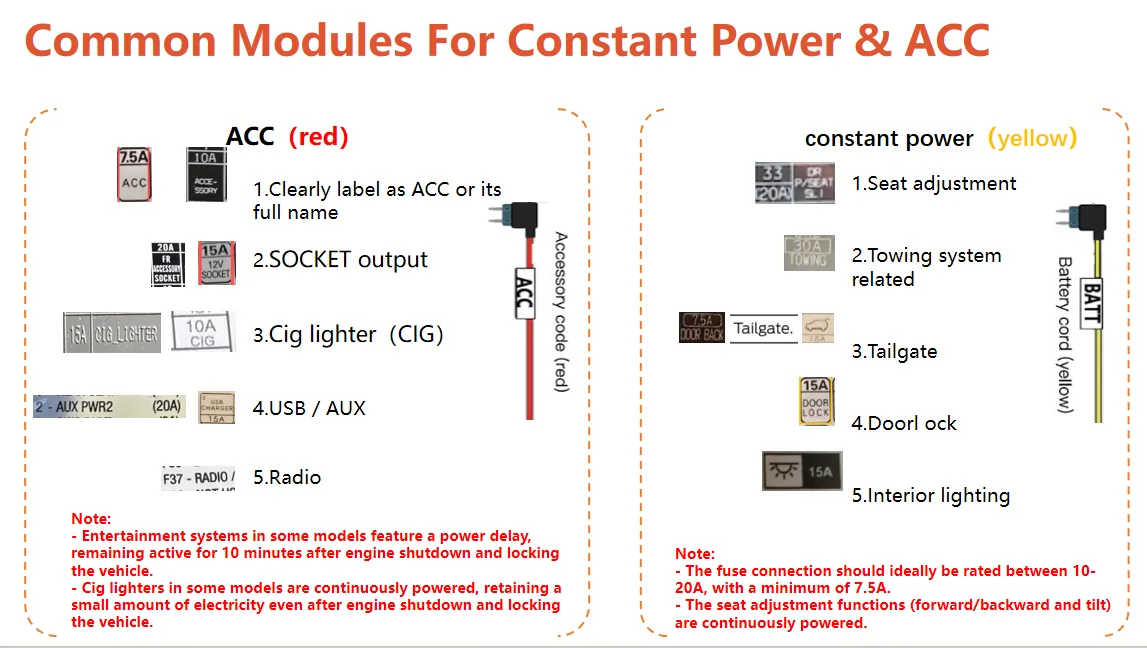

When working with your vehicle’s fuse box, double-check the amperage rating of the fuses you’re tapping into. Never replace a fuse with one of a higher rating, as it may lead to electrical issues or even damage your vehicle’s systems.
Ford Ranger Wolfbox: Knowledge on Hardwire Kit and Installation [Part 4] hardwire1
Ford Ranger Wolfbox: Knowledge on Hardwire Kit and Installation [Part 4] hardwire2

Ford Ranger Wolfbox: Knowledge on Hardwire Kit and Installation [Part 4] hardwire4

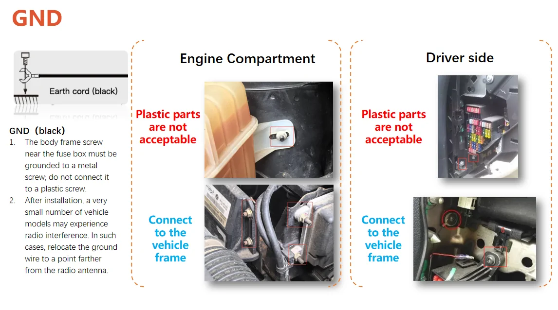

Ford Ranger Wolfbox: Knowledge on Hardwire Kit and Installation [Part 4] hardwire5
