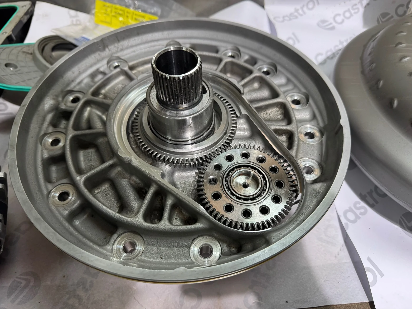

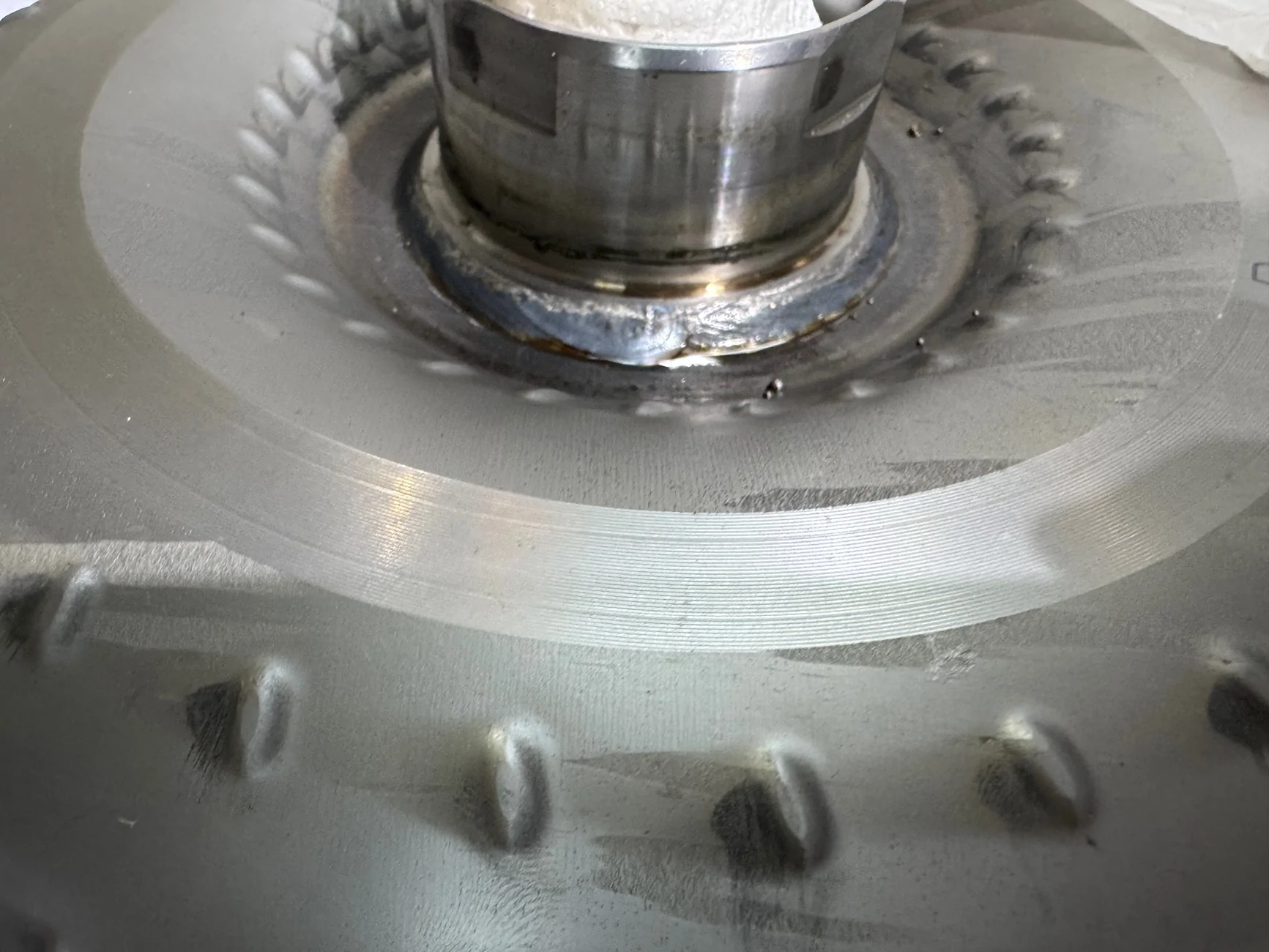

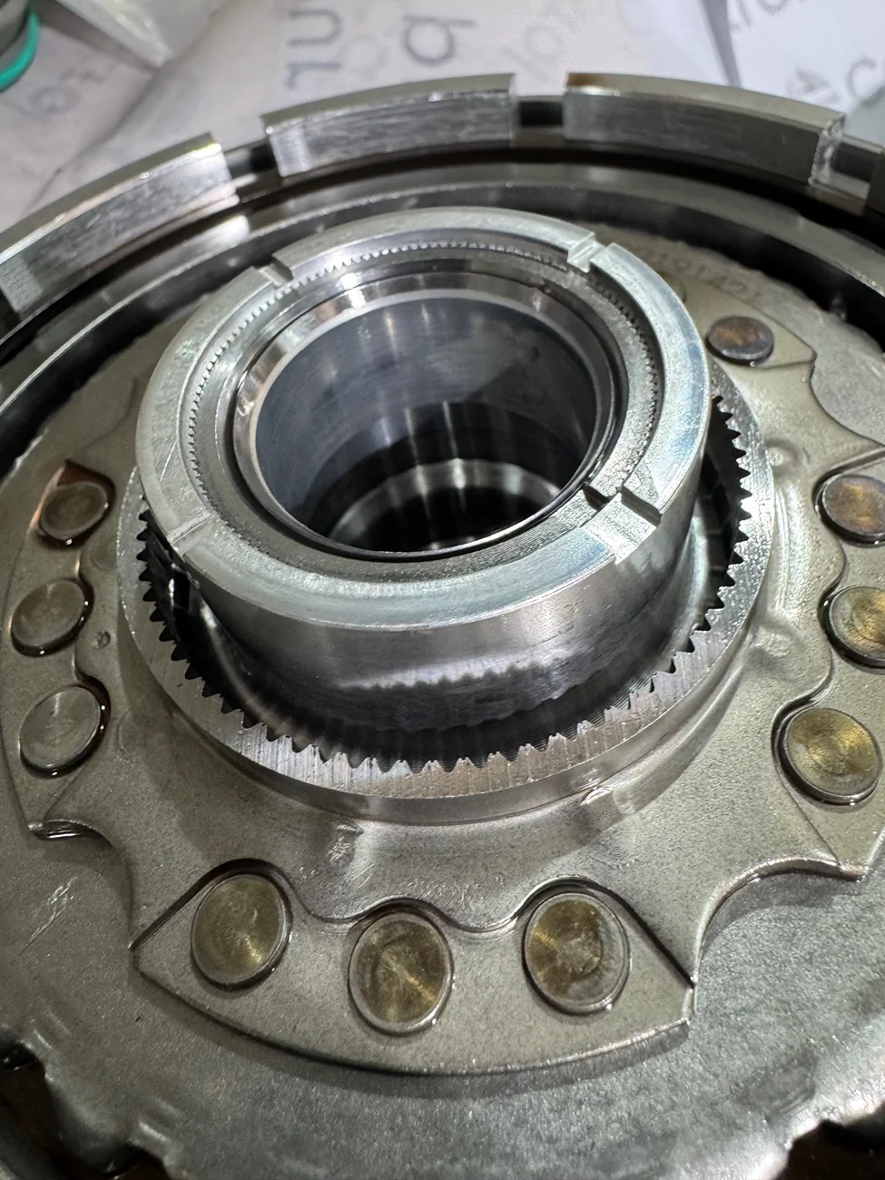

Update:
Apparently the metal grinding noise was coming from the transmission. They replaced the full assembly under warranty (at 52.5k km/32k mi) and the noise it gone.
Not very mechanically inclined, but there was metal-on-metal scoring, worn out bushings, and too much play in the gears.

Wowsers! Glad you posted this and got your ride fixed! My mechanical gene's in looking at the scoring on the torque converter drive and the bushing screams lack of lubrication. I understand that at some point the valve bodies went under a design change for the 10R60 but when is unknown. As lubrication problems can stem from the valve body, the numerous seals, up through all the transmission passages, solenoids, the pump itself or low fluid levels. Time to Ranger on! :like:
