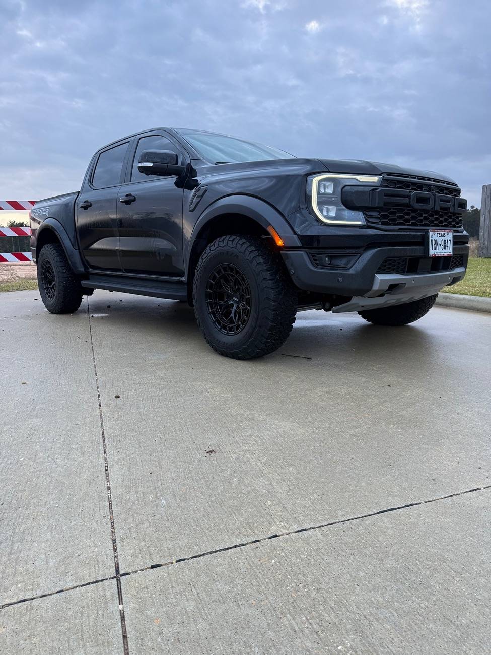

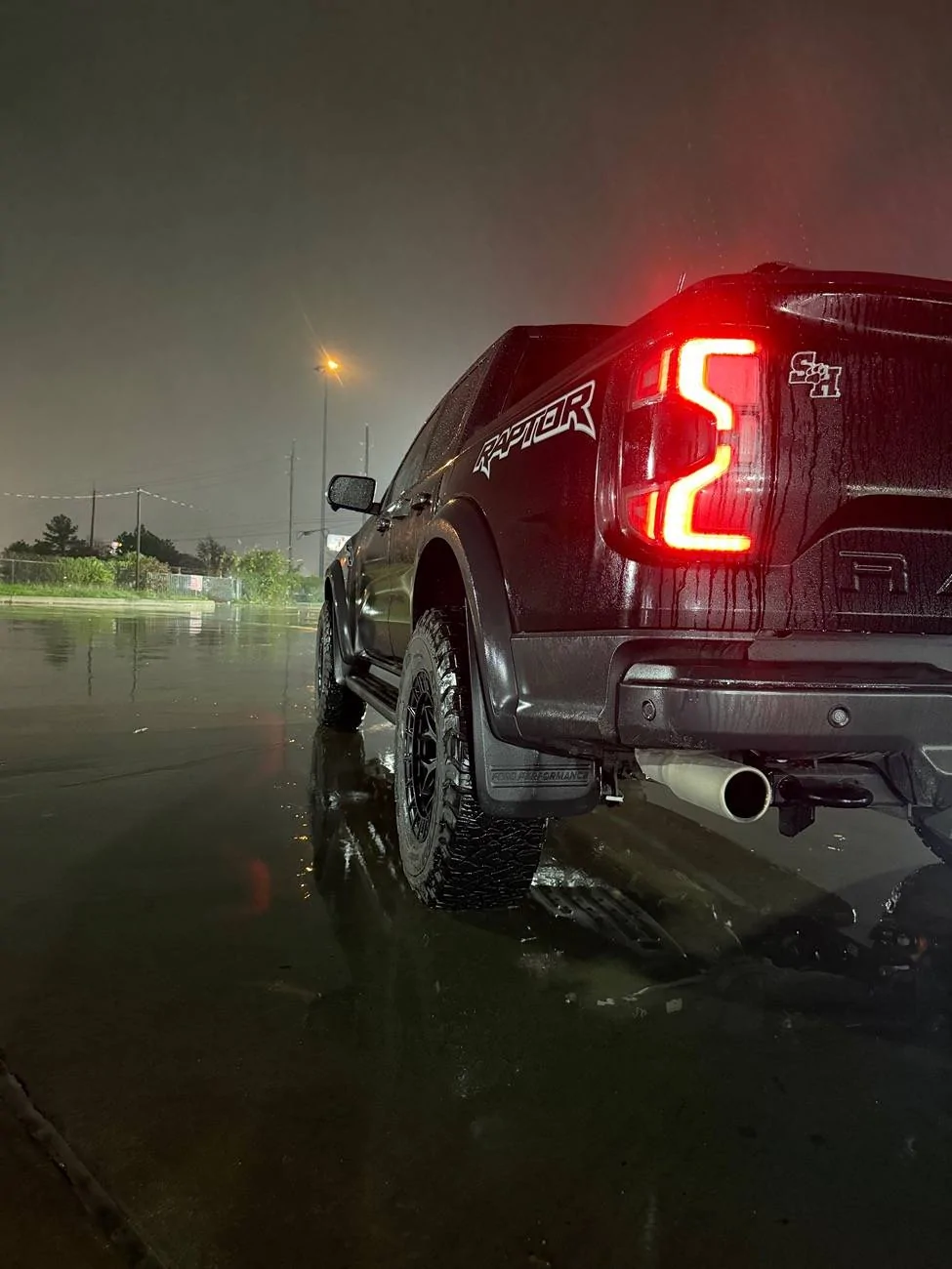

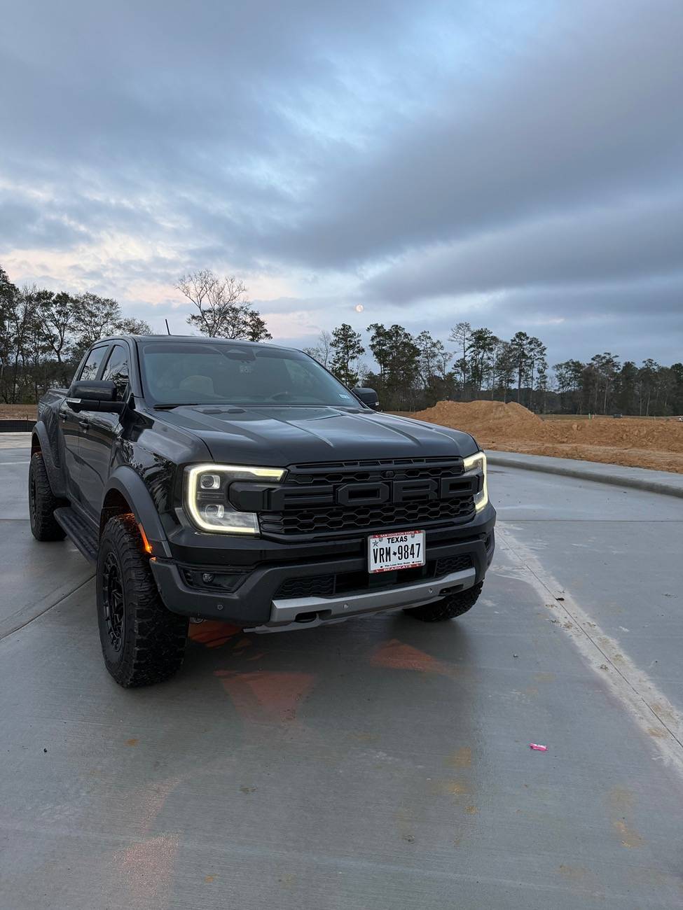

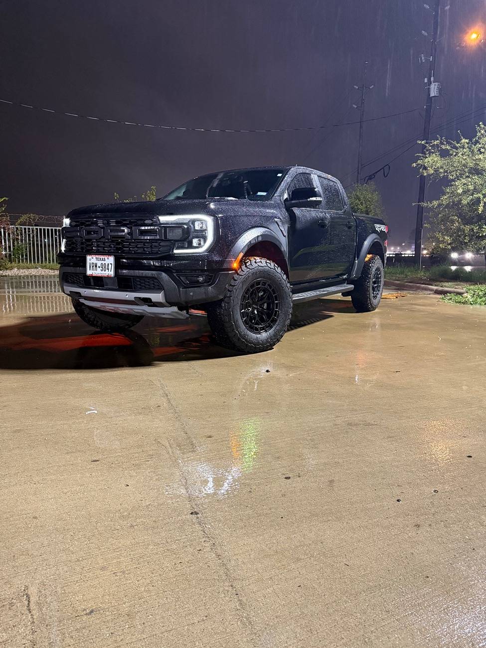

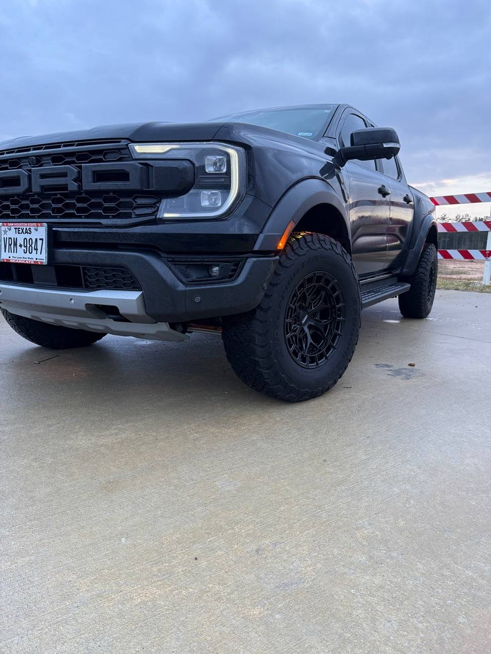

17x9 0 Offset Vossen HFX1’s on a Ranger Raptor using the stock 285/70/17 KO3's. No rubbing at full lock on a flat ground but it’s really close to the crash bars. I plan to remove them soon.
*Update: No rubbing at all thus far with crash bars

Looks great! Did you have to modify anything to make those work? What tires? Any rubbing?

No I didn’t yet but I want remove the crash bars as their is little clearance. Factory tires BFG KO3’s. No rubbing on flat ground but it’s very close.
