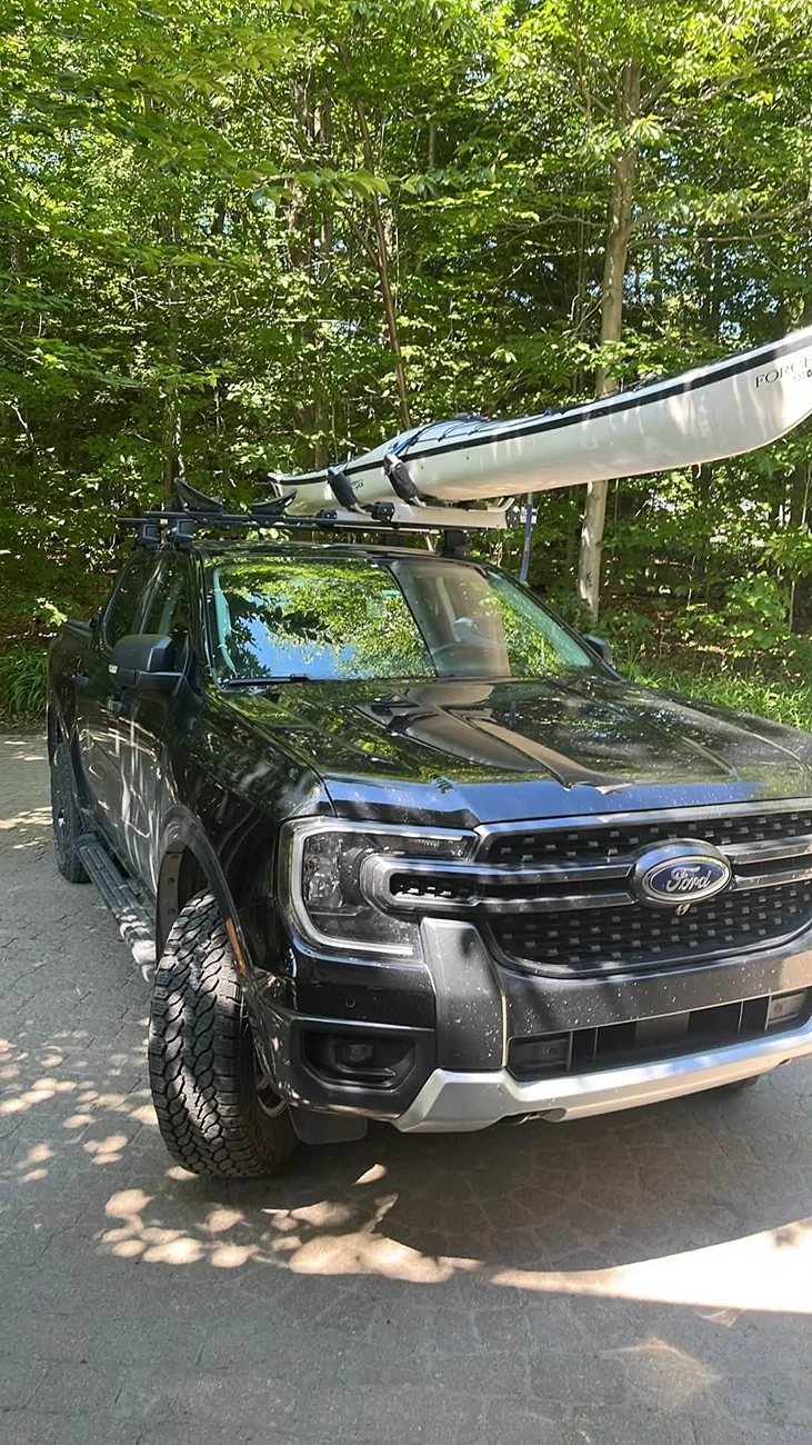

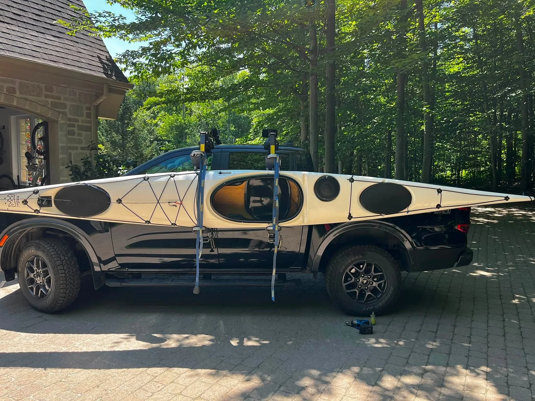

I have been a Ranger owner since 2022, but I have always relied on another vehicle for rooftop transport. That vehicle was finally sold in June, and I had to decide how to get my boat to the water and the campsites.
My 2024 Ranger with the Bison rollup tonneau is the current truck, and I had to decide how I was going to transport our two very long and heavy sea kayaks using this truck. I had considered a trailer, but ultimately "we" decided that "I" didn't want that. So it was either bed rack or rooftop. I went to a Rack store and they said the Xsporter by Thule would work, and after I got two hours into the assembling I realized that the C Clamps aren't long enough to go under the rail!! So I had to repack the whole thing and return it.
Next I went on Amazon and bought the roof rail setup, using square bars that would accommodate my existing saddles. I went with the 53" bars, to have as much overhang as possible. But when I tried to lift my boat up there it was NOT going to happen without scratching the truck or taking extreme risks with my back and shoulders!
So next I cracked and found a Thule Hullavator on Marketplace. I got it home and installed it - amazing how easy it is to install! After a bit of time figuring out the saddle width for my boat I tested it, and I must say I am as impressed as I thought I would be!
Thule makes nice gear and this Hullavator is beautifully designed. Easy on for my kayak, easy off! No drama at the launch, just efficiency and pleasure!
**I always travel with the kayak(s) strapped for safety in front and in back**

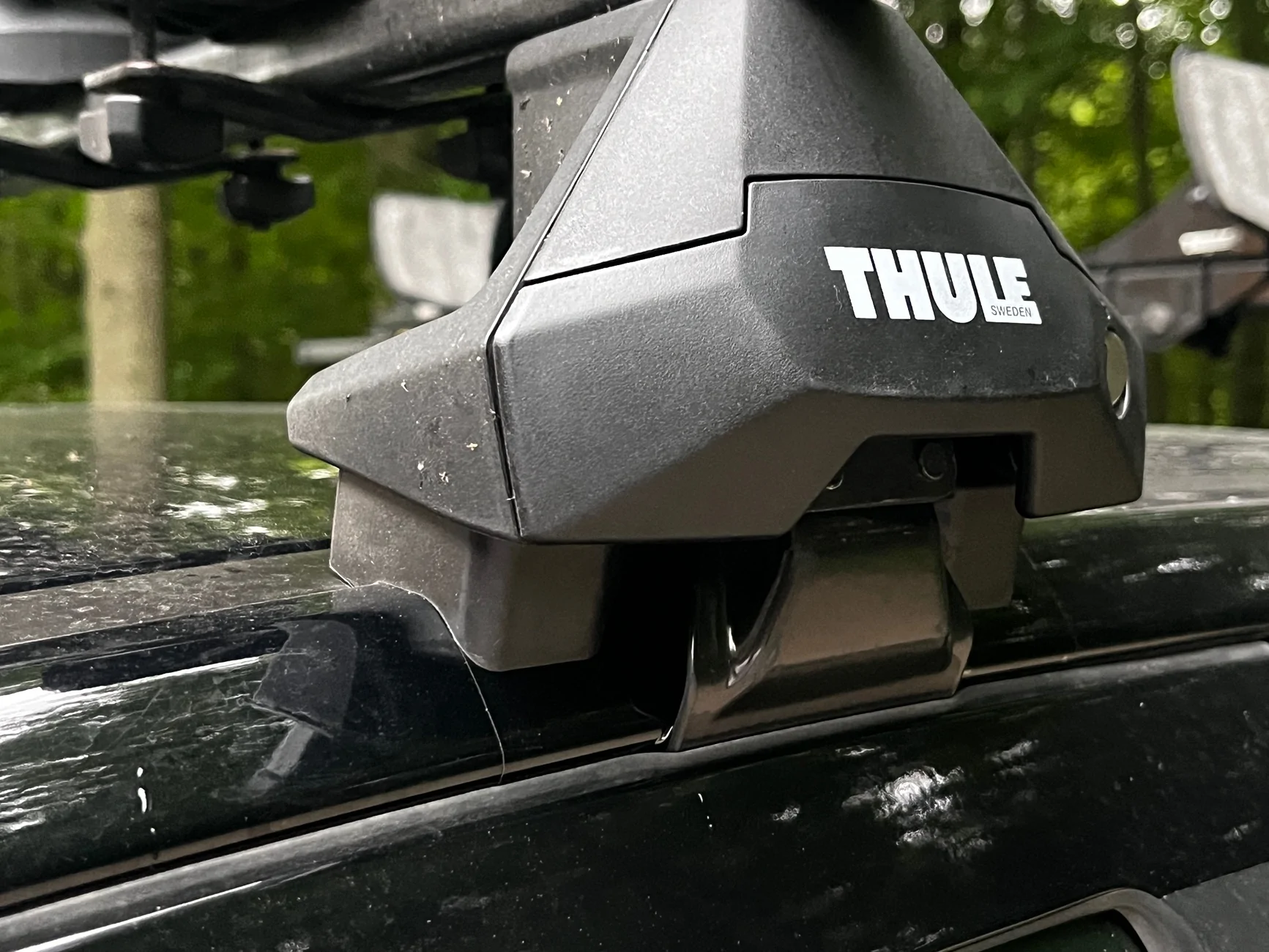

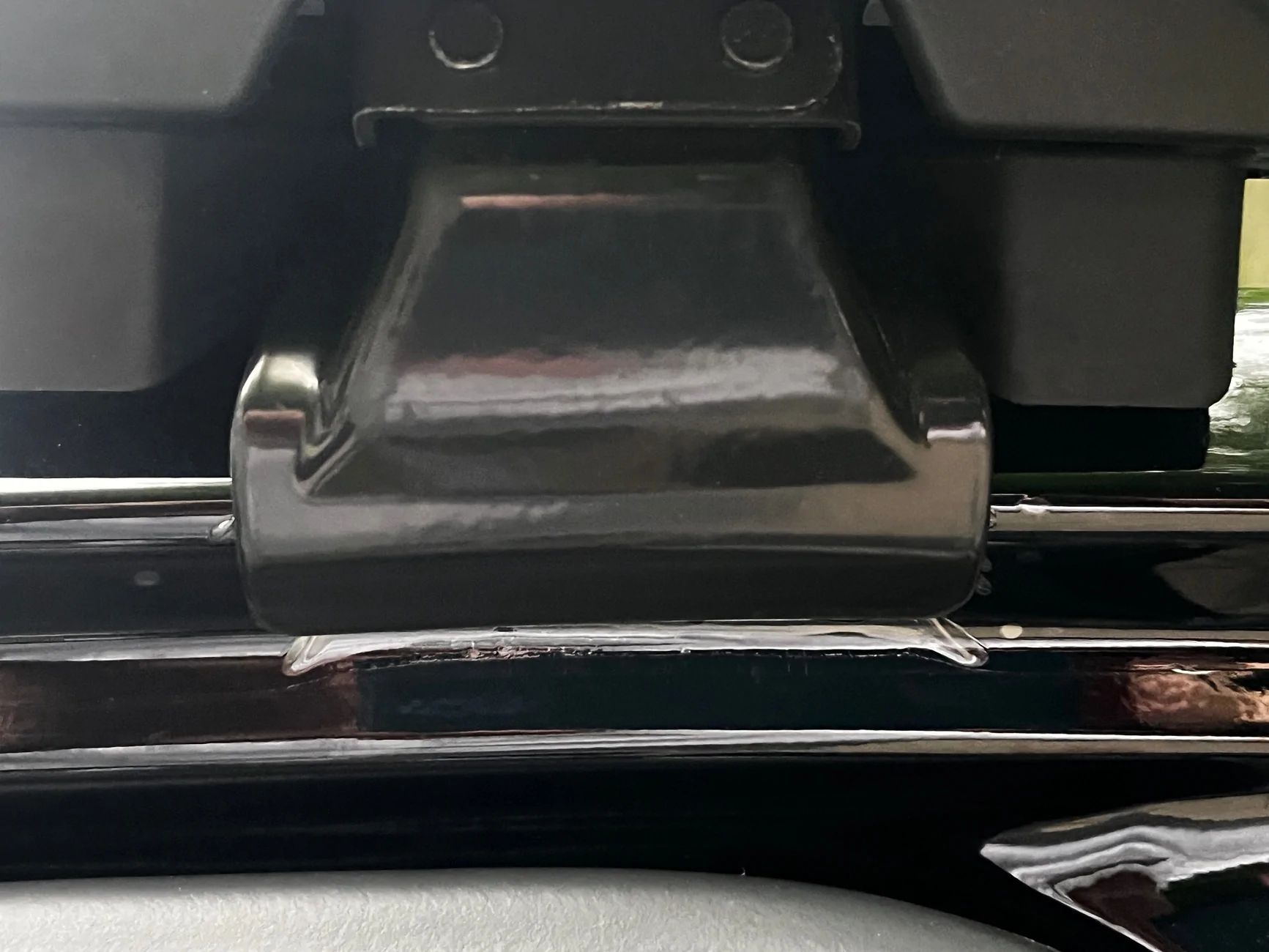

Here are the parts that fit our Trucks:
Thule Evo Clamp Foot Pack
Thule Fit kit 145324 (that's the little thing that grips inside your door frame)
and the 150cm Evo Square Bar (so I could reuse my older saddles)
I bought and applied some XPEL R4003-P Clear Paint Protection Film Roll on the roof and inside the door jamb to protect the pain. Easy and cheap insurance against scratches!

The Xpel is supposedly the best protective film out there. It was relatively inexpensive and very easy to apply.

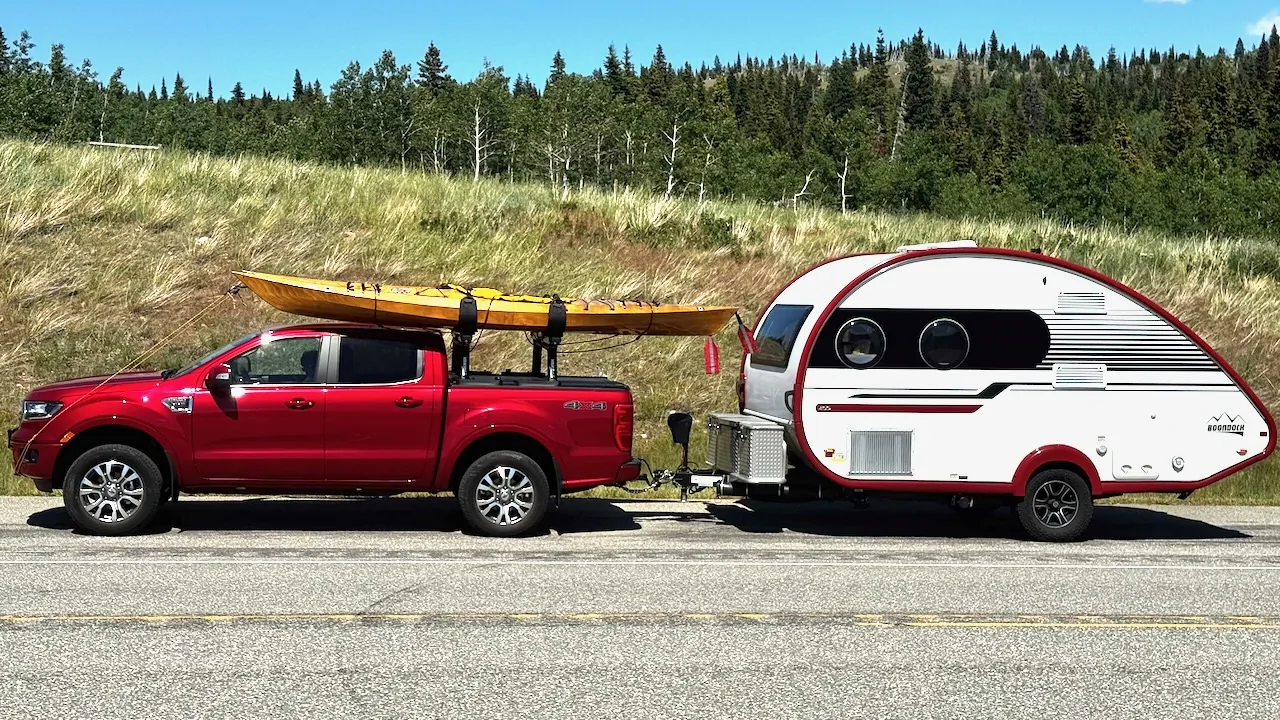

Thanks for posting this. I considered doing the same thing but was concerned that the combined weight of the kayaks, rack and Hullavator might exceed the recommended roof loading. Did you check this?
For others looking for similar solutions, I ended up with the Hullavator mounted above a Retrax bed cover on Yakima Overhaul uprights. But note:
1) This wouldn't work with the rollup cover you have since it wouldn't clear the tied down lugs on the inside of the Overhaul uprights. I checked. There are alternative T Track compatible uprights out there though.
2) My set up leaves the kayaks pretty low when loading. Great for loading onto the Hullavator, but I have to do a deep knee bend/overhead press to get it back up. I may switch to the taller adjustable Overhaul as I age :)
3) Watch the overall length behind the truck if you are towing a trailer.. My setup would probably not work for any kayak longer than 15' with my trailer (a T@b 400 Boondock) - since the kayak would hit the windows on corners. My kayaks are 14.5'. See the attached photo.

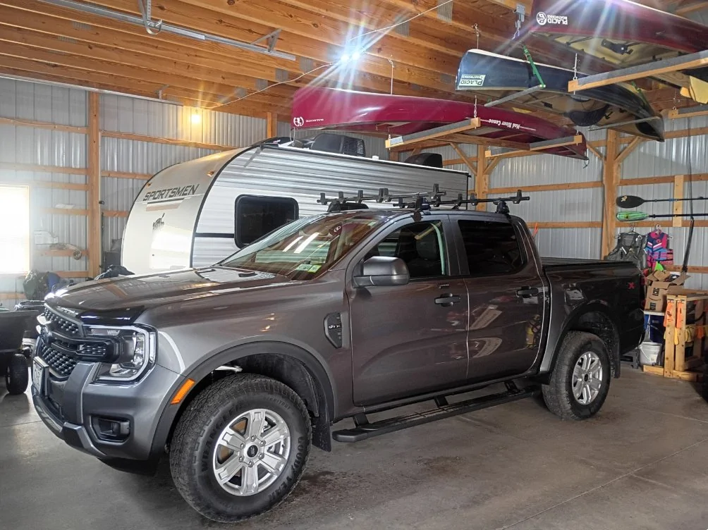

Went with Yakima on the roof for our canoes. (12', 15', and 16.5'). Was able to get a little more spread between bars by using the clips from our Maverick on the back bar. Nice T@B RHIPDX. Miss ours.
