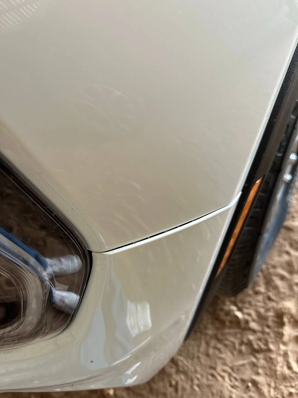

this piece doesnt seem to fit right?
its really not that noticeable,would it be a easy fix for a bodyshop?asking here first,yes i know its in warranty
Ford Ranger 2024 ford ranger xl piece by headlight IMG_8910

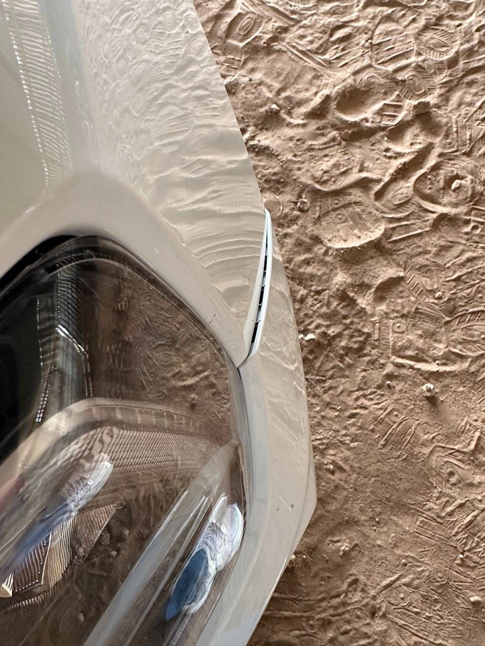

seems to be getting worse
Ford Ranger 2024 ford ranger xl piece by headlight IMG_8986

I'd be looking around the inside for possible damaged or broken parts before going to a dealer for warranty repair. Have be sure no one hit your truck. Then after looking around, you might see a way you could correct this yourself.

it has not been hit

It looks like the clips that secure the piece are just out of place. I would try pushing it upwards and tapping it in with the side of my fist to snap it back into place. It shouldn't be a big deal unless the clips are broken.

that fixed it,also texted a guy i went to school with that owns a body shop,he said use a rubber mallet and lightly tap it in,drove it to town and back,still good!
