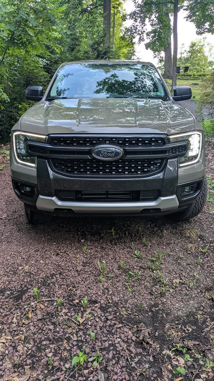

Picked up my brand new Ranger XLT today that I ordered 3 months ago. Super excited! Took the afternoon off work to tinker with it and plan the accessories I will install on it soon.

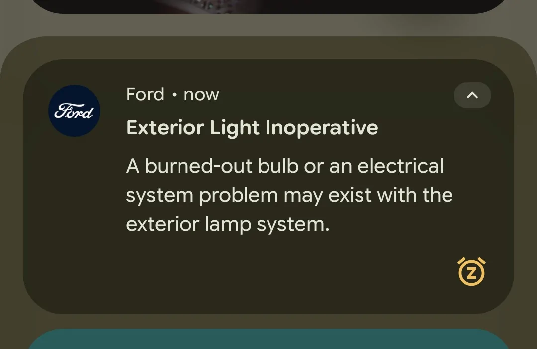

Anyway, drove it less than 11 miles, brought it home and was idling in the driveway while playing with settings on the infotainment, when a yellow error light popped up on the bottom left corner of the dash cluster... At the same time, my Ford app alerted me that with "Exterior Light Inoperative" - see screenshot attached.
Super bummed. I just brought it home! Think it's an easy fix? I've got a wild day at work tomorrow so don't think I can drop it off until at least Thursday... but hoping it is something simple and a same day repair.

Being brand new I'd first suspect that a connector wasn't securely attached. Pop the hood and look down at the back of the headlight assembly and you should be able to see the electrical connector.
I did pull and plug back in the connector but no dice.
What's odd is the DLR and high beam work fine as well as turn signal. Only low beam doesn't work

Dealer said a pin in the plug was bent from the factory. They simply bent it back straight, plugged it back in, and headlamp works again. Good to go! Thanks all
