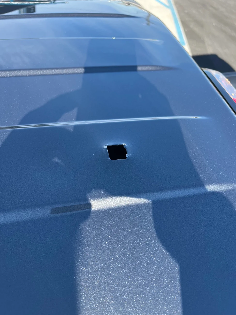

UGH. Entire antenna assembly ripped off in car wash. (hole in roof)

What holds the base part in place to begin with?
Is it glued to the roof top?
What keeps the water out?
It looks like a problem design down the road unless I am missing something.

It seems like the inside part doesnt have a large enough washer so the car wash just pulls the end up and out.
I wonder if a person can get to the inside easy enough that a large fender washer, or some large flat plate csn be put under the nut to secure ir down?
There is no way in heck that should be happening

That's crazy. It does seem like it's not exactly welded in though.

The unit bolts in from under the roof liner. It has little clips held down by a screw.

Warning to remove antenna was an early thread back in the beginning of Gen5. I take me off before and never had a problem. Tough luck but there is some good advice in this thread.
