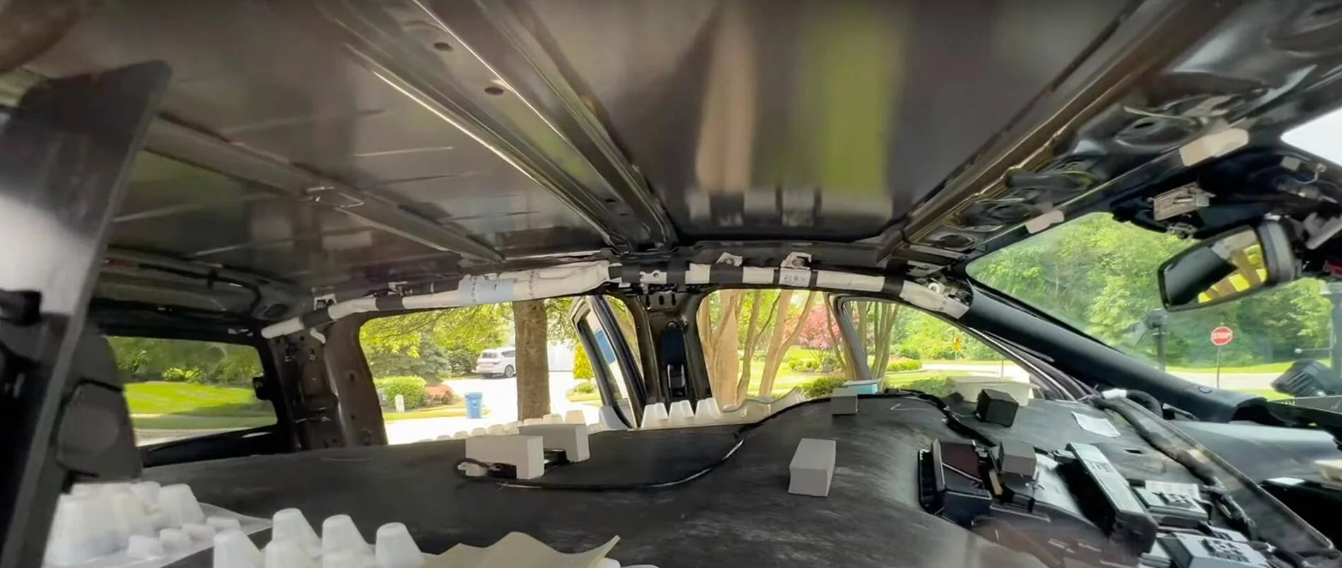

IDK what you're talking about with metal beams being a GM recall fix. I am attaching the picture of a 2024 Raptor with the headliner pulled down (from one of flaberdoopin's videos). As you can see there are a number of braces that are attached to the sheet metal going across. Them being pushed down a little would be from the foam block which rests against the roof - but that piece of foam sits right beside the beam.The way the sheet metal is reinforced and the way it is stamped you would have to have some sort of defect in the construction of your particular roof to be having an issue with the metal popping up and down imo - maybe you are missing some welds. There is too much tension on the sheet metal from the welds for that to happen the way they are made. Vibrating a little from a ton of force from a blower makes sense, but it would take a lot of force for the metal to pop down.
Ford Ranger Extremely weak cabin roof Screenshot 2025-06-08 at 1.43.18 PM

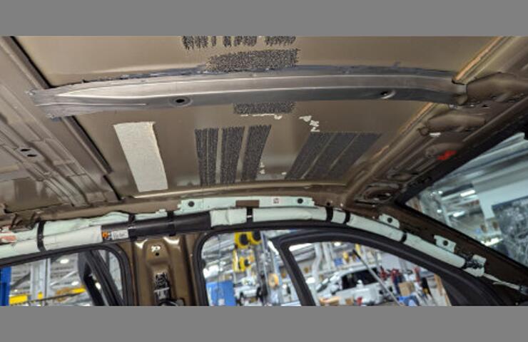

And tbh, if what you're showing is really the roof of a 2024 Ranger, that roof looks almost identical to the GM's before they got them recalled and fixed. They added several extra reinforcement patches and finally a transversal bow front to back.

https://gmauthority.com/blog/2025/0...f-denting-issue-finally-fixed-at-the-factory/
And Ford should do the same already. Dealers already know about this design flaw. When I brought it up, they dismissed it as being "by design" and "it's also happening on bigger models".
What's the best way to escalate this btw? Anyone knows?

It’s literally not the same my guy. That GM picture has nearly twice as much space between the support beams (the pic you posted has them back behind the B pillar which is a completely different design) and there are no welds or adhesives holding them to the roof to put tension on the metal, and that roof is stamped completely differently with a larger bow between the supports.
