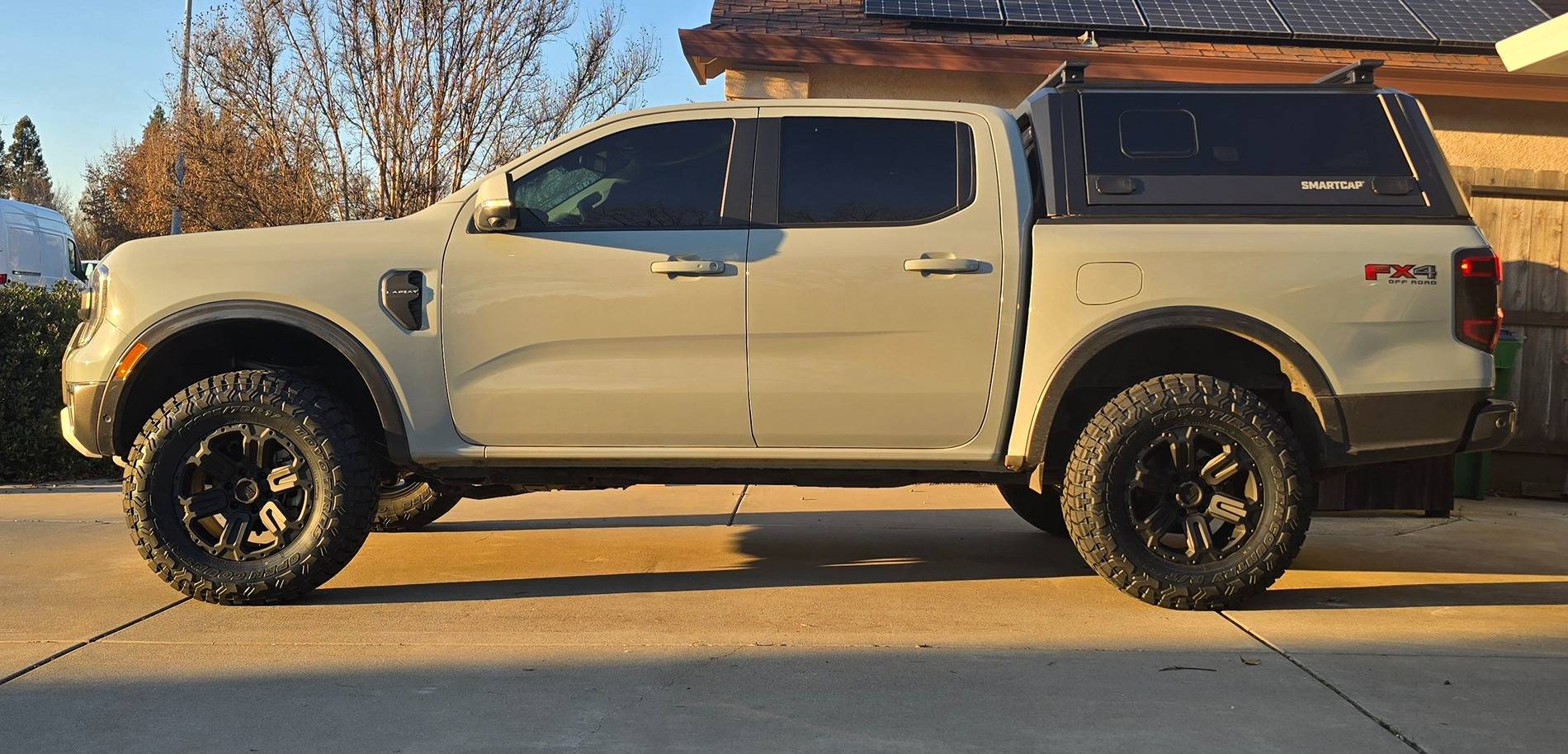

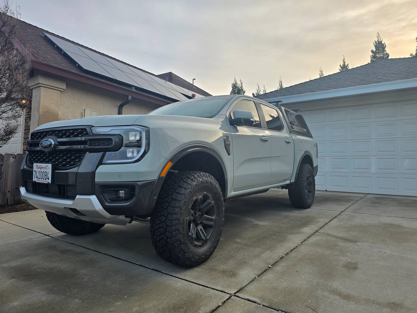

I ended up installing the super lift leveling kit. 2.5 inch spacers and sway bar links. Rides great and was able to put 285 70r 17 on. Only trimming was an inch of felt in front of the wheel.

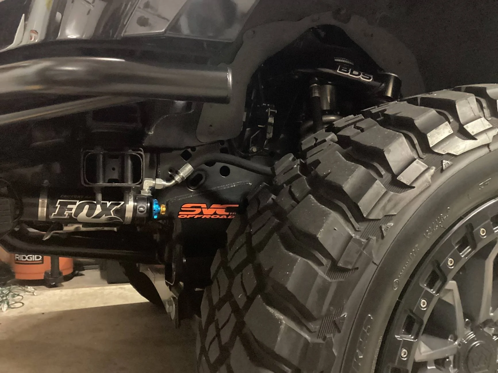

It’s a little hard to see in this pic but BDS had the same issue, we made a bracket to mount the sensor arm. Love to see a pic of the Ranger set up.

Follow up, just looked at my Raptor almost the exact same bracket we relocated on the drivers side on my F150 BDS UCA

nothing, the minor lift of the rear didn’t effect it. I wish I had a better picture of the F150 but sadly it is gone. I was able to mount the portion of the bracket that is screwed on to the factory UCA, drilled and bolted it on, no issues for 50k, good luck!

Ok thanks. The rear is half inch lower than the front. Looks extreme in the picture but it's not on flat ground. Planning on throwing some one inch blocks but held off after seeing the back sensor. Still stoked on all the lariat gadgets though. Has a lot more than my super duty lariat except the air-conditioned seats. Why they don't have ac seats sucks
