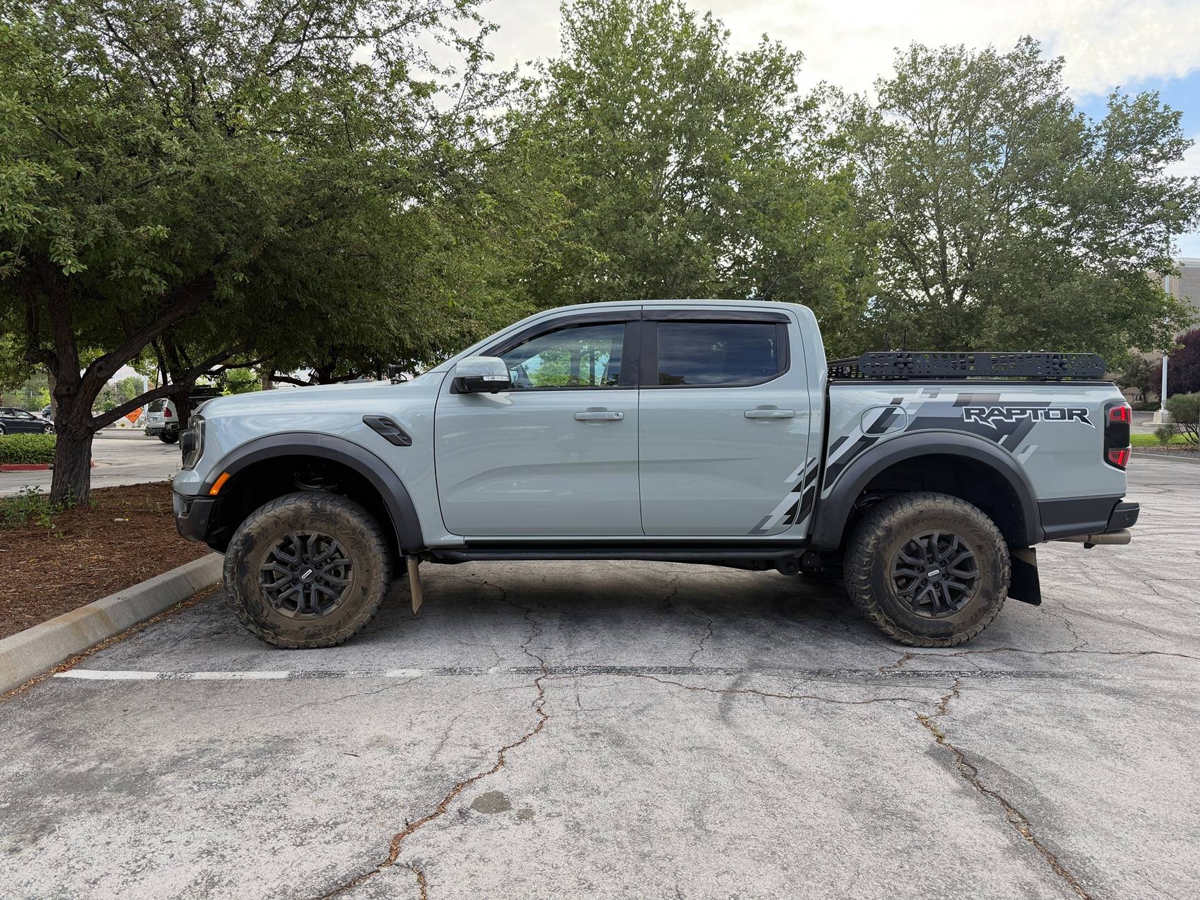

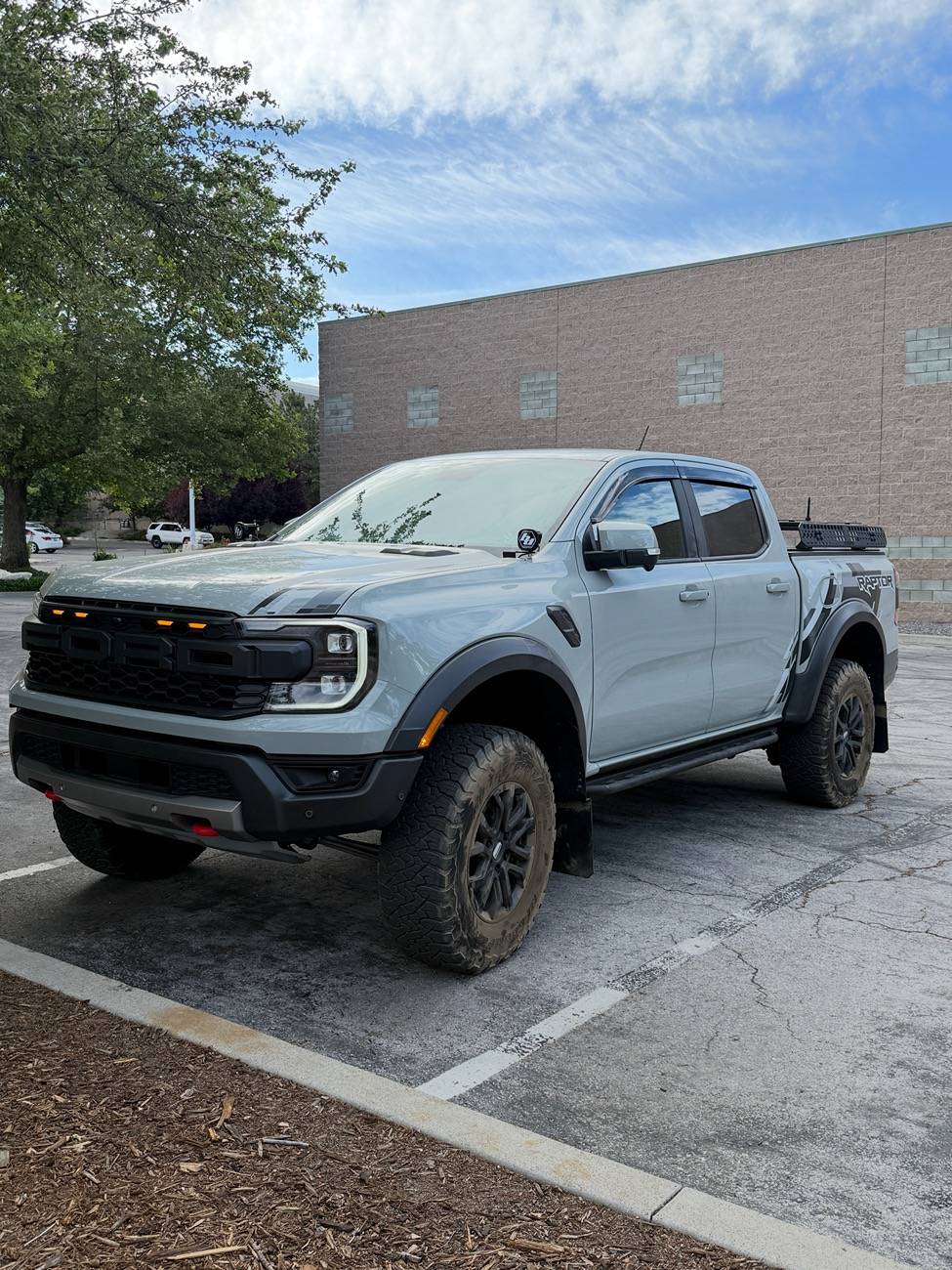

Update: Springs installed
Ford Ranger HyperCo Lift Kit - Springs IMG_6341
Ford Ranger HyperCo Lift Kit - Springs IMG_6342

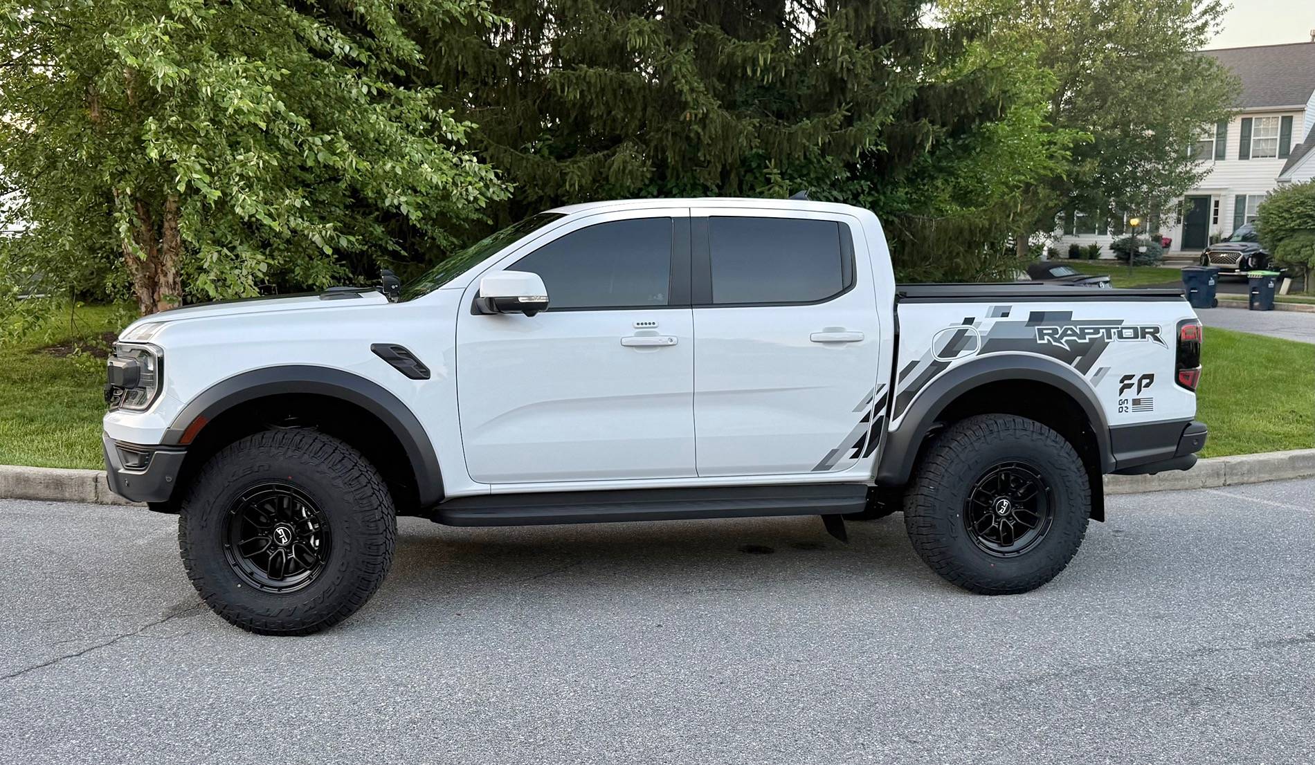

Got mine installed too.
It looks a little low in the rear in the picture. I'm assuming it's just my eyes playing tricks on me. As for the minor rear lift, I like the raked looked. Would that mean installing the heavy load rear springs, or just taller ones?
Just the angle. Slight rake in both kits I believe
