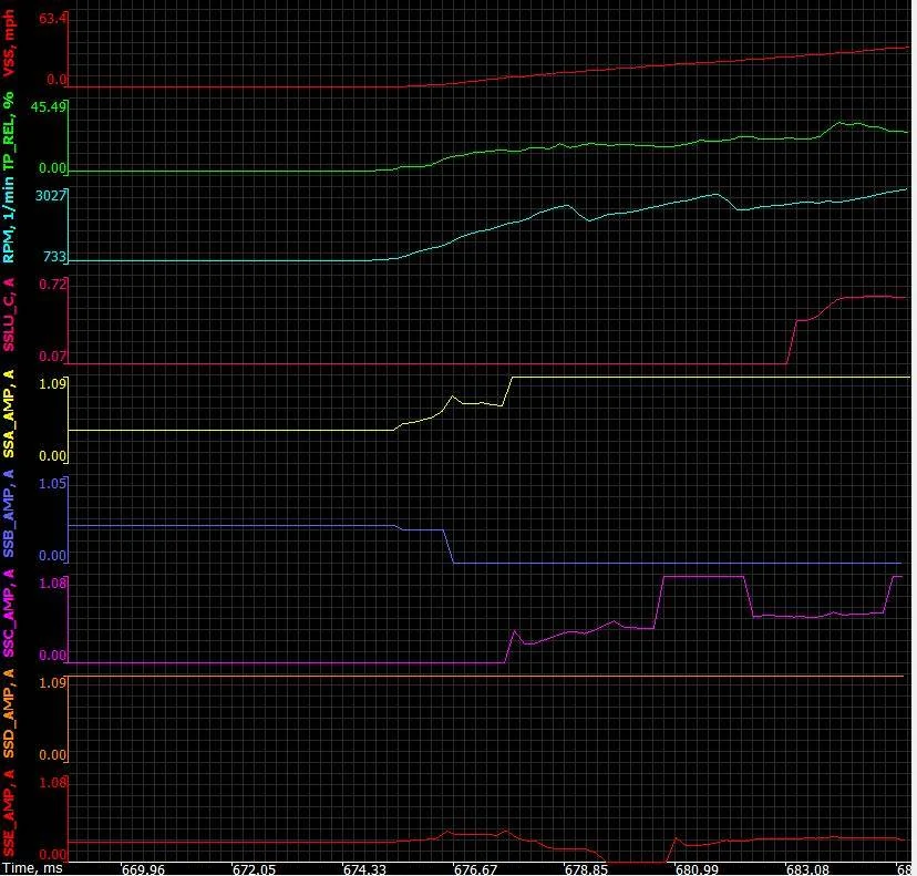

Pulled a log to put here regarding the TC lockup. It doesn't exactly look smooth, and as we know doesn't feel like it. The 2025 gang doesn't seem to run into this so I'm thinking either a firmware or maybe design issue on the 2024s?
My thought is to take this data to the local dealer and ask their techs straight up Is This Normal? If it is, then whatever. But if not, I'd rather a slipping clutch be fixed before it gets expensive. I'd sooner think not as Ford does actively seem to try and address driveability issues.
At any rate, SSLU is the TC lockup clutch amperage to the solenoid. RPM is above it. You can see the shudder on the tail end of the TC lockup if you look close. Trans clutches are below. Third gear starts when the C clutch goes low the first time.
