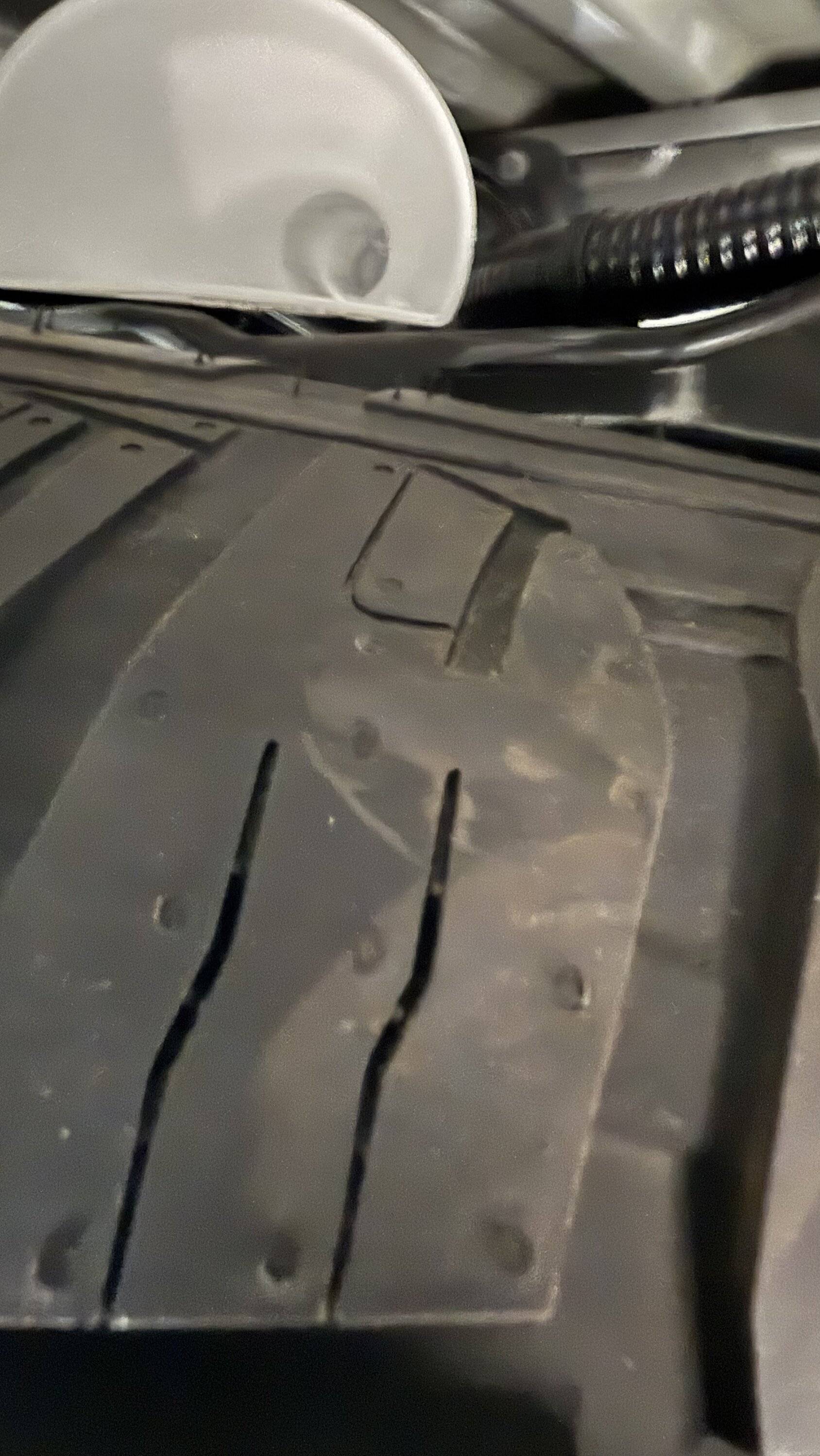

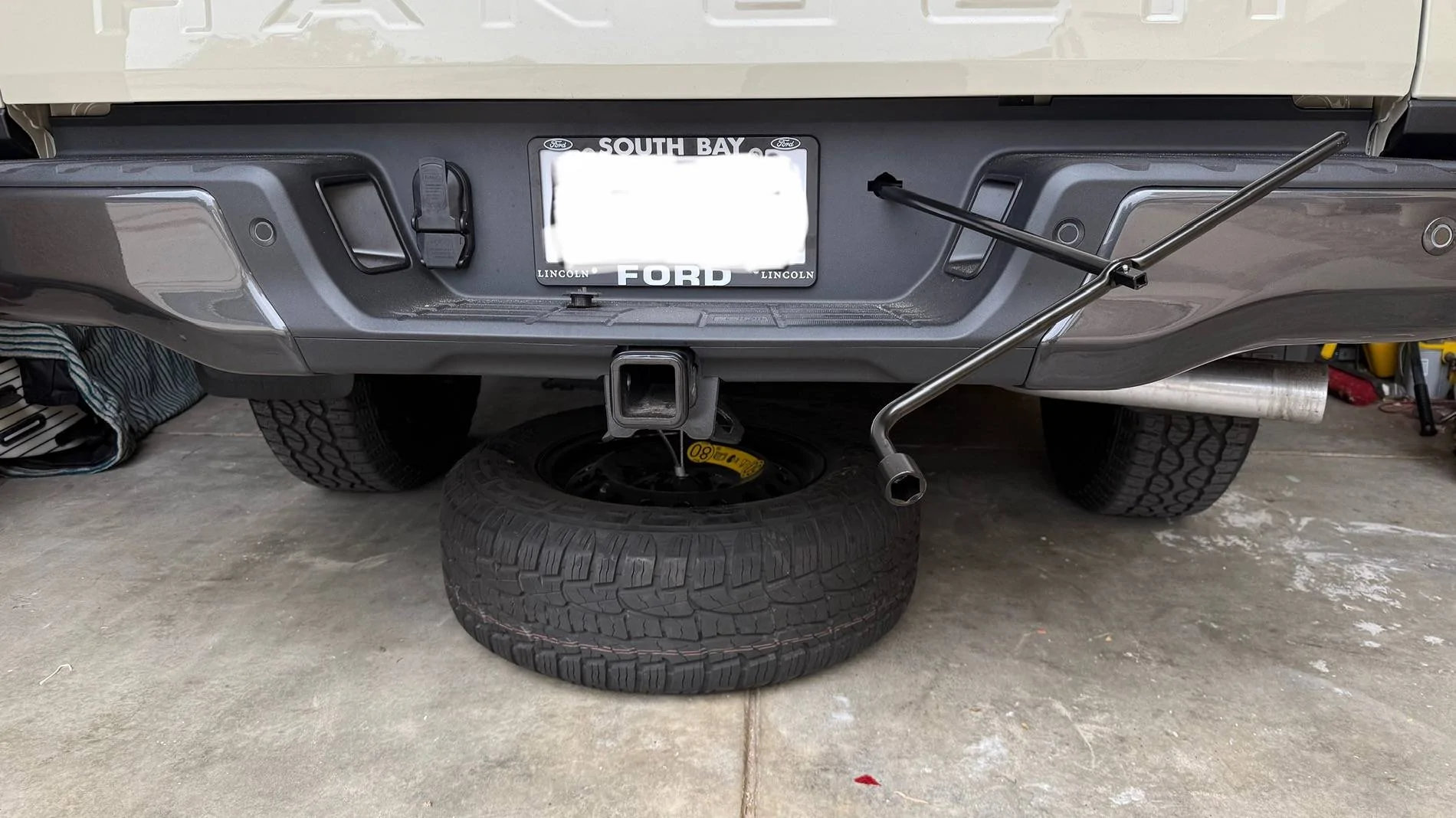

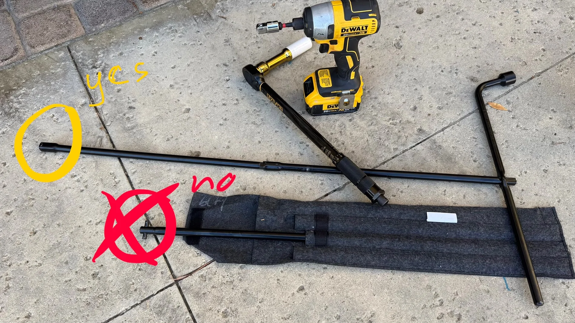

Today I practiced changing a tire and I maybe super dumb since I read this but guess I didn’t understand it and went through the same cycle, only I opened the manual.
https://www.ranger6g.com/forum/threads/well-i-feel-dumb.18395/
to reiterate, open square goes into the white funnel thingy above the spare tire at an angle.

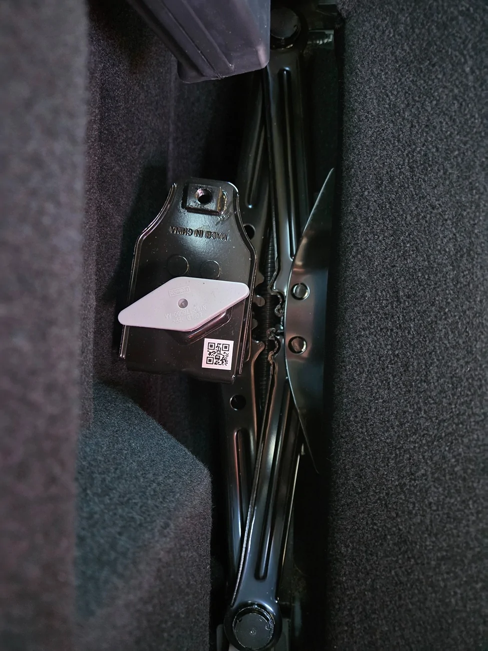

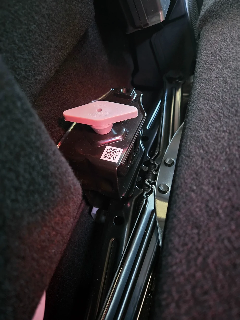

and the scissor jack is adequate for lifting front and back wheels. Although I’m going to carry a chunk of wood for a pad
I took some pictures for posterity

I tested mine past weekend!! I used silver sharpie and wrote "spare tire" on the open square end. Or could use piece of tape, etc. And i wrote "jack" on the end of the rod with T-end. Nice and bright. That way me or other person can easy read what goes where and how to assemble.
