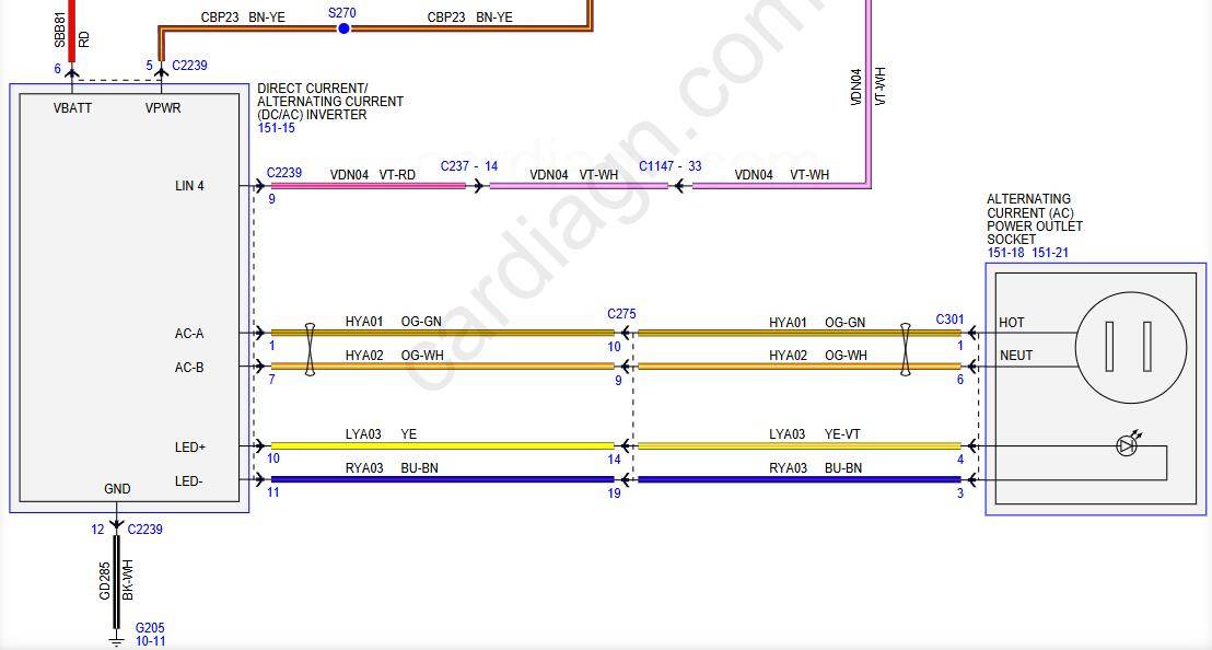

The 110v is still there and the shifter is the same.
except the 110 Volt outlets both in the bed and in the cabin have never worked on my 2024 Lariat, fuses are both good, service advisor says BOTH the outlets are bad! and they are on backorder all year long, he doubts he will ever get them! I pointed out how freakish that both the outlets are bad, would you think it probably is the inverter that powers the 110 volt outlets is probably the problem? he said his tech said the inverter is fine, HMMMMMMMMMM

Would be a DIY project, but you could maybe drop in a new inverter and use the existing outlets. Might allow you to up the wattage from 400w to 1000w

Does the LED illuminate? I'm limited on what prints I can find, but it looks like if the LEDs illuminate it's essentially an output from the inverter. Did they test for voltage output at the inverter?
