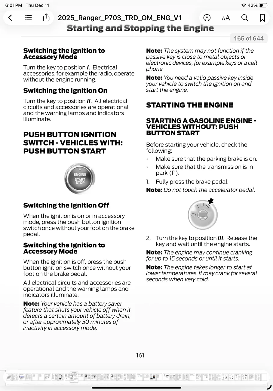

i believe if you go into the truck and press start button without your foot on the brake it will power up the auxillaey power and rhe 12 volt outlets

of you turn the key to accessory mode, the 12v outlet should be energized.
Ford Ranger 2024 12v bed plug IMG_2956
