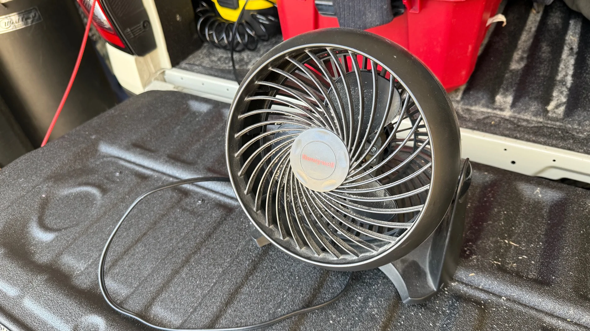

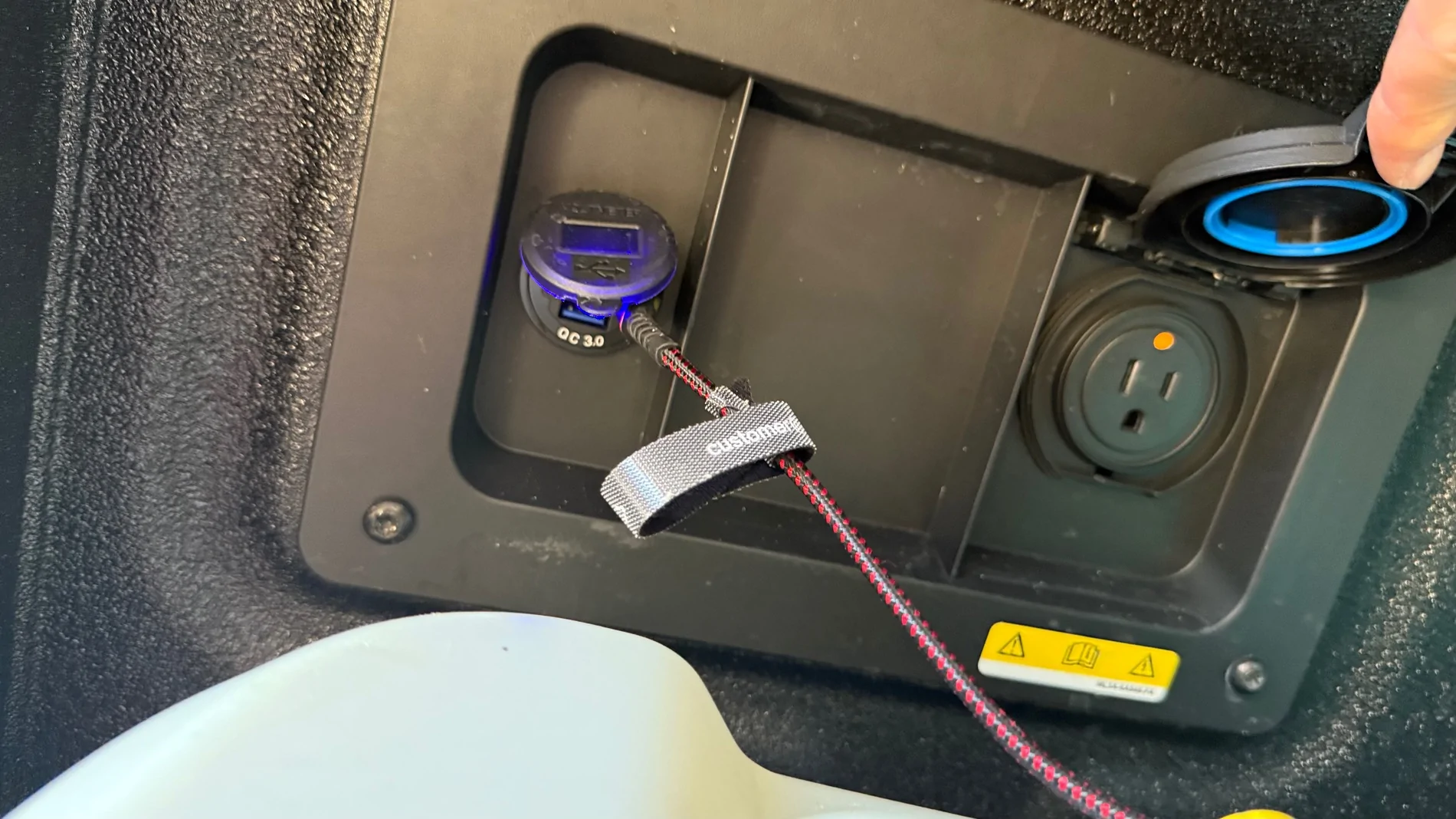

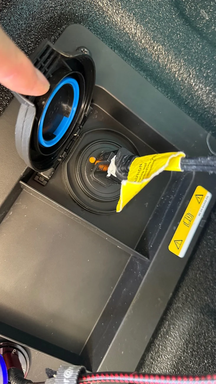

Engine has to be running.
I just checked with a small fan.
It can be in park or I assume drive but I haven’t tried the latter.
the light will come on
I put in a 12v usb c plug in the bed to charge a little sprayer that I use at the beach

Thanks for the pictures, I’m not getting the light coming on so wasn’t sure if I was missing something. From what I read it doesn’t have to be in park necessarily for that to happen so may have to swing by dealer to see if there an issue.
