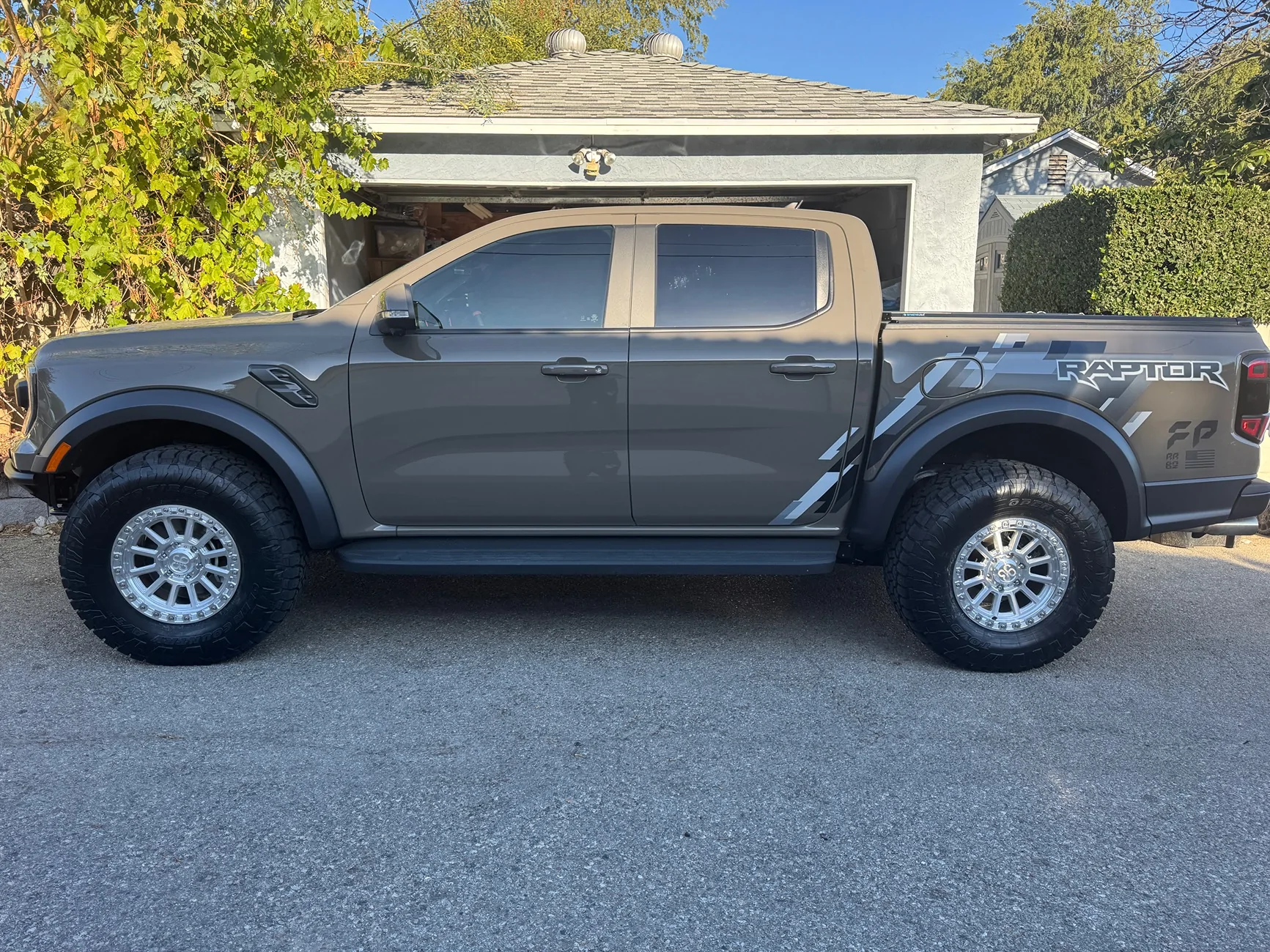

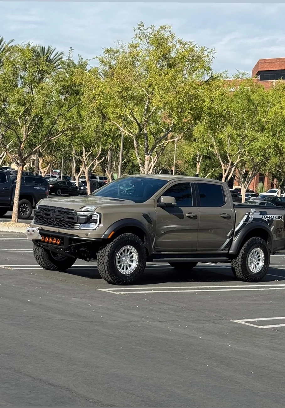

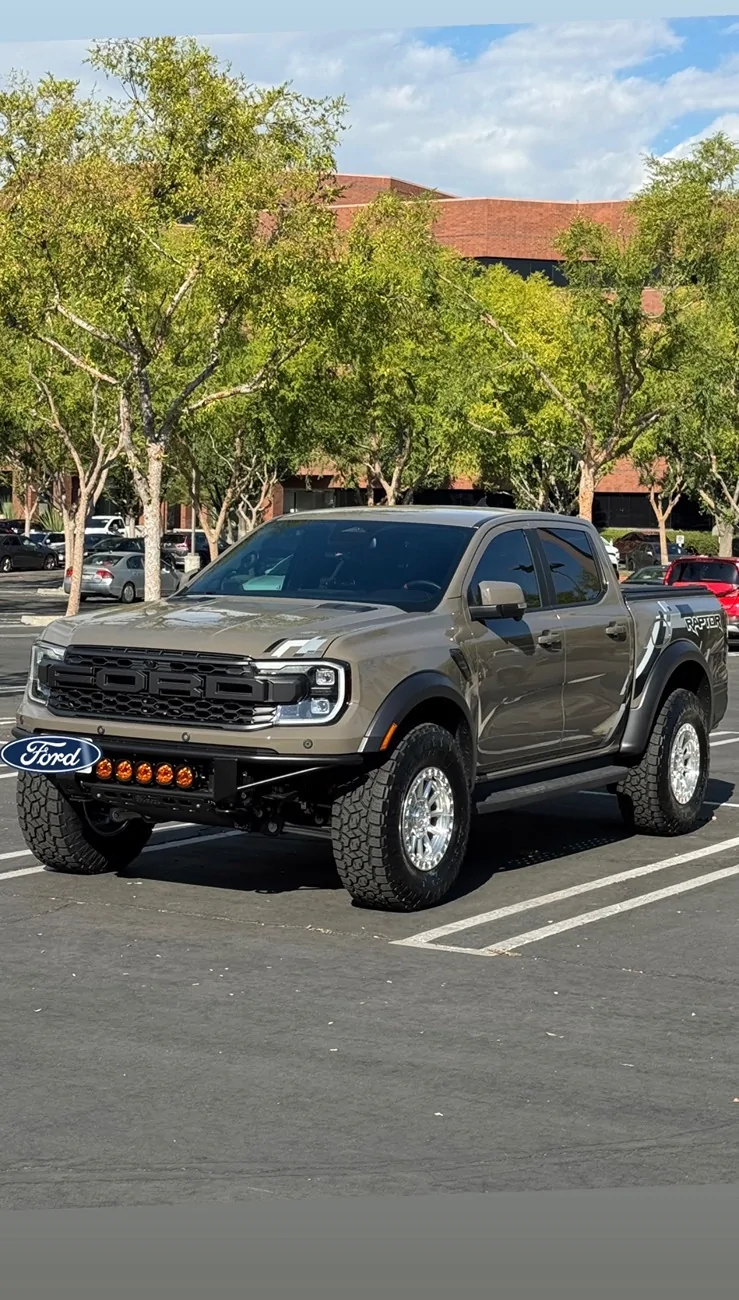

Finally got my new wheels mounted. Toyo open country AT3-LT C rating 35x12.5. Wheel spec is 17x9 +35 offset .Still trying to dial down tire circumference on forscan.
Tire circumference ended at 2653 2663 in FORSCAN. Used my radar detector as reference.

Looks good!

Looks good! How long did it take for them to arrive? I’m trying to determine when I should order to have for a spring install.

About 8 weeks from the time I had submitted the order.
Are the wheels 9 or 9.5"
17x9 +35. Minimal poke but if you want no poke maybe a 17x9 +40 or +45 would be my guess.

Looks really good . I going to get 35mm but a 9.5" wheel and same tire. Soooo How much space is remaining between UCA and tire?

I can snap a pic for you later when I get home. I tried finding the thread that had provided some pics with the same wheel specs but can't find it right now.

Thanks much. My math says the 9.5” wheel would put me 6mm or @1/4” closer. Thanks much

I love the wheels. Did you happen to weigh them? I’m interested in a lightweight +35 17x8.5 on a 35x11.5 but wheel options are limited.

Unfortunately, I did not weigh them but just checked my fedex tracking and each box weighs 36.8lbs per box. Hard guess maybe around 29lbs per wheel(?)
I would recommend reaching out to Nate from 9and3 wheels he responds pretty fast.
