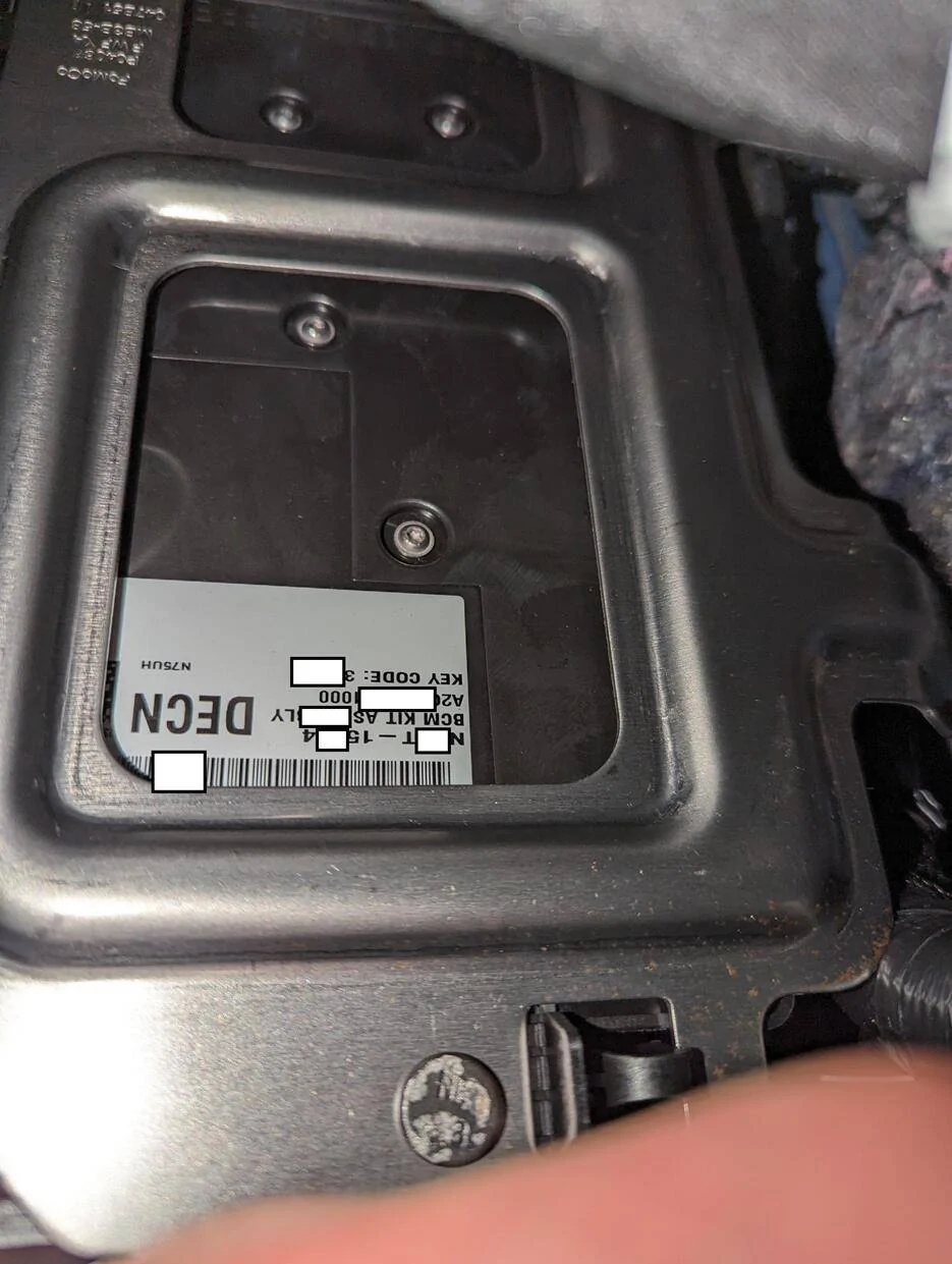

Sorry to hear that. I found the RAP module with the code on it last night. It's in the driver's foot-well, next to the door frame. It's low and close to the floor. The sticker is facing the front of the car.
I got it by laying on my back on the floor, head next to the brake pedal, and by looking near the hood release latch. I could not see it with my eyes (due to the position) but got it with a smartphone camera.
I attached a photo if it helps.
