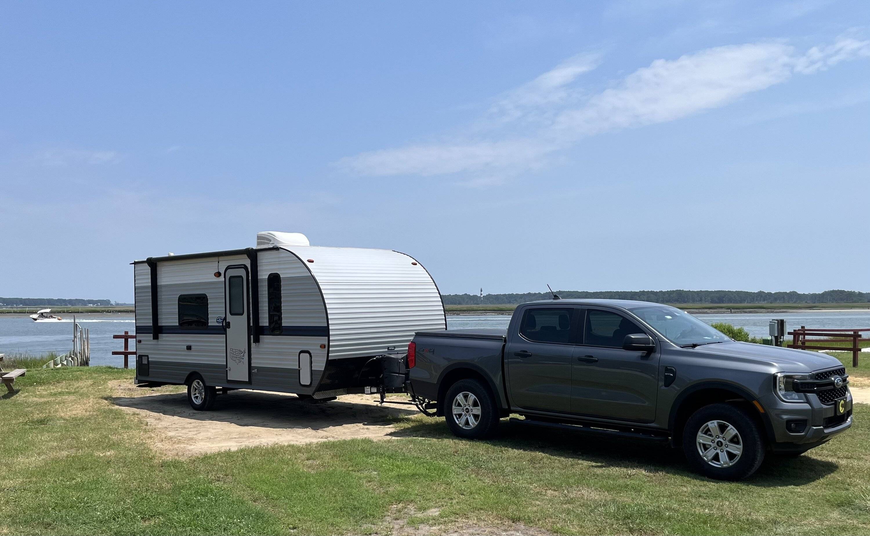

I have a 1996 Ranger that would shudder with a heavy payload. It took them a while to figure it out. Turns out the drive shaft was binding. They put a 1/4 inch plate under the center bearing and that fixed the problem. Probably not your issue though as it does not appear that your truck is squatting very low.
