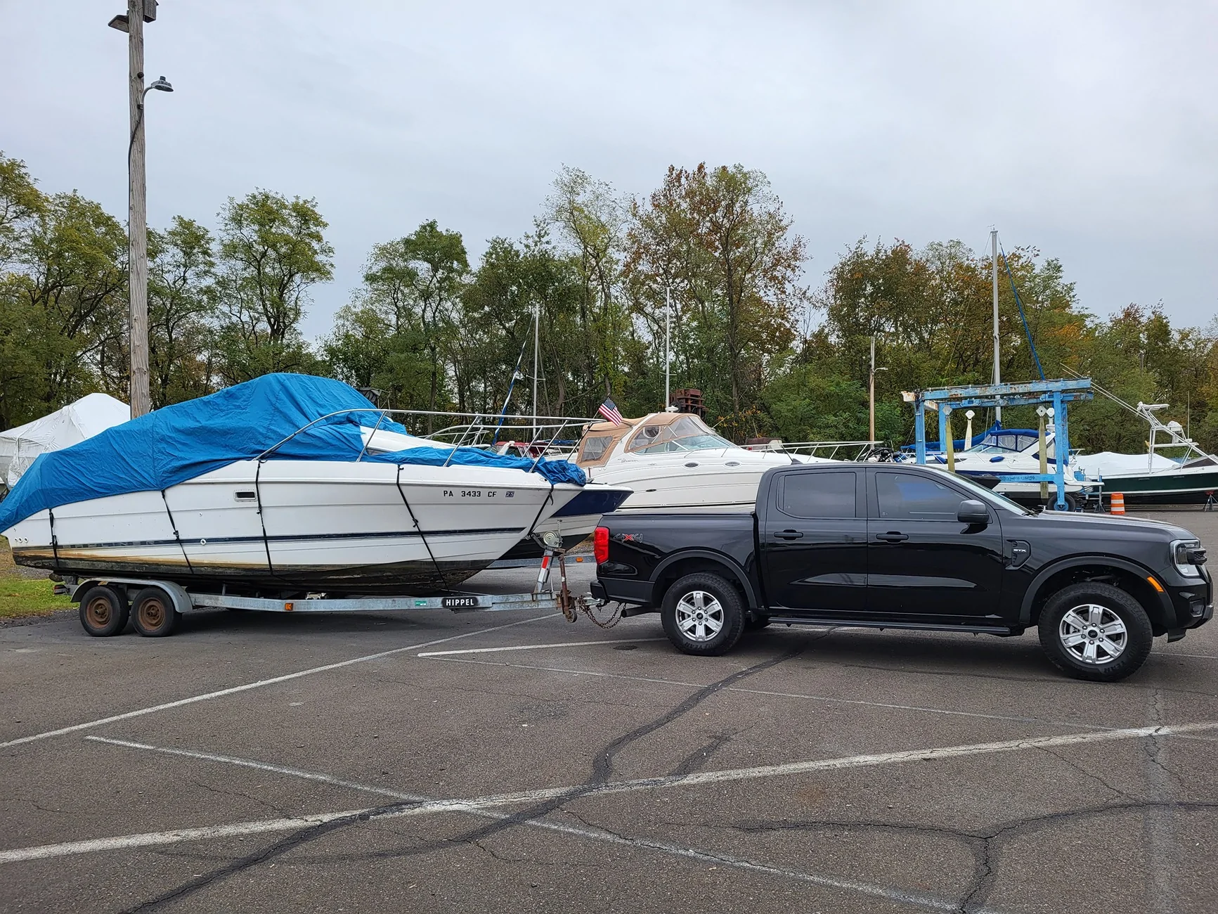

Hate to be that guy but, by the looks of your carolina squat, looks like your boat could afford to sit back a little further on your trailer (i.e. looks tongue heavy), I'd say about 8" back on the winch post will do...truck will steer better too!
Nice boat BTW!
Nice boat BTW!
Thanks

It was time to take my 24' Baylinger out of the water. The ramp is steep and the boat, trailer and gear weighed 6,400. My Ranger did a great job. Sorry no pics of the ramp I was busy.
Nice set-up. I tow my 25' Boston Whaler with my Ranger no problem. I do think you need to raise the ball mount on the truck. Your trailer should be level, your a bit unbalanced with more weight on the trailer front axle. Tongue weight for towing a boat should ideally be about 13%, so pay attention if you raise the ball mount as you might have to reposition the boat on the trailer. Try and borrow a tongue scale like this one: https://www.amazon.com/dp/B007REJTGI?ref_=ppx_hzsearch_conn_dt_b_fed_asin_title_21
Are you talking about my drop? I used a 5 3/4" , I also have a 3 1/2" drop. I thought the trailer looked level.
It could just be the picture. It looks like there might a bit to much drop. The front axle on the trailer looks like its carrying more weight then the rear axle. put a level on the frame rail of the trailer - if its level, all is good.
The level is a good idea.

easiest way to see that the load is balanced on a tandem axle trailer is to measure the shackle flex between both axles (the center link acts as a shackle); the distance from shackle to frame should be the same for both axles. If you have torsion axles, measure the distance between spindle arm and frame.
