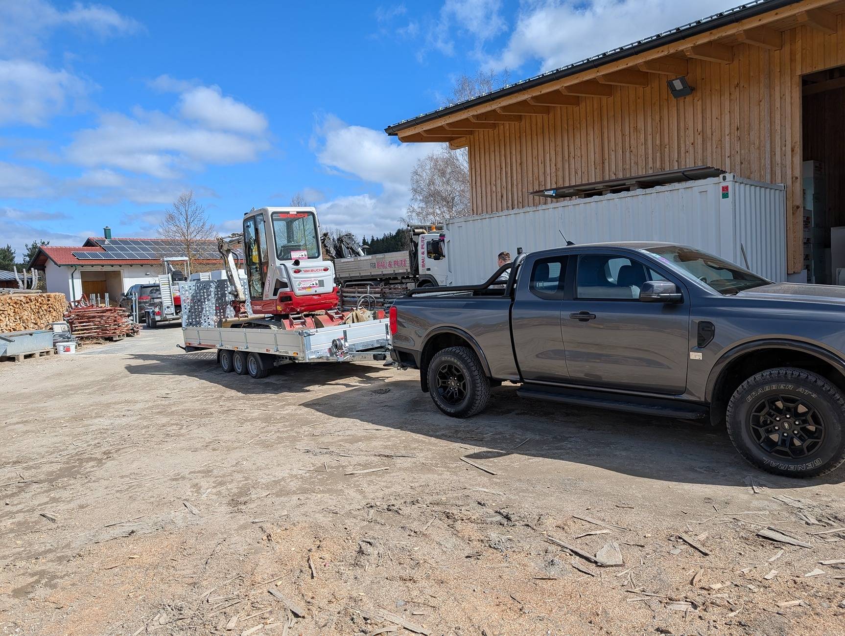

I towed over 7500lbs a couple of times
I would say the car handles it very good but uphill is a struggle with the 2liter diesel

up a boat ramp should be no problem with power
i only have problems keeping speed over 55mph uphill with over 14%gradient

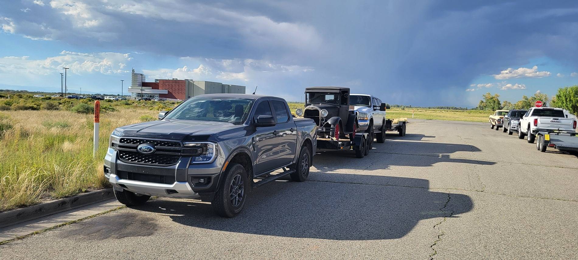

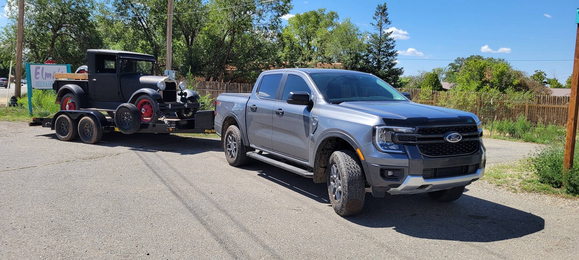

I no longer have my 2.3L '19 Ranger, having upgraded to a '24 RR. About 10% of the 80,000 miles of the '19 was towing typically around 5,500# from WY to Southern Utah. Grades are long (up to 20 miles) and steep with elevations to 8,000'. I live at 7,500'. Use caution, take your time and your 2.3L will do just fine. No overheating concerns. Consider:
- When towing, bigger is better - F-150, F-250 etc., but your Ranger will tow 5,500 just fine.
- A tongue weight scale is a good idea since the boat motor is a lot of weight hanging off the rear.
- Most boat trailers have surge brakes. They work fine but proper maintenance and adjustment for the weight of your boat is a must. Electric brakes are better but conversion is pricy.
- I increased tire pressure 2# in the front and 4# in the rear. If you have sway, more may be necessary.
- Also experimented with tow/haul mode but found drive or sport mode to be just fine.
- Finally ... Anticipate. As George Carlin would say, "Every other driver out their is an idiot." I'll add, expect them to do dumb and unexpected things.
Lots of good advice from others too.
