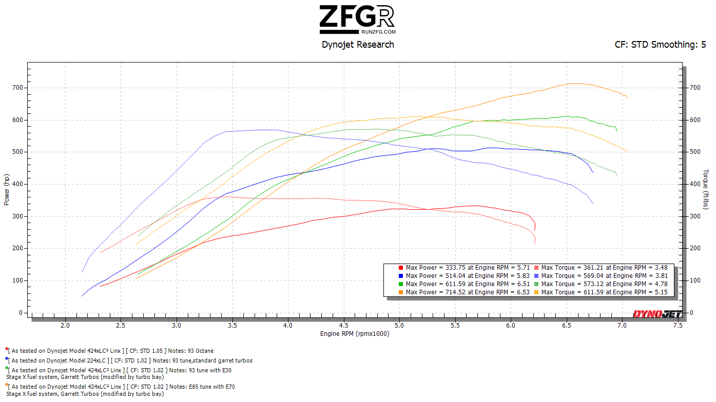

Awesome freakin Video.
I spoke to Nathan on Friday he explained how much testing you guys have all put in to get this going for us little guys. So my question for you @ZFGRACING is considering I only have access to 94 Octane (with 10% ethanol) up here, no E85 which mods do you recommend I go for?
My goal is take this truck as far as I can on 94oct....what should I purchase?

I was literally about to pull the trigger on the Garrett turbos this week too, found them on sale in Canada. But it seems you don't feel they are worth it? I kind of want to do all the mods at once in the spring so I don't have to pull it all apart twice.
I noticed the Aussies are also using bigger turbos as well Garrett G25-585 (48mm), they also go for more injectors it seems rather than upgrading the HPFP

I mean it's still a 30-50hp gain to go to the Garrett turbos and 93 so it's really up to you. CRP is in Canada as well and cold do a bigger wheel, they are just not shipping to the usa.

It looks like you gain a lot of early torque with the turbo upgrade as well, almost to the point a gear reduction might make sense
So there isn't much point in adding a fuel system if i can't get to E85?
Seems im gonna be capped to 500 HP no matter what i do
