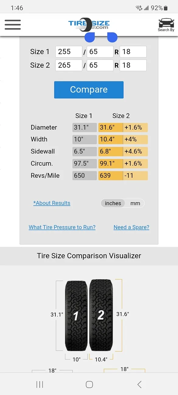

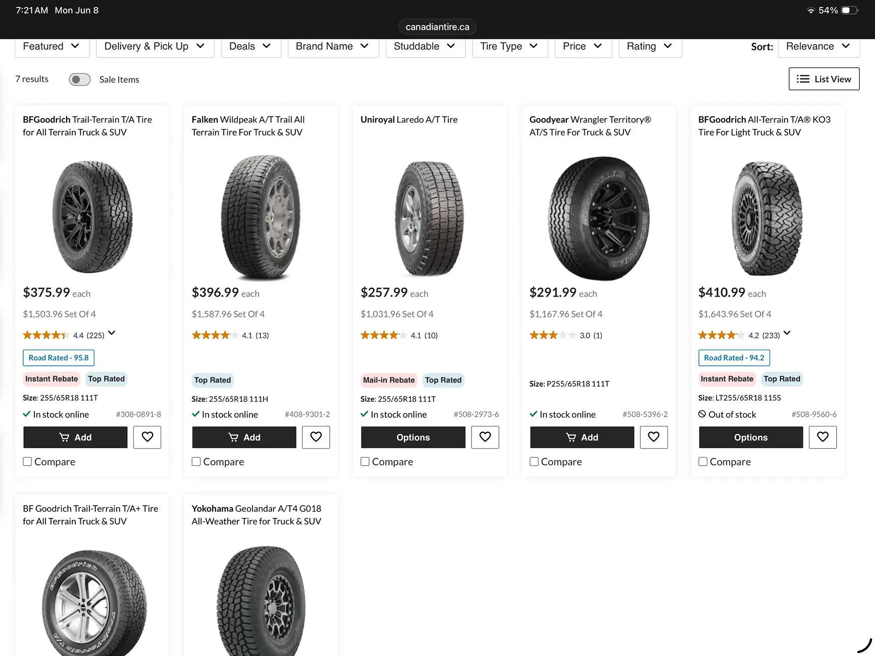

Hi All,
I can't find ANY!!! decent AT tires in the OE size that came on my 2026 Ranger Lariat FX4. The only ones here in Canada are the Goodyear Territory AT that came on it.. The rest listed in this size are all Highway/3 season tires.
I was looking at going with the 265/65/18 instead, which is the next size up in width to allow me a much larger selection of AT tires.
I was specifically looking at the Falken Wildpeak AT4W, or the Toyo Open Country AT3 in the 265/65/18.
Any experience fitting these on the truck? Any rubbing at full lock?
I really don't want to modify suspension (Lift or Level) so was hoping this would be a viable option.
Will the 265/65/18 fit, or is there a better size that will without rubbing or requiring any modification/trimming?
Thank you.

That should fit without any issues since the srock are 255/65/18.
Ford Ranger 265/65/18 - Stock height 2026 Ranger Lariat FX4??? Screenshot_20260521_134610_DuckDuckGo
