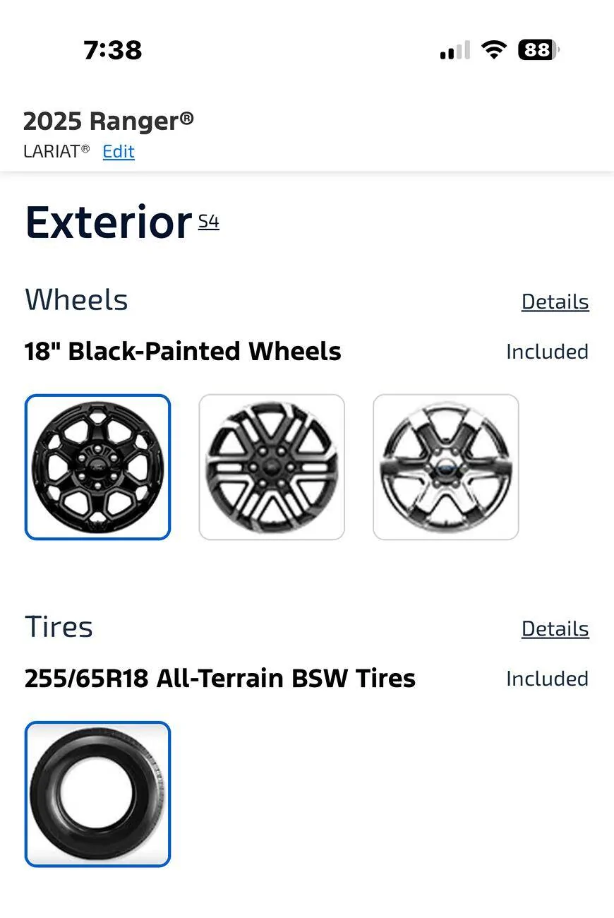

Am I correct in believing this is the tire that will come on my 2025 Ranger Lariat FX4? Thanks!

I know my 2024 Lariat FX4 has the AT/S not sure if they will change them to the AT.
Thanks! Right now my plan is to do an immediate swap to the Falken 255/70R18 A/T4W that Alaska Steve installed.

There’s only one tire choice on the Lariat with the Black Appearance Package for 2025, a 255/65R18 AT BSW

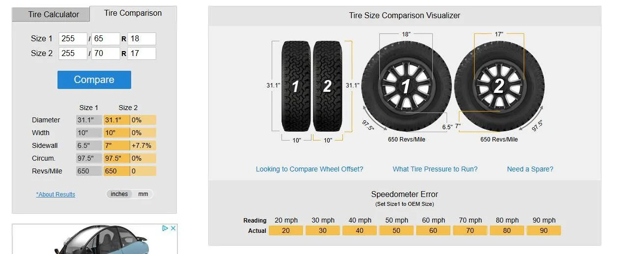

You could probably get away with an LT265/70/r17 on a wheel with a +35mm offset. This tire is half an inch wider than stock and would require either a 20mm spacer or a wheel with the proper offset.

I found this helps if anyone is interested. A 255/70/17 SL tire and wheel is the same diameter as the oddball 255/65/18. Opens up more AT tire options.
