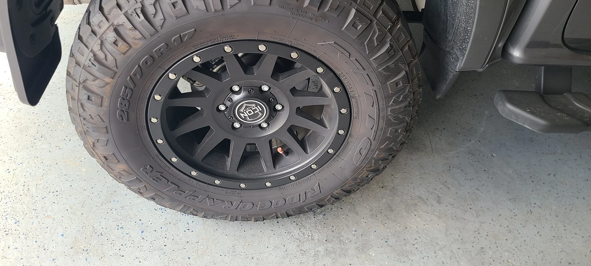

3,576
3,334
Ford Ranger 285/75-17 vs 285/70-17: Will it fit with 1.5" lift up front? 20260314_131333
This is his wheel and tire. Its the back wheel but he daily drives his truck and no rubbing.

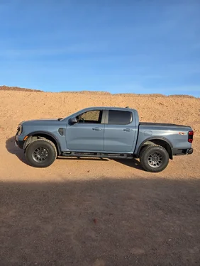

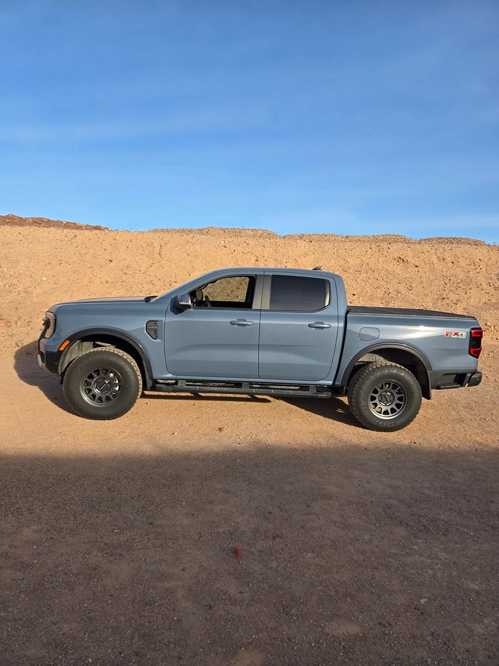

NevadaBob
Jul 18, 2025
103
100
Nevada
2024 Ranger Lariat
83486[/ATTACH] member: 12718"]
Thanks all!
Yeah, I’ll stick with the 70 series tires. Thanks for the info!
The wheels I’ll use are a 35 offset, so we’ll see how that goes as far as any rubbing.
I'll update and post pics as soon as I get everything in gear.
You should be fine with +35, 1.5" level, and 285/70 17. That's my exact setup.
