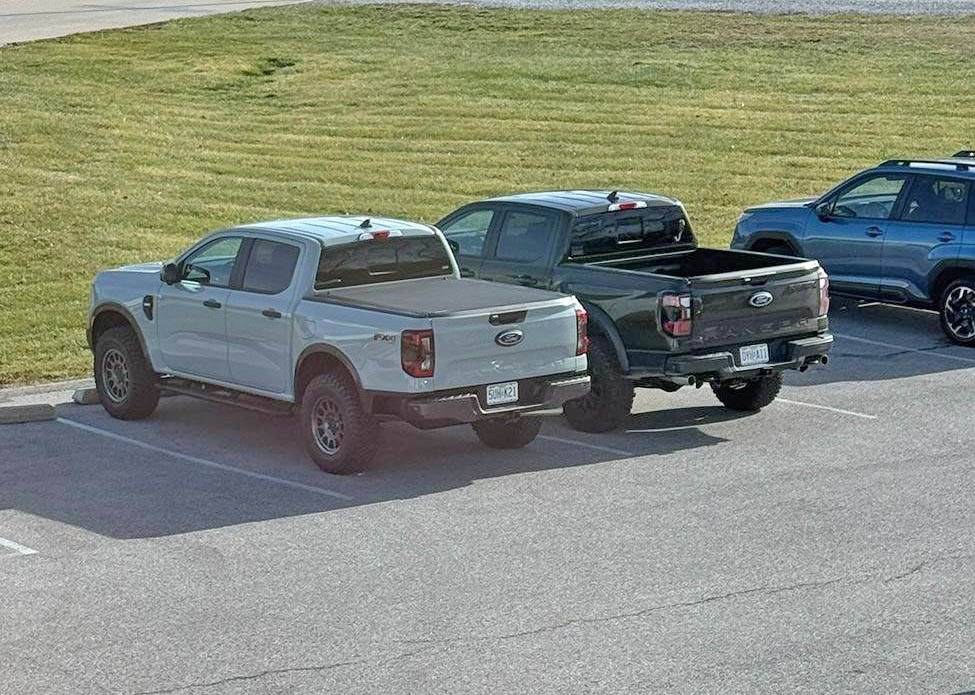

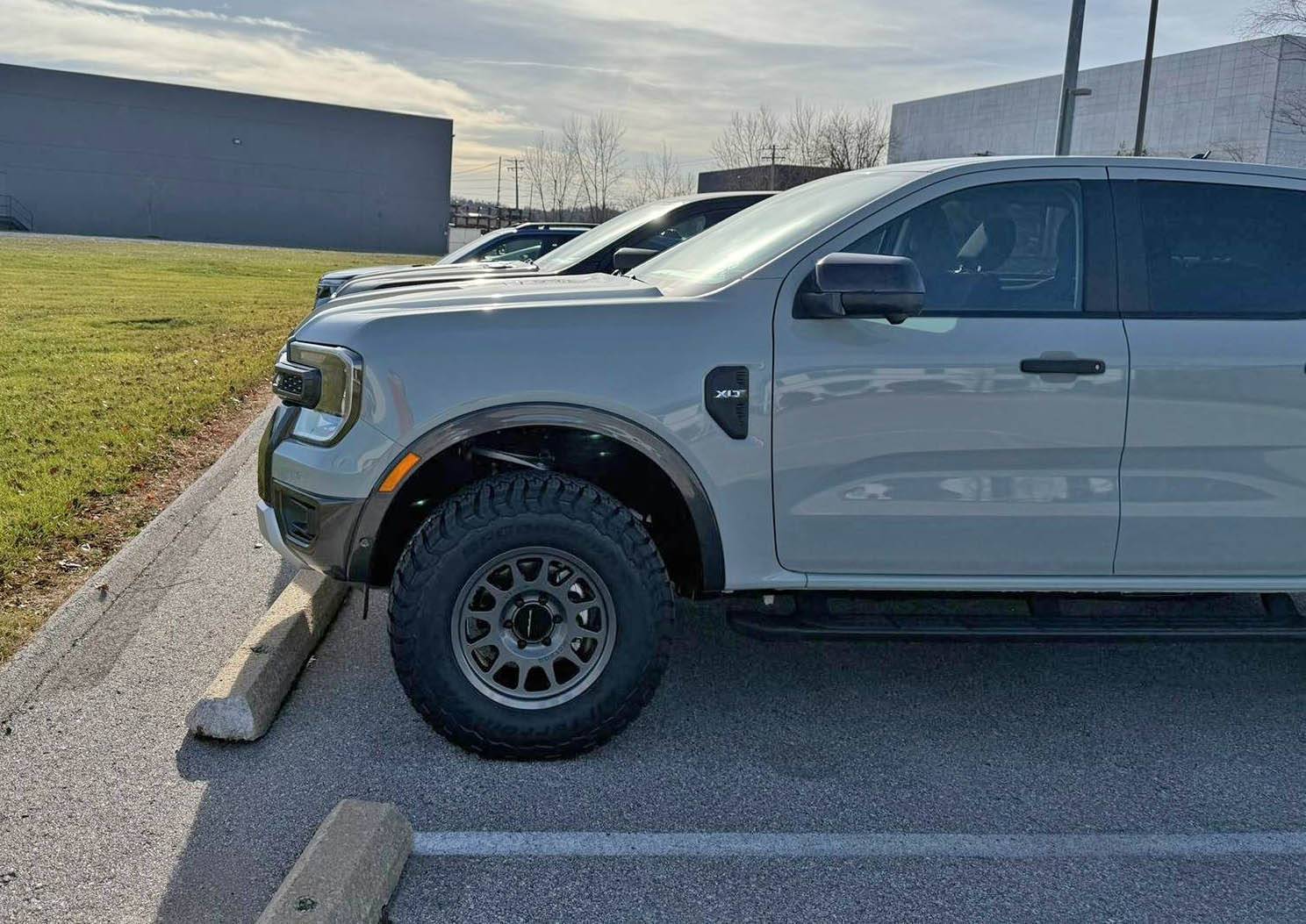

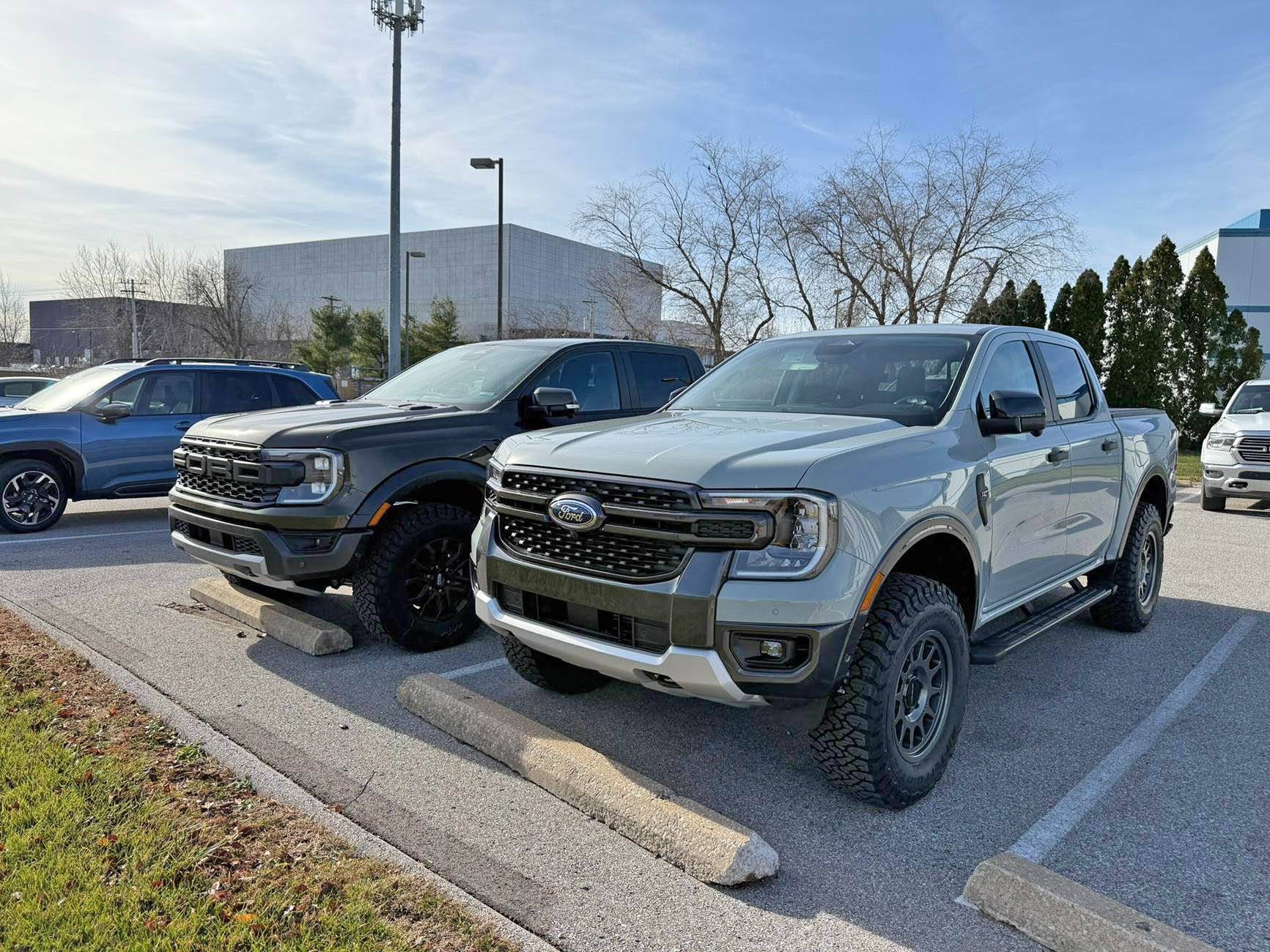

Wasn't happy with the stock tires and look with my Ranger so decided to go ahead and upgrade.
Went with the Method 703 wheels in titanium and the new BFG K03. All ordered through tirerack.com mounted and balanced.
From the great information found on this forum I knew I needed a front lift. For that I used fordrangerlifts.com. Robert from fordrangerlifts.com responded quickly to any questions I had and delivered a quality kit. I followed the instructions he included, and after some grunting and purchase of a new big socket, it all went together well. https://fordrangerlifts.com/shop/ols/products/xn-2-2024-ford-ranger-level-lift-2wd-4wd-zb5w-c94abe
Really happy with the look and color of the Method wheels. I liked the look of the oe FX4 wheels, but needed a bit more offset to fit the 285 tires. These look better than expected in the titanium color.

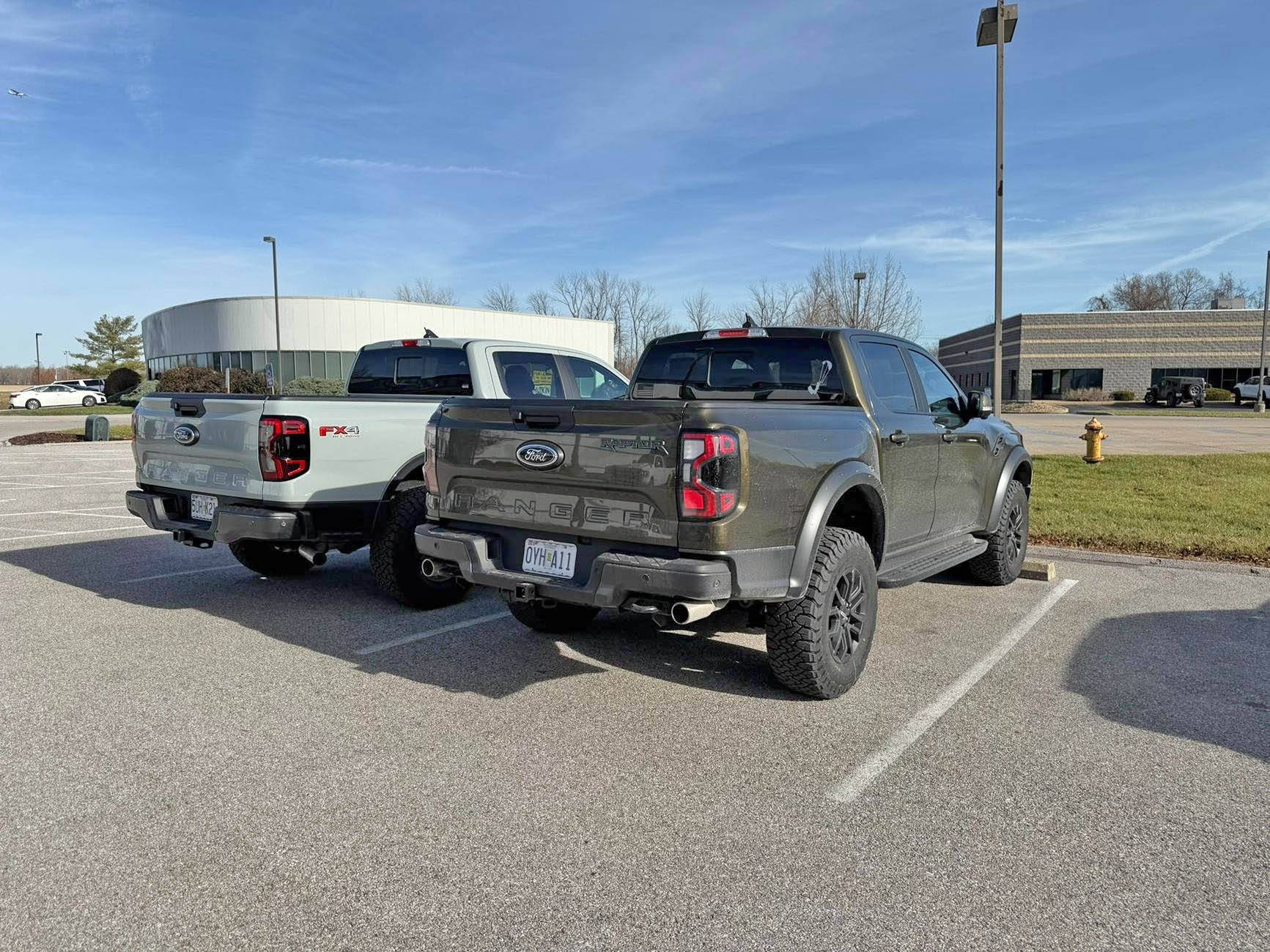

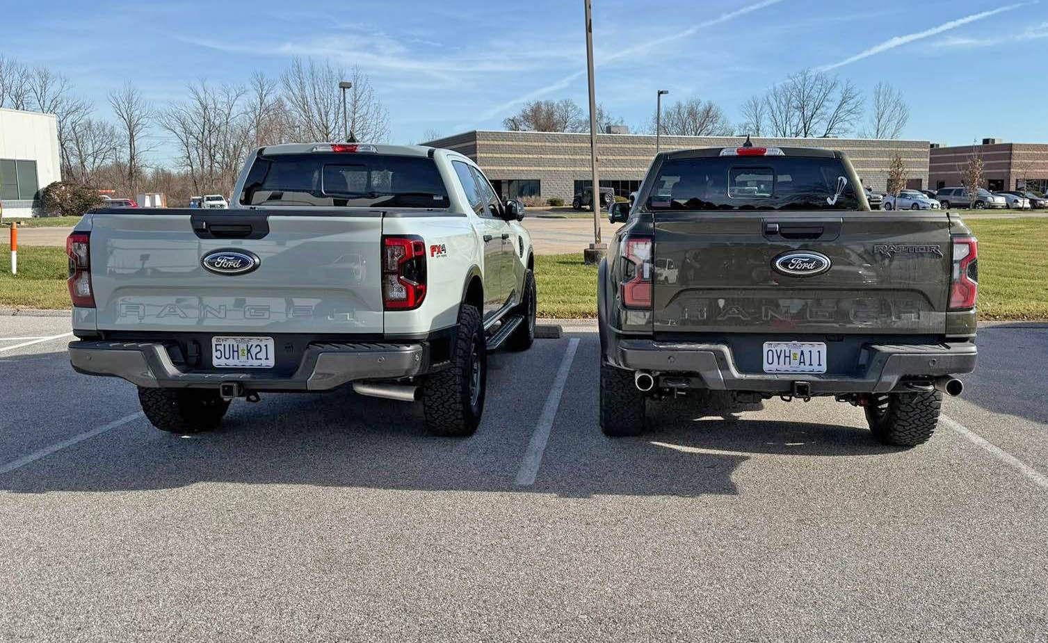

I saw a Raptor Ranger at my work and took the opportunity to get some side by sides pics to show the difference.
Also included a screenshot of my TireRack order so you can get a cost idea and part numbers.
Your truck looks very good, great wheel & tire combo. Waiting on my truck to arrive and if I didn’t already pre purchase new wheels I’d have gone with the Methods you have.

Truck looks good. In your opinion, would the 3" kit have been better than the 2" with the 33's?

A 2" lift is ideal for leveling the truck (IMO), providing a great stance without overextending the factory suspension components beyond their intended design. If you’re looking for more than 2"–2.5" of lift, a full suspension lift for both the front and rear would be more ideal—though, to my knowledge, such an option isn't currently available.

That's just a bigger spacer than what I got.
A full suspension lift changes actual suspension components to avoid over extending the wrong parts. Often includes coilovers/struts and control arms.

Truck looks awesome! I have this same truck (good choice). Looking to run the 2" lvl and same size tires as you but I'm wanting the Method 305 wheels and they only come in +25. Think there will be much difference in those? I don't mind some poke, but my concerns are rubbing and possibly slinging rock/gunk (minimal off-roading: camping, kayaking, dirt roads, etc.). Would Ford's little "splash guards" help?

what offset are your method703, are the +35. I have some wheels ordered with +25 and after looking at yours I really like the stance of yours. Also are your gunmetal or black

Based on his part number he originally played on this thread (page 1) they are the ‘gloss titanium grey’ as below. With your wheel would be .394mm or approximately 5/32” which is fairly minimal. Just a tad more poke.
Method MR703 17x8.5 +35
MR70378560835
