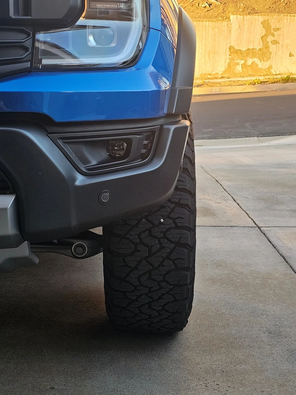

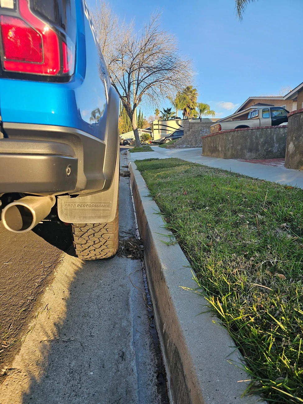

Ford Ranger Method 703 Wheels Installed (17x8.5" Matte Black) 11
Ford Ranger Method 703 Wheels Installed (17x8.5" Matte Black) 22
Ford Ranger Method 703 Wheels Installed (17x8.5" Matte Black) 33
Ford Ranger Method 703 Wheels Installed (17x8.5" Matte Black) 44

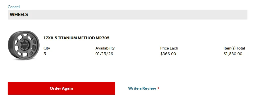

I was just curious noticeable it is on steering effort and feedback compared to +55, both off-road and on-road. I'm keeping stock tire size and suspension as well. Now if only Method would ship my darn wheels instead of changing the date on a daily basis...:
Ford Ranger Method 703 Wheels Installed (17x8.5" Matte Black) 1768399487790-47

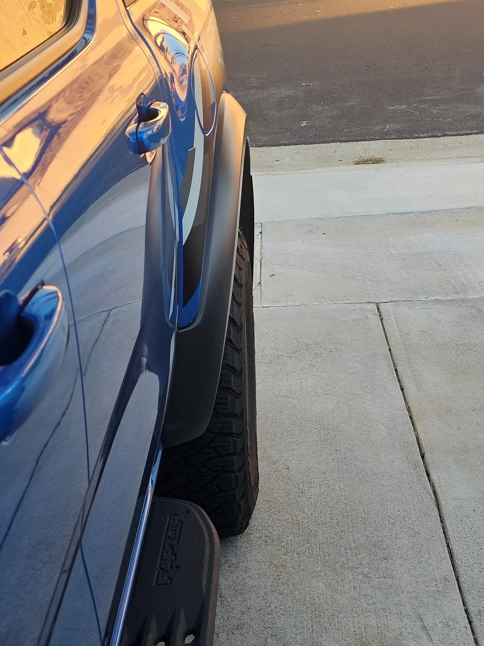

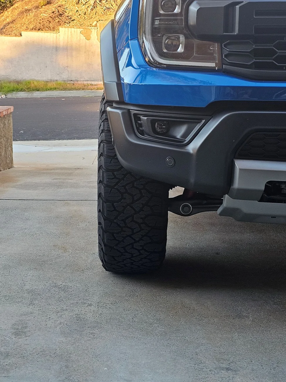

I love the stance at +35mm, it's just barely inside the fender, some like a tad of poke, which does look good, but I'm more performance minded than looks and +35mm brings it out enough to add in my opinion an "aggressive factory-like" appearance without being problematic in affecting scrub radius significantly.

Meet too, waited several months for them to even be listed as back in stock on Method's website, then ordered via Tire Rack since it's free shipping and then got sucked into more of the waiting game. But I'll be patient and continue to wait.

Thanks for the pics, gives us a really good idea of how the offset affects "poke", looks like the side wall is just about flush with the OE mud-flaps, which is about what I was predicting based on other's photos of 703's, so I think my upgrade from OE flaps to Rokblokz XL's was a smart move with the added track width. I'll post some photos on this thread after the 705's finally ship.

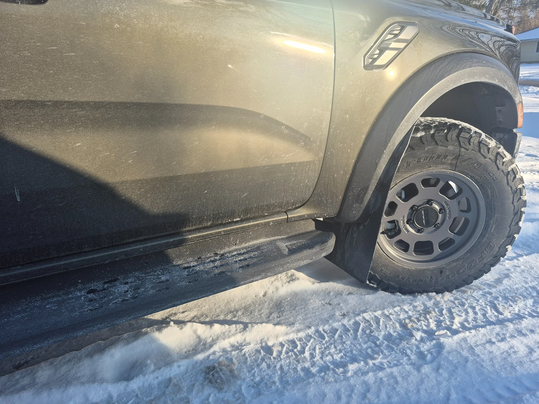

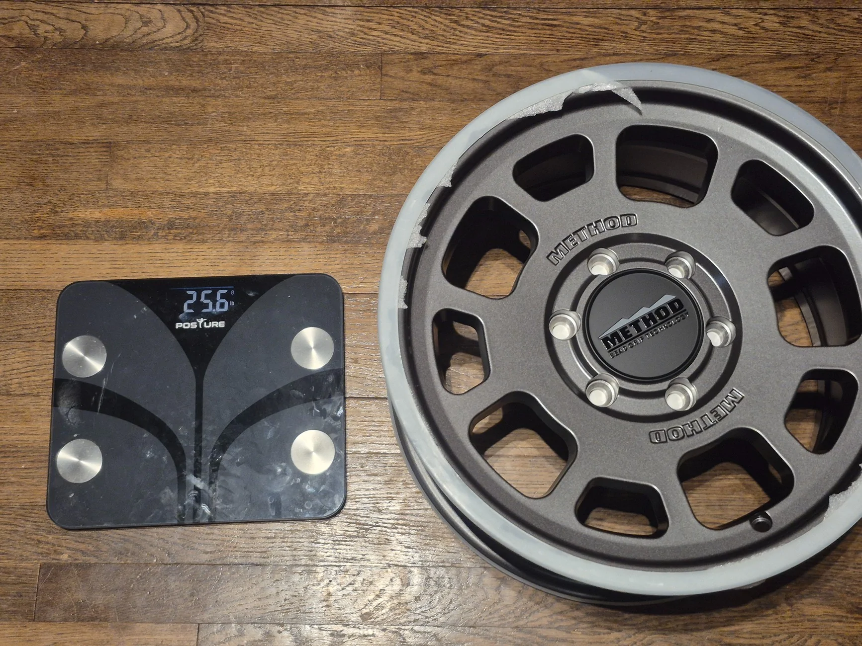

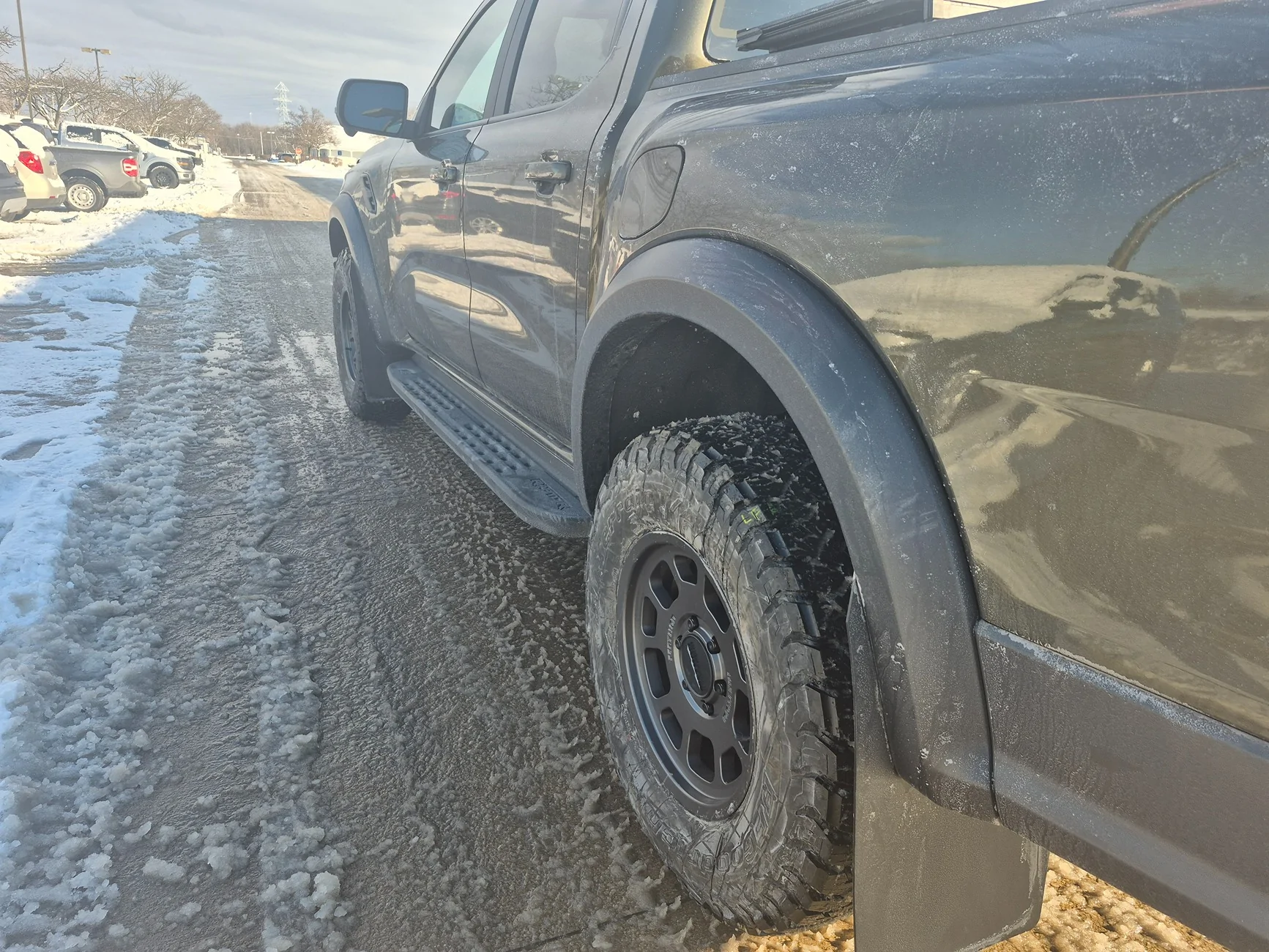

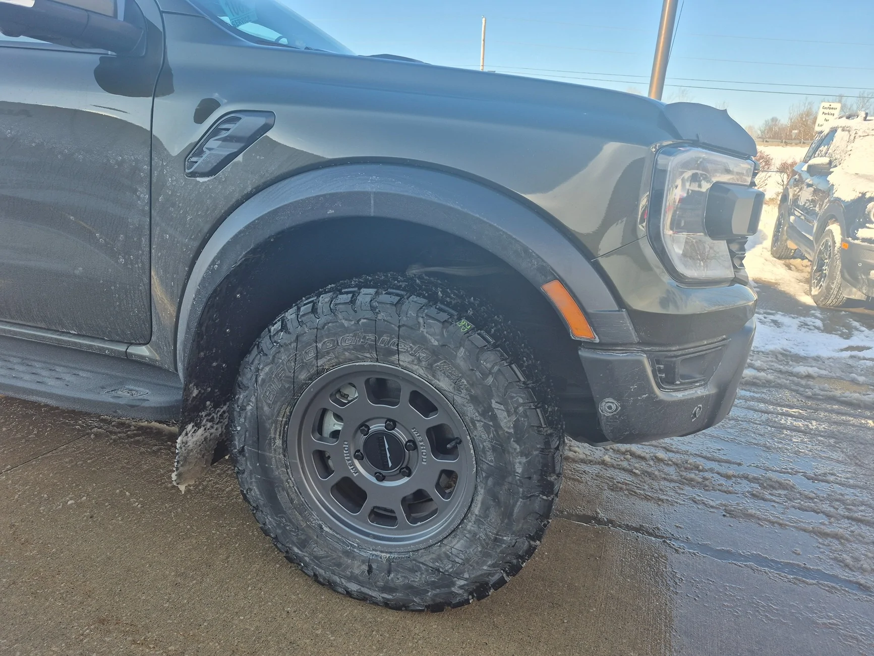

Sorry for the dirty pics :giggle:, I tried to keep it SG-13. First truck on this forum with 705's in 17x8.5 ET+35. Stock 285/70R17 KO3's, stock suspension. Pro Cal tuned with Rokblockz XL mudflaps.
Ford Ranger Method 703 Wheels Installed (17x8.5" Matte Black) 20260117_150737
Ford Ranger Method 703 Wheels Installed (17x8.5" Matte Black) 20260117_150726
Ford Ranger Method 703 Wheels Installed (17x8.5" Matte Black) 20260117_150705
Ford Ranger Method 703 Wheels Installed (17x8.5" Matte Black) 20260117_161538
Ford Ranger Method 703 Wheels Installed (17x8.5" Matte Black) 20260116_194947
