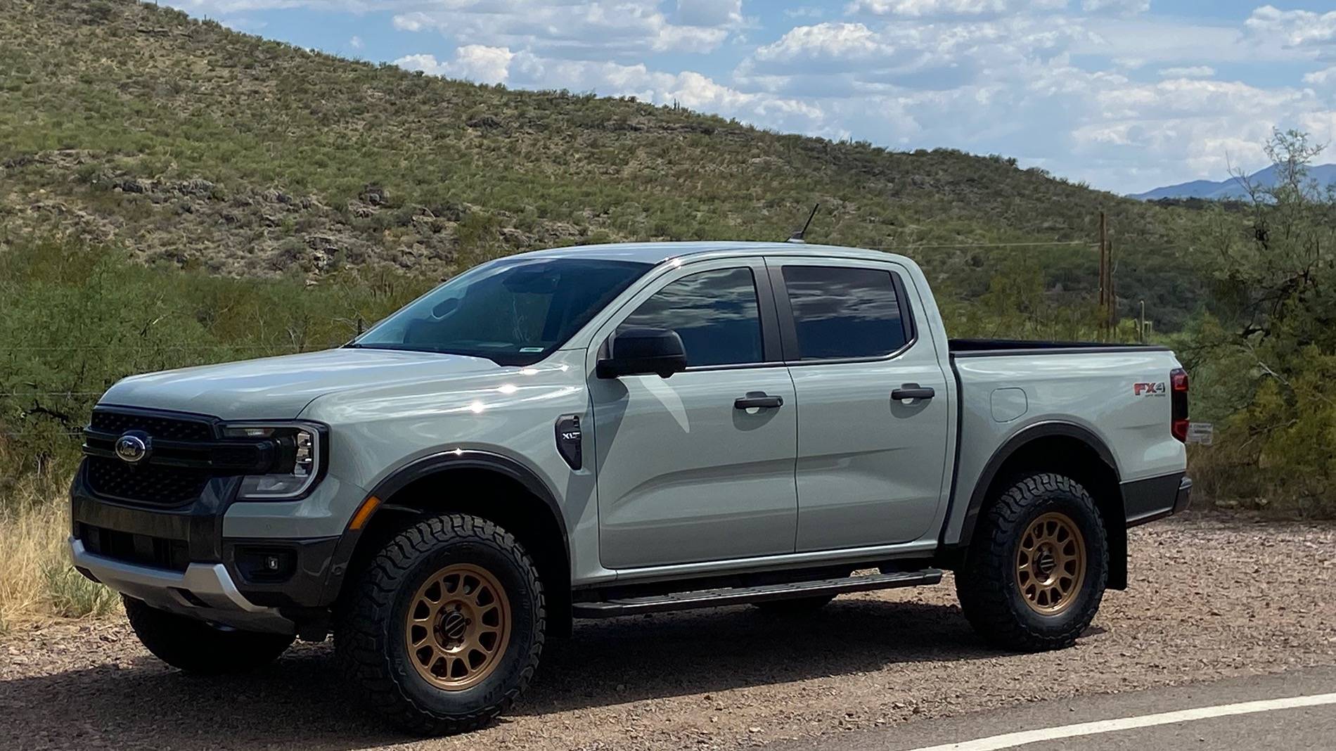

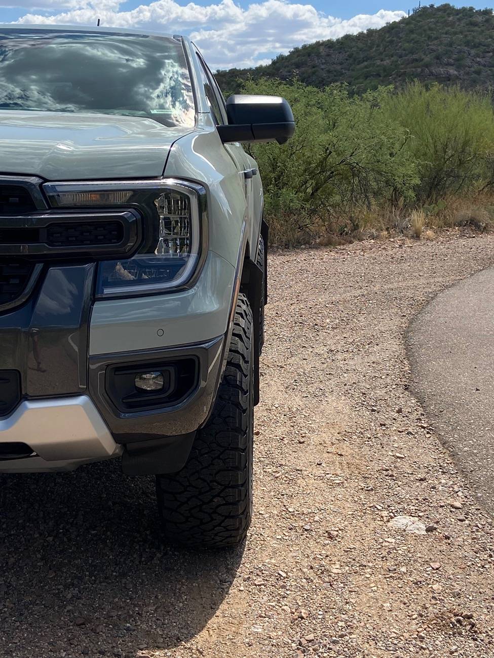

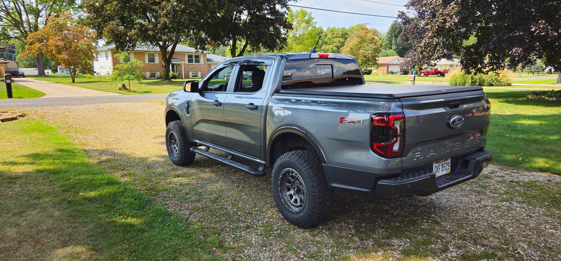

Here’s the current state of my Ranger XLT with FX4 package:
Method 703 17x8.5 +35 offset Bronco Ford Performance Wheels (ordered through dealership)(black lug nuts)
BFGoodrich KO3 285/70r17 tires

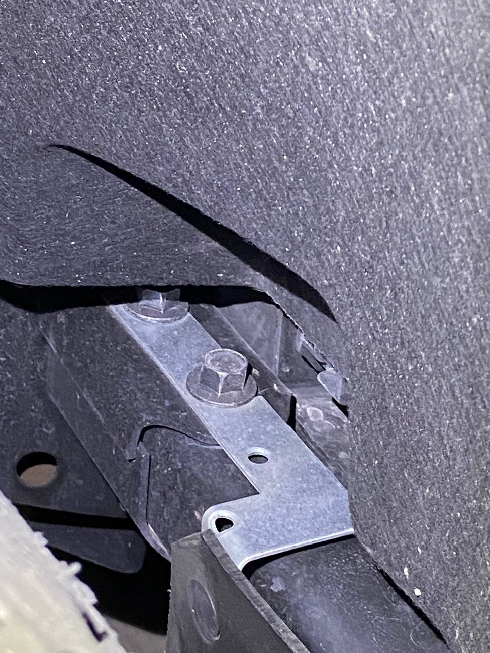

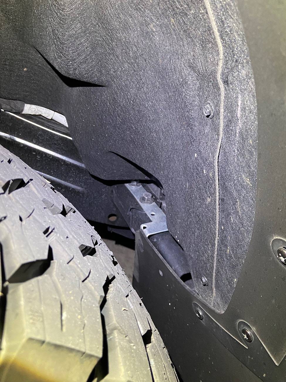

Rallyflapz extended arch mudflaps (ordered these from the UK and had to cut them down a bit as they were just too wide for the truck, and also had to fabricate a bit of a bracket for the fronts, just bent one of the arms of an L-shaped bracket and bolted it down under the crash bar bolts *pictures)

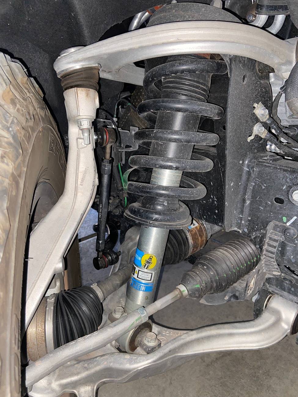

Bilstein 5100 suspension +2ā€ lift in the front; fronts coilovers are actually made for the Bronco and fit great, the rear shock absorbers are made for the 5G Ranger.
Gas mileage has dropped from around 23 mpg to about 20-21 mpg for mixed highway, city driving.
*FORScan has released update 2.3.61 which has allowed me to write changes to the BdyCM. The ideal tire circumference for this tire size is 2612mm, but I’ve seen that you want to account for some squish in the tire to get the speedometer just right. The posts I saw said to multiply the ideal circumference by 0.96 to get the ā€˜real world’ circumference which came out to 2507mm. I entered 2500mm (cuz I like the round number better) for the new circumference and my speedometer is reading 75mph at 75mph in the OnX GPS app, pretty much perfect!

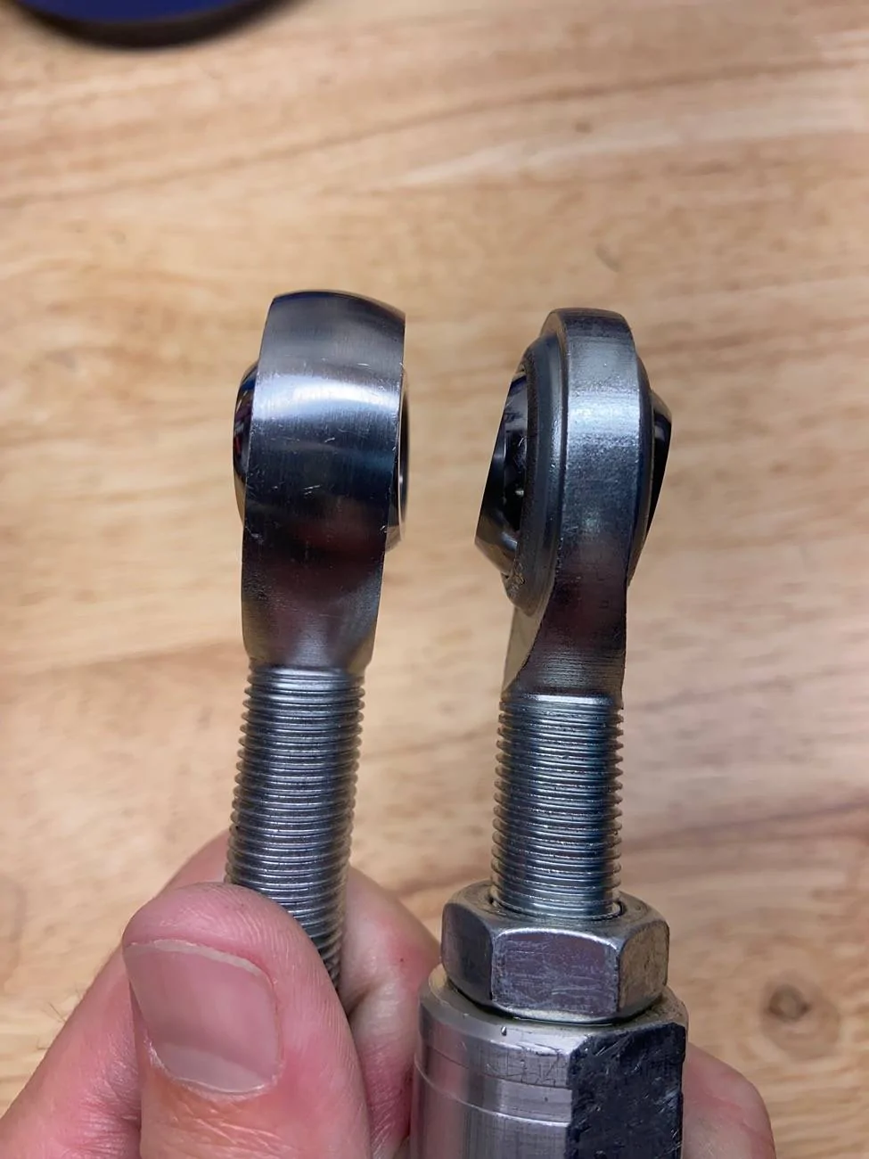

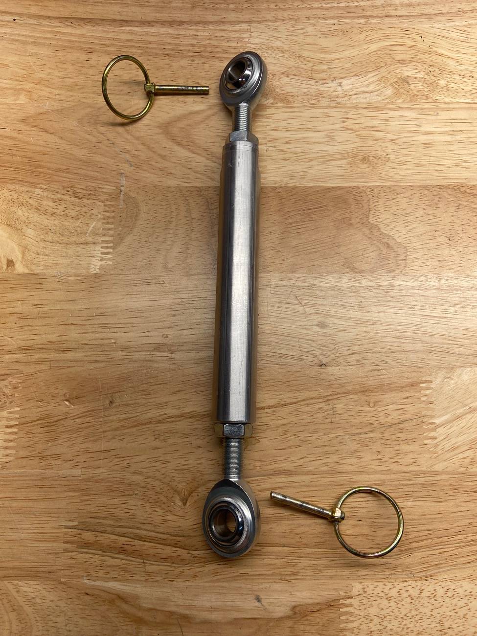

Here’s the end link solution I came up with:
I bought the link kit from Ruffstuff and then I also bought their Sway Bar Quick Disconnect Pin Kit (not pictured above). The pins just bolt into the knuckle and the sway bar and then the Heim joint rod ends slide onto the pins and are captured by the smaller retaining pins.
The rod ends that come with kit are unfortunately too large to allow enough motion in the rod end as it was made for a Jeep with a solid axle, not an IFS truck. I bought these Left Hand Rod Ends and these Right Hand Rod Ends from Speedway Motors. They’re just a bit narrower in the body and allow the rod ends to articulate enough for the IFS.
They seem to be working pretty well, and they are removable fairly easily, so I’m satisfied with them for now. The narrower rod end spherical bearings are pretty loose, so they might be a bit creaky after a few months, but we’ll see.

Here ya go! I couldn’t get the removable sway bar endlinks to stay quiet and it just wasn’t worth it over the clunkiness to have disconnecting links. So I swapped in some universal Godspeed 230-280mm adjustable sway bar end links. Definitely loctite the lock nuts on or they will back off.

It looked like about a quarter inch between notches. Strut mounts at about the halfway point on the control arm, so I'd say the 2nd or 3rd notch from the bottom would get you to 2.5". Mine settled in around 1.8" or so.
I'm pretty happy with them, I would really like to put 6112s on the front but I'd also like for them to actually design a kit for the '24+ rangers specifically first. Kind frustrated nobody has even bothered except dobinson.
Rears are just the 5100s from the previous gen ranger since the backend didn't change much except where they mount on the frame and axle. 5160s I'm told are just 5100s with a reservoir, apparently no difference in ride quality, just more oil.
These are the swaybar endlinks: Godspeed Endlinks. I had to replace the nuts at both ends with NyLock nuts + Loctite to keep them from working themselves loose, but they haven't budged in over a year now. The endlinks themselves seem super sturdy, the ball joints also seem like quality units to me.

Yeah sway bar is just a geometry thing. The distance between mounting surfaces gets smaller with lift on this front suspension design. Bronco sway bar end links will NOT work on the rangers as they have a different mounting location (lower control arm vs. knuckle)
